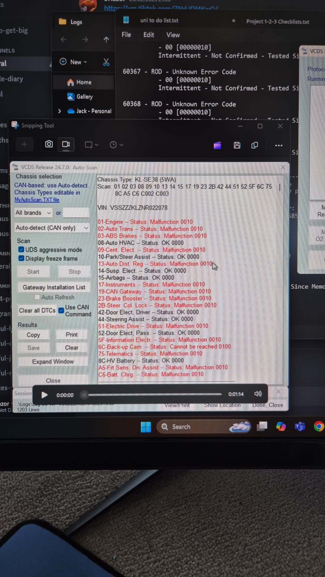

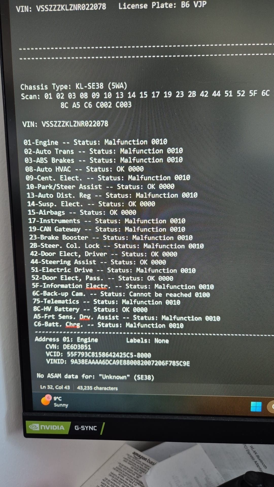

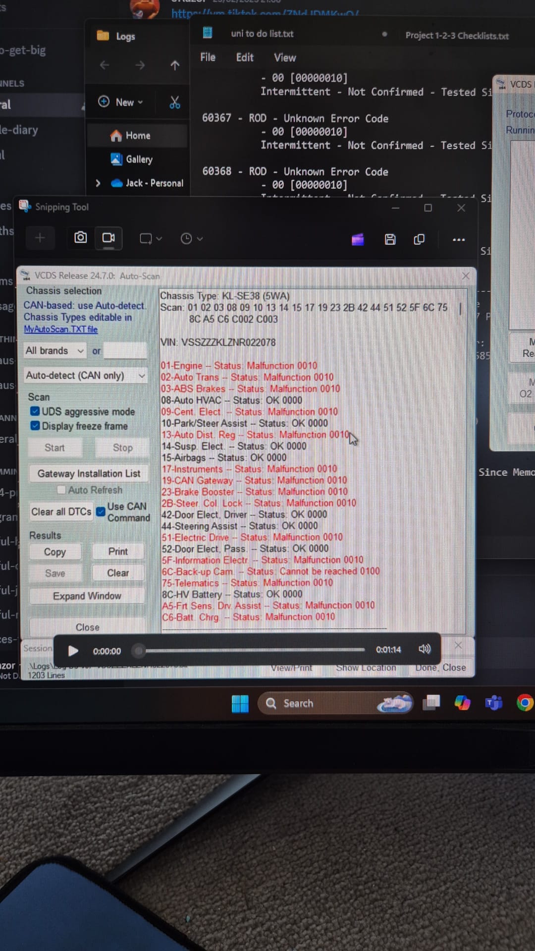

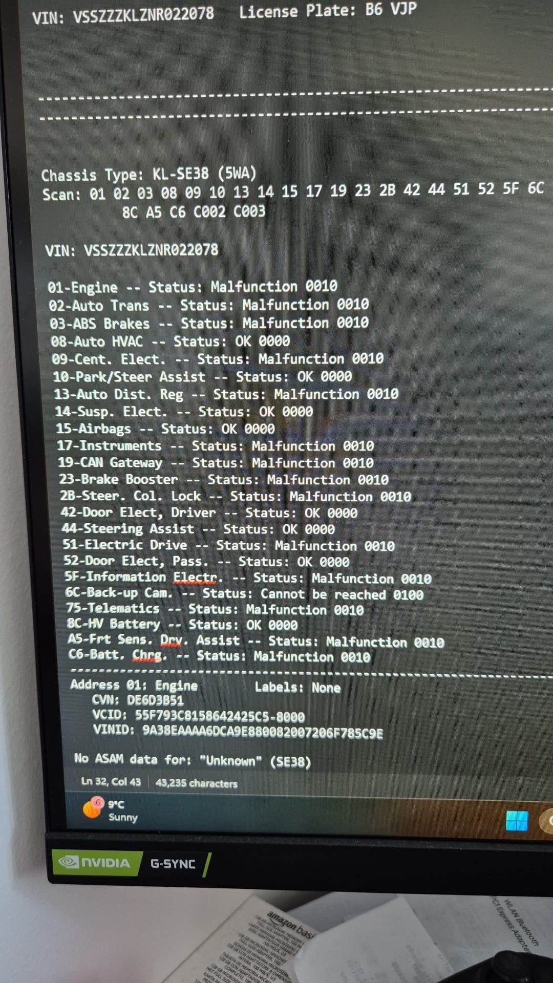

I have since changed some settings on the battery options and drove it 10 miles and no fault but when running my own code checker through it, nothing. Does anyone have any suggestions to my 20k hunk of scrap mental other than to be ripped off by the garage who insist they didn't come across anything in October.

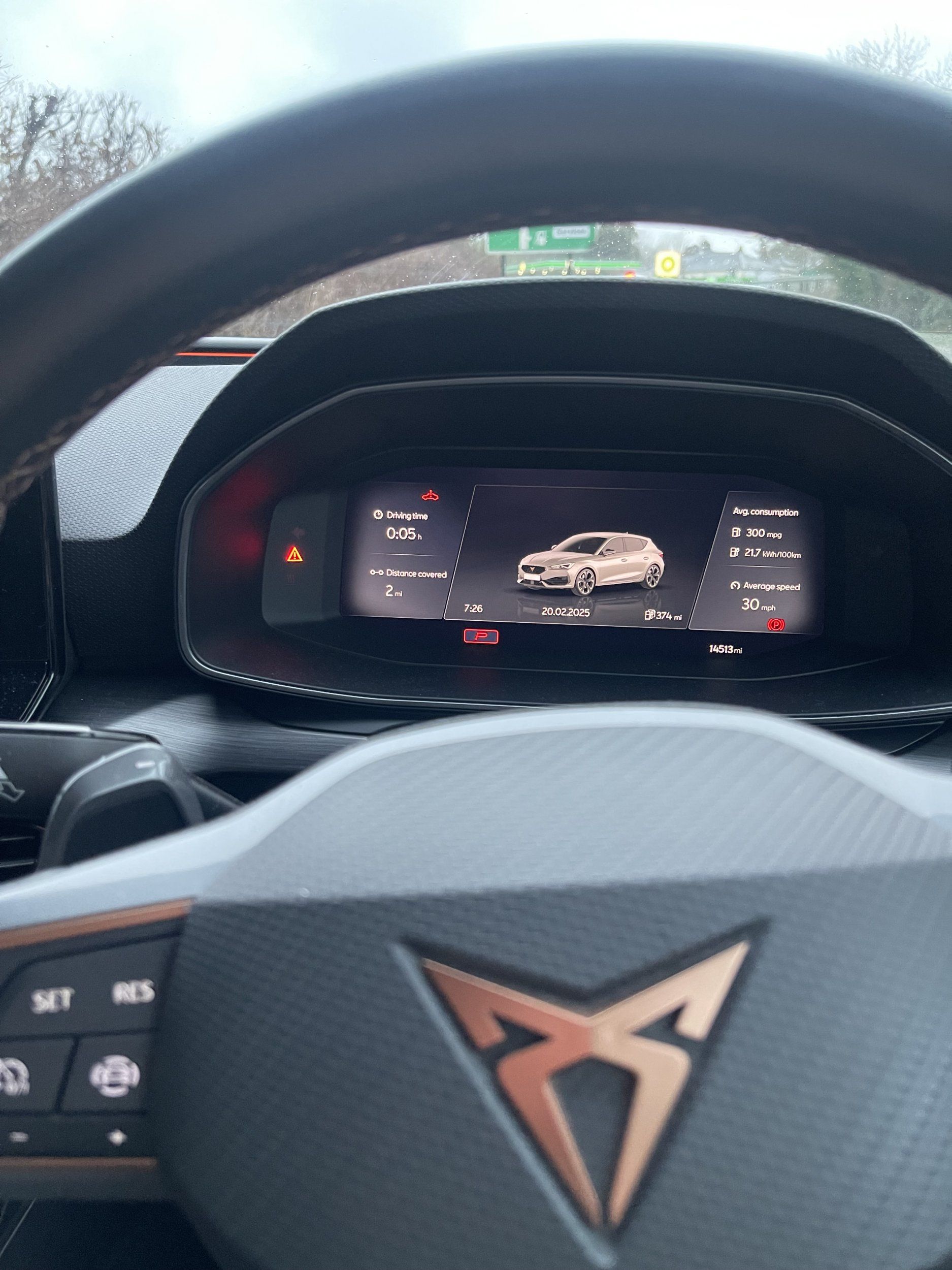

Attached photo of my dash, with said warning light, nothing else since last Thursday
