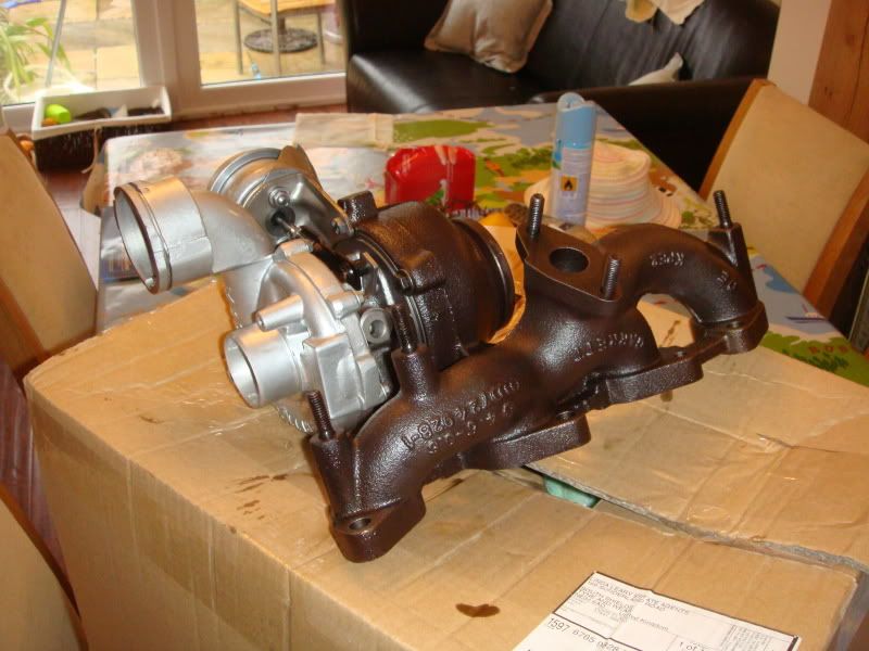

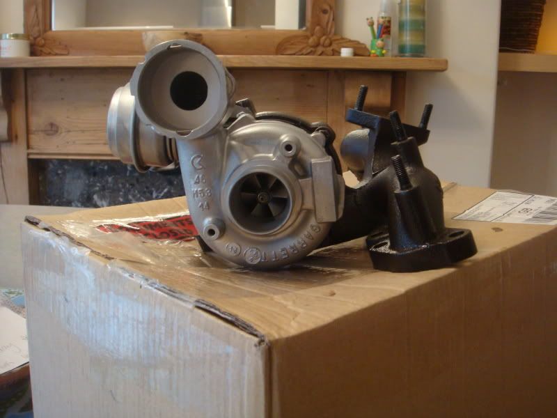

slippers
this is the recon job i got from turbo center today
