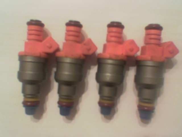

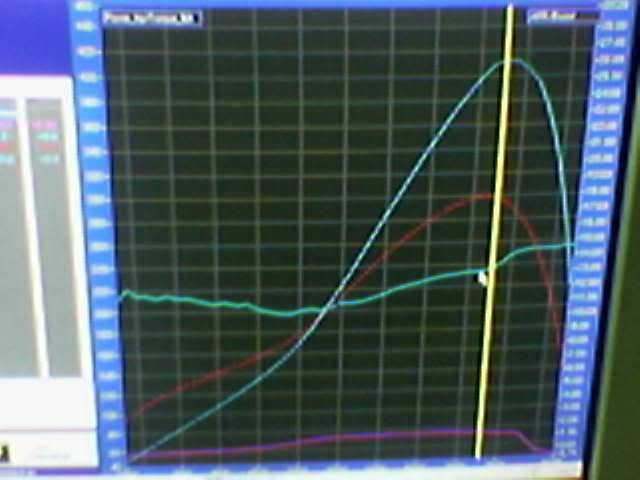

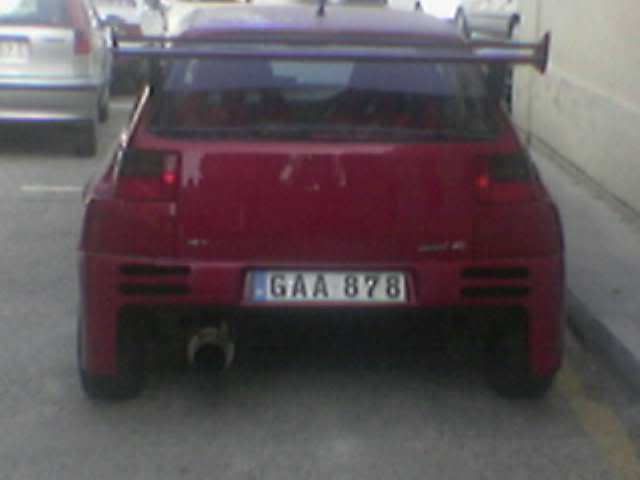

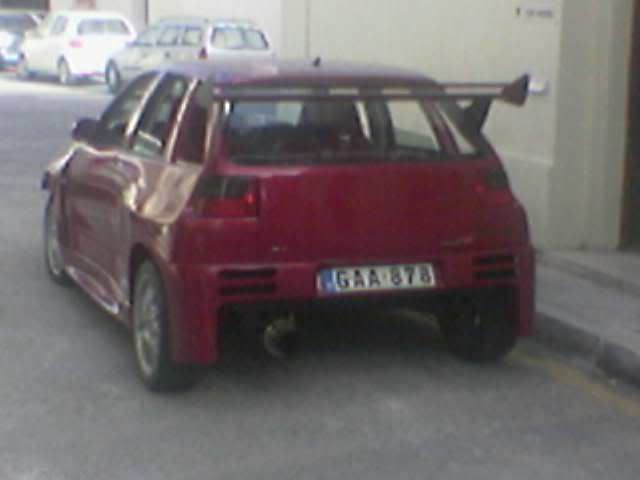

Finally I recieved my new 1300cc injectors, which together with my 2 x 255lph Holley fuel pumps, will allow me to reach my 600bhp target at high boost levels. I was currently doing 420bhp @just 16psi, but I was on the limit of injector duty-I was using 880cc with 95% duty cycle. Now we estimate to rum 28-30psi boost which will take us up high on figures, and hopefully lower the seconds on the time slip !!
http://i143.photobucket.com/albums/r149/ibiza600/420bhp16psisofar.jpg
http://i143.photobucket.com/albums/r149/ibiza600/Image794.jpg
http://i143.photobucket.com/albums/r149/ibiza600/mybaby.jpg
ibiza600
I just wish to beat an Mitsu Evo IV which is running 10.2's at the moment, all the others such as cossies etc are history now ! I have a pair of 26" M&H cheaters to try and launch well, since mine is a front wheeler so far.
