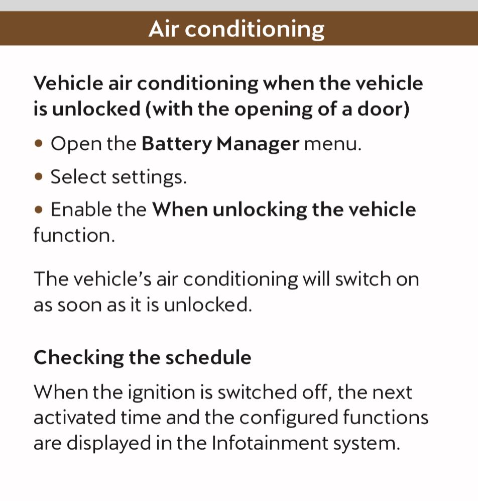

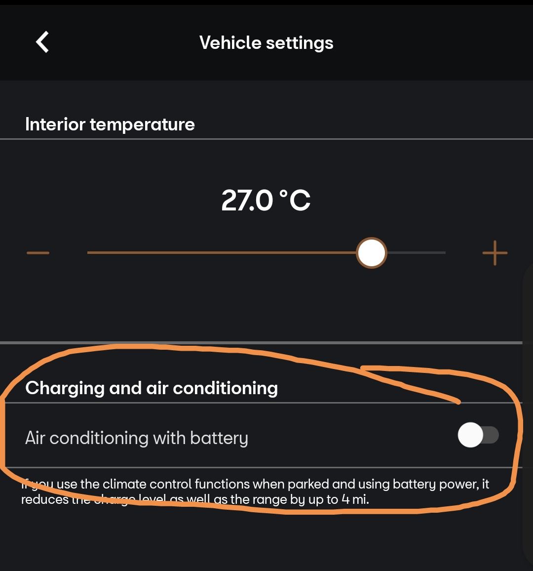

If anyone else is looking, it's a setting in the app

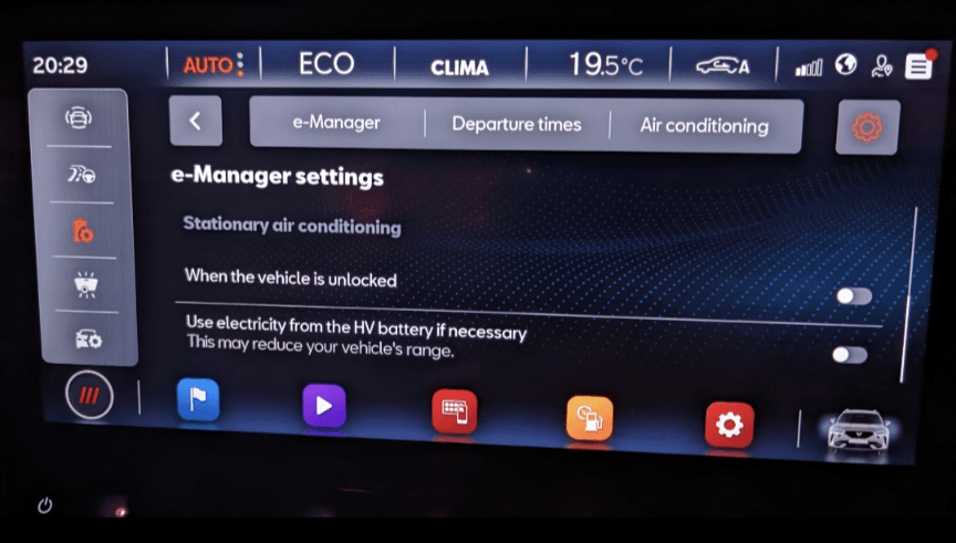

Yep, randomly it is in the battery manager, not the driver profile or climate options... Of all the bizzare places to put it. 🤷‍♂️

The answer to the automatic switching on of the AC when the car is unlocked is above.
Apr 23, 2024
Apologies Zak. I thought it was still turning on automatically after ignition but it's not. Before I changed the settings as suggested above, it did occasionally not turn on at unlock (I've no idea why) but it would then turn on after ignition and I thought it was still doing that. But it seems to be doing what it's supposed to now! Thanks for the thread.
