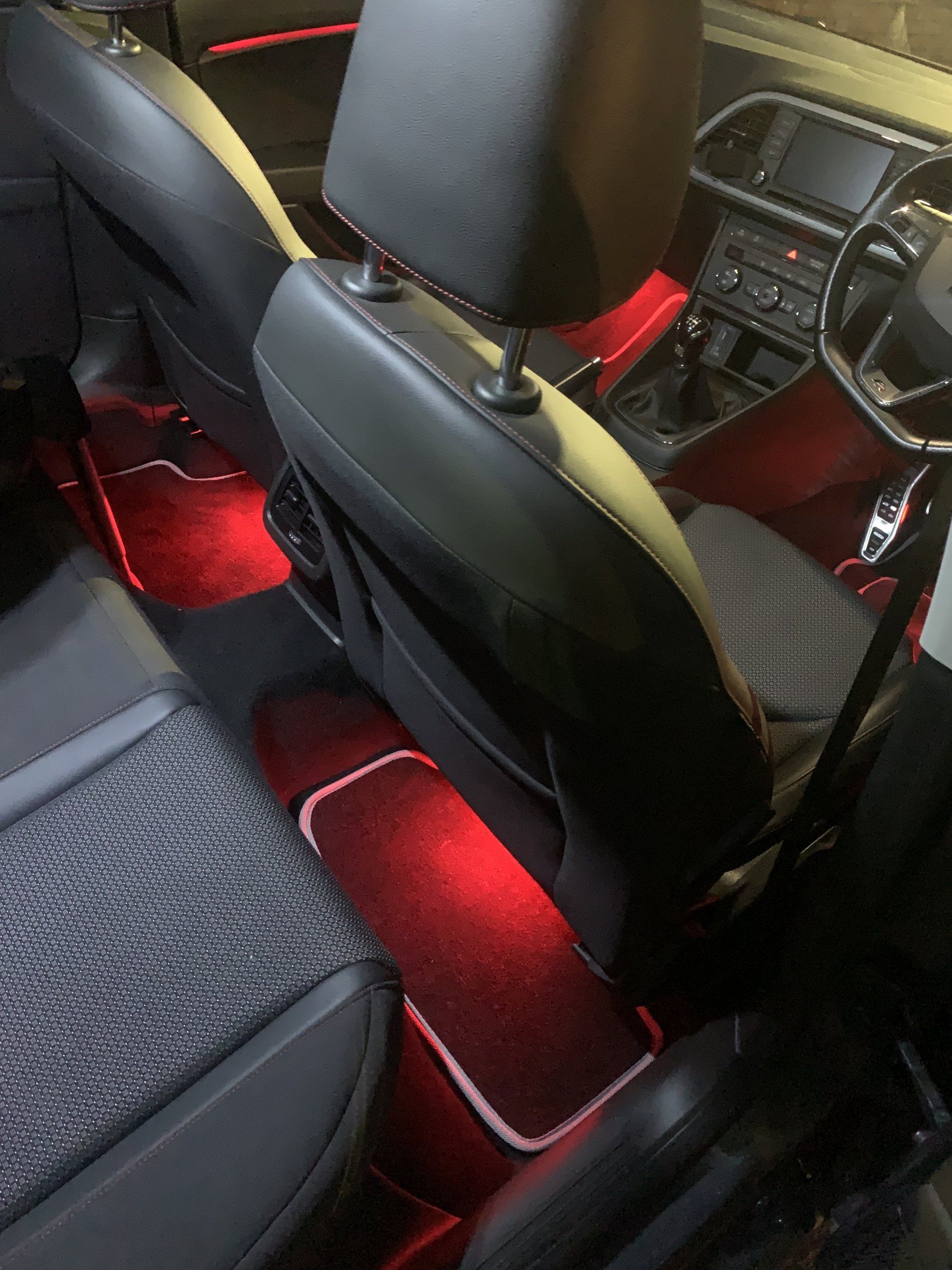

I finally got around to finishing this job. I haven’t had chance to drive it in the dark yet, I suspect the brightness setting may need turning down a bit, but very happy with the results. Thanks all for the links and help, much appreciated 👍
