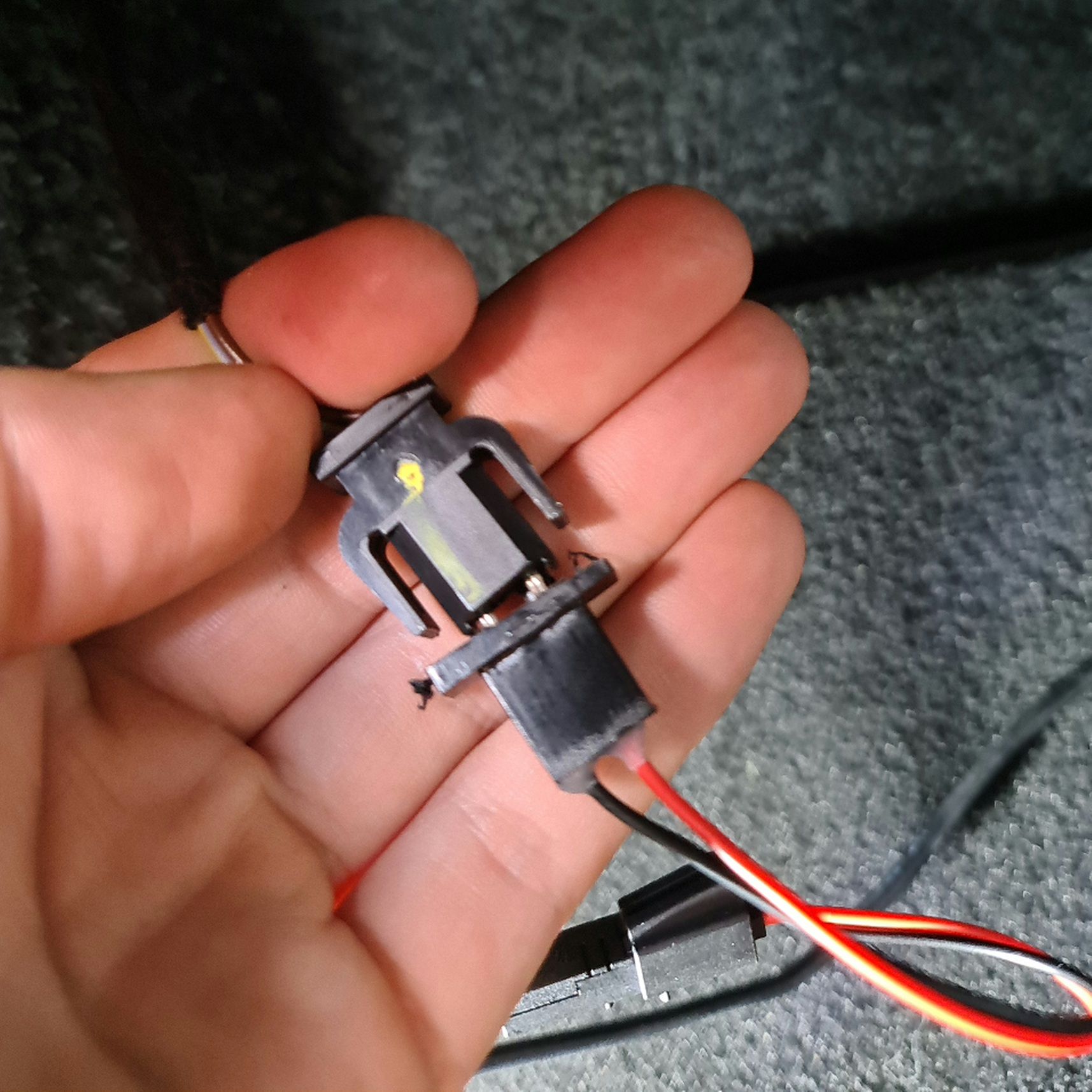

When I purchased the LED footwell lights for the front I received an adaptor cable. I cut the plastic around the plug and it fits straight into the bulb and harness. No cutting/splicing of factory wiring.

I've just installed some on my 2018 FR. I just cut the connector off and spliced into original loom behind each original light. Now just waiting for some red LEDs to match the front.
Did you get the red leds yet? Looking good? Do you have a link to them. I’ve found some adapters for the wiring loom to fit the cars original connections, going to fit them soon
