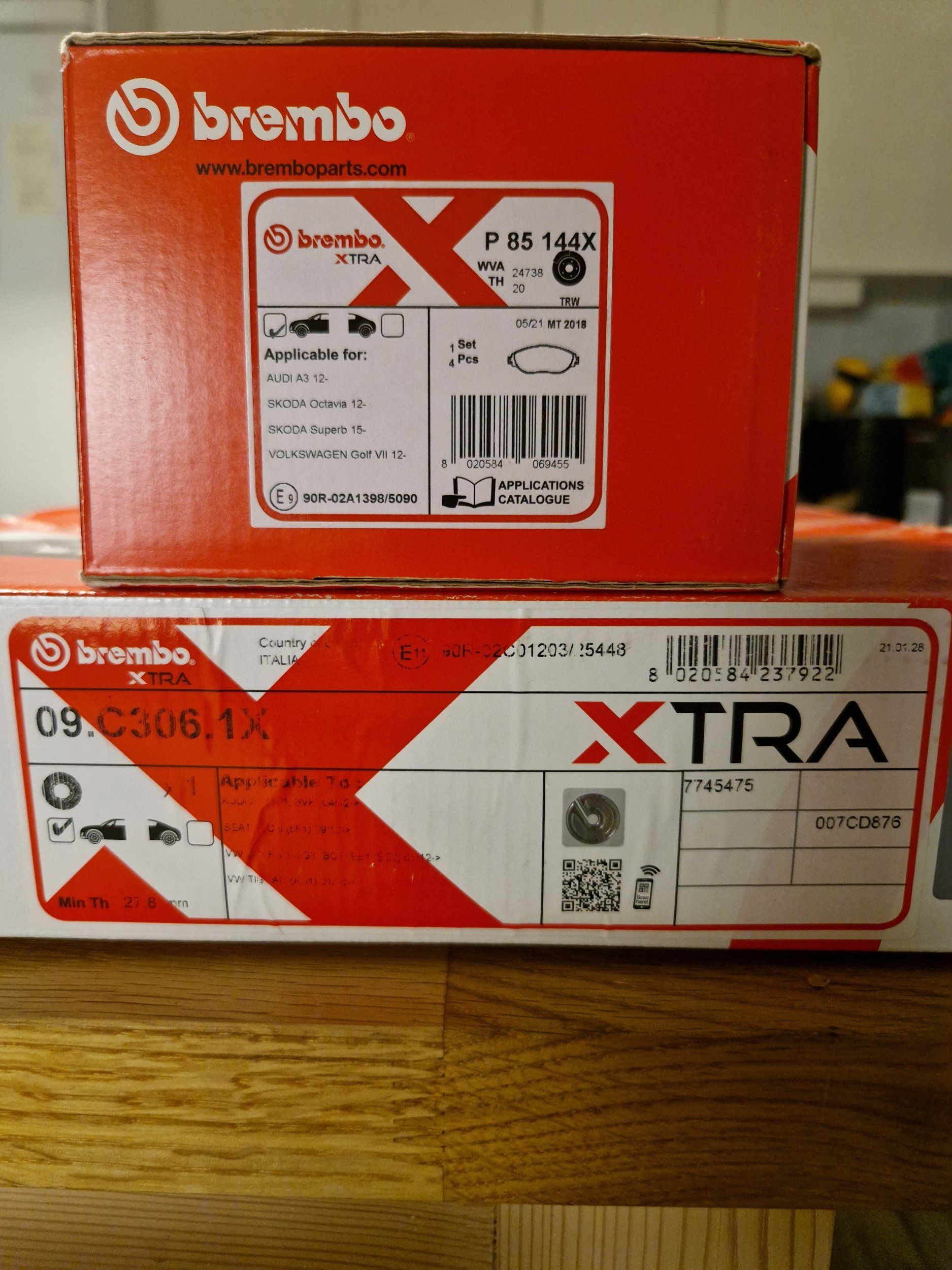

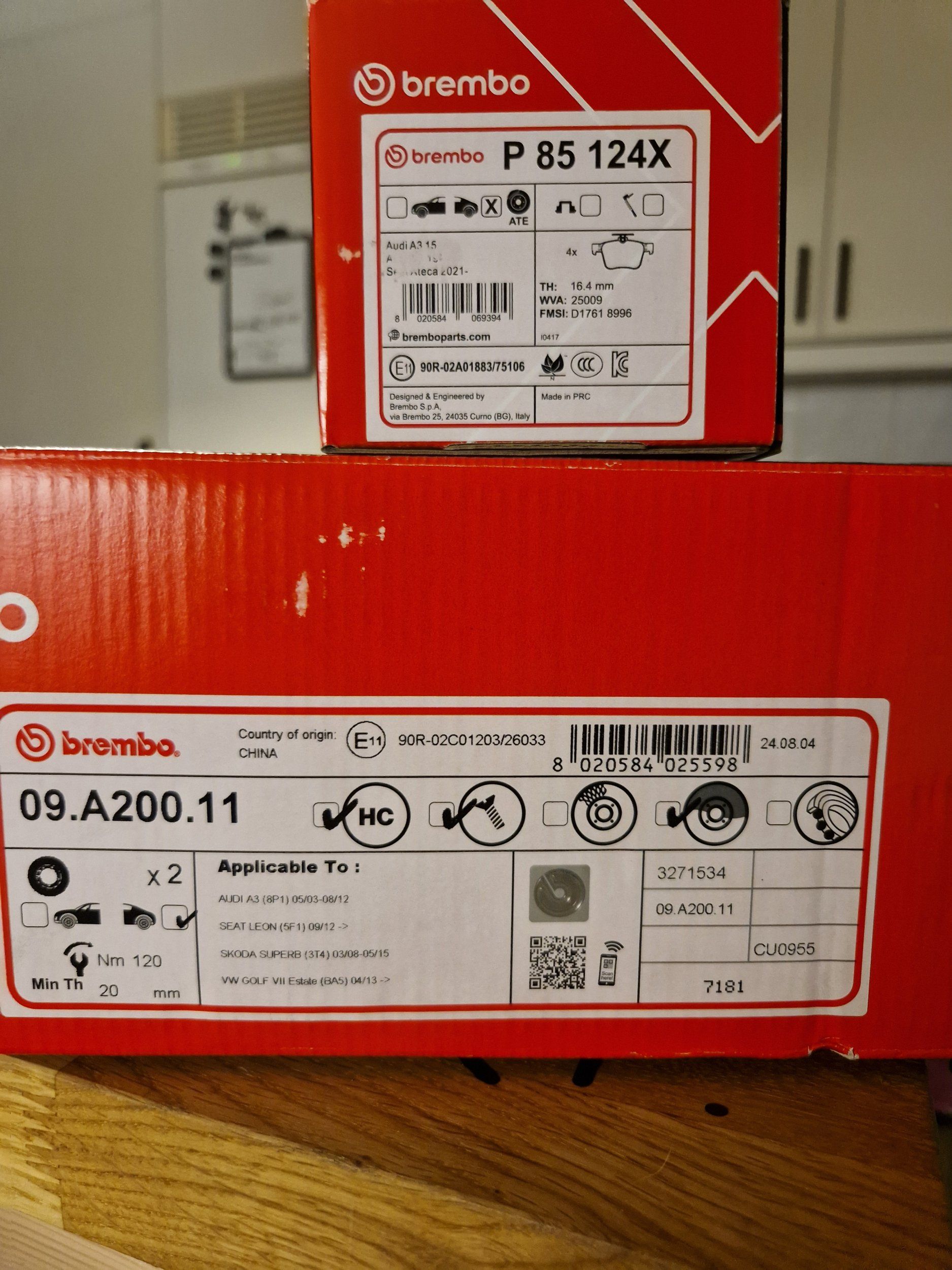

Since November i own a 2019 Seat Leon Cupra ST300 ( VIN nr. VSSZZZ5FZKR038797). I like the car so far, but only driven it 500km before brakes gave up. I now want to change discs and pads, both front and rear.
I ´ve tried searching for what brake setup my car has, and how to navigate with PR codes and different brands of manufacturors - but i cant seem to find any 100% certainty..
Front brakes i got marketplace, but rear brakes i ordered new, and can return/change if needed. I might have been too quick buying stuff, because i cant wrap my head around these PR codes. None of mine seem to match. Anyone know if this setup will fit my car?

Hi Martin
Here's the parts list for your car:
FRONT (PR codes: 1LD or 1LJ)
5Q0615301G Brake disc vented 340x30mm x2 units
5Q0698151AJ Brake pads with wear indicator x1 set
REAR (PR code: 1KY)
5Q0615601E Brake disc vented 310x22mm x2 units
3Q0698451N Brake pads x1 set
--or--
5G0698451A Brake pads x1 set
Hope this helps & best regards,
Serdar
