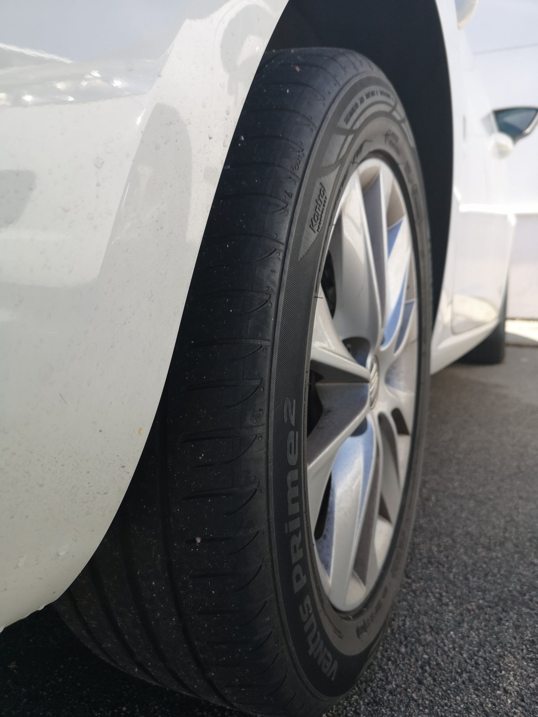

Hey guys!
Apologies if this has already been asked before, this entire ''Fitment'' thing is completely new to me.
I'm in the market for some new wheels and was hoping to get some insight/guidance in the process.
I have a stock Leon ST face-lift from 2016 with stock suspension. I have tried looking around online but the majority of information I found was for FR's/Cupras not so much on the base models.
I believe the stock rims I am currently running are 16s but I want to go up to 18 & my biggest confusion is in regards to the ET/off-set. I am not 100% certain on what the current ET is but the front wheel is basically flush with the arch cover, whereas the rear wheel is basically inside of the wheel arch which I hate.
Based on other threads the majority of FR users are being suggested ET 35/40 would I be able to run those too on my base model? I know the FR is lowered from the factory already whereas the base model isn't.
The look I am hoping to eventually achieve is where the rear wheel/tire sits flush with the cover. Does anyone own a base model ST or has knowledge of what I can run? Any help or recommendation is highly appreciated.
Thank you so much
For reference, current setup:
Rear wheel:
Front wheel:

To save you the trouble of taking a wheel off your car to find the size / offset details, I’ve done some research. I’m pretty certain your existing alloys are these;
Style; Seat Design 30/1
Part no.; 5F0601025A.
Size; 6.5J x 16”
Offset; ET46
Tyre size; 205/55 R16
I did a search on the part number to get the above spec information.
When you’ve found a set of 18” alloys you’re interested in buying, you can use the size, offset and tyre size information above to input into the calculator on www.willtheyfit.com website, along with the equivalent information for your chosen 18” alloys and the calculator will give you the important clearance differences between your existing wheel / tyres set up and your proposed new set up.
Hope the above is useful ?.
