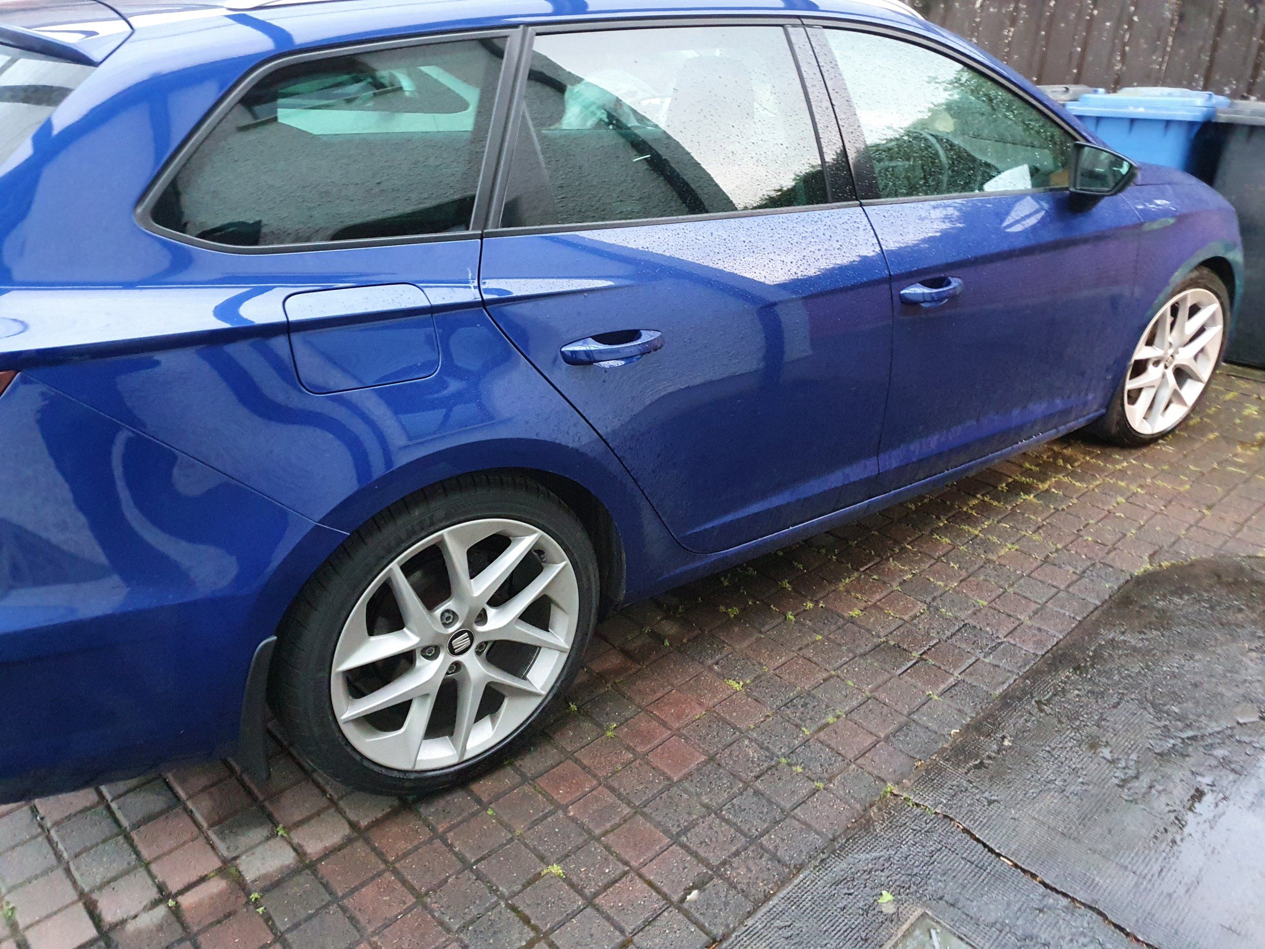

Mud flaps fitted yesterday evening.
Still needs a good wash though when it stops raining...

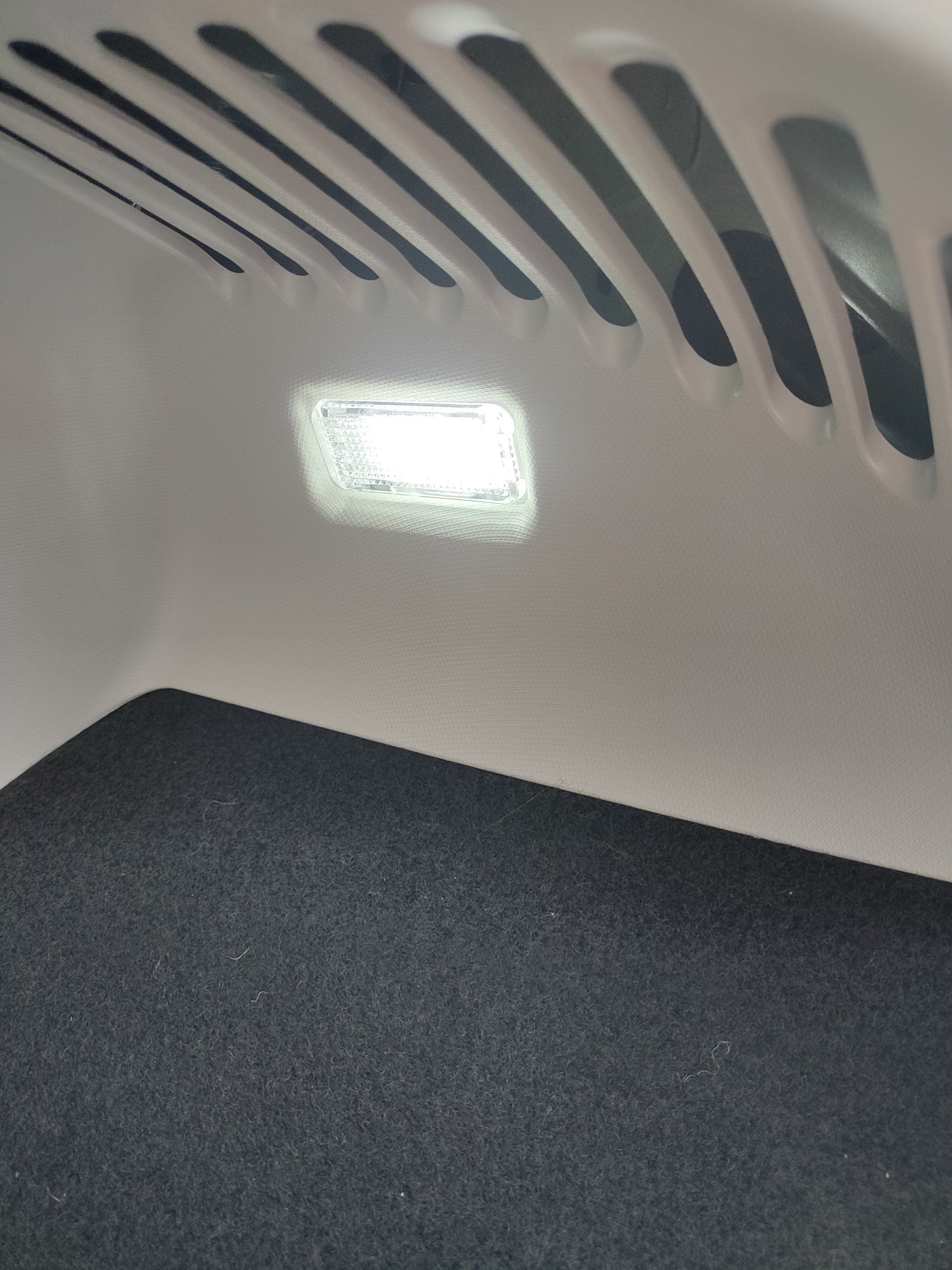

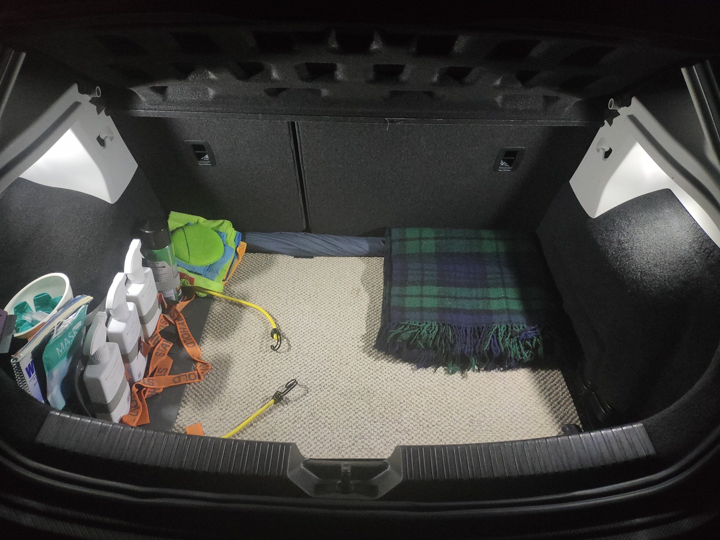

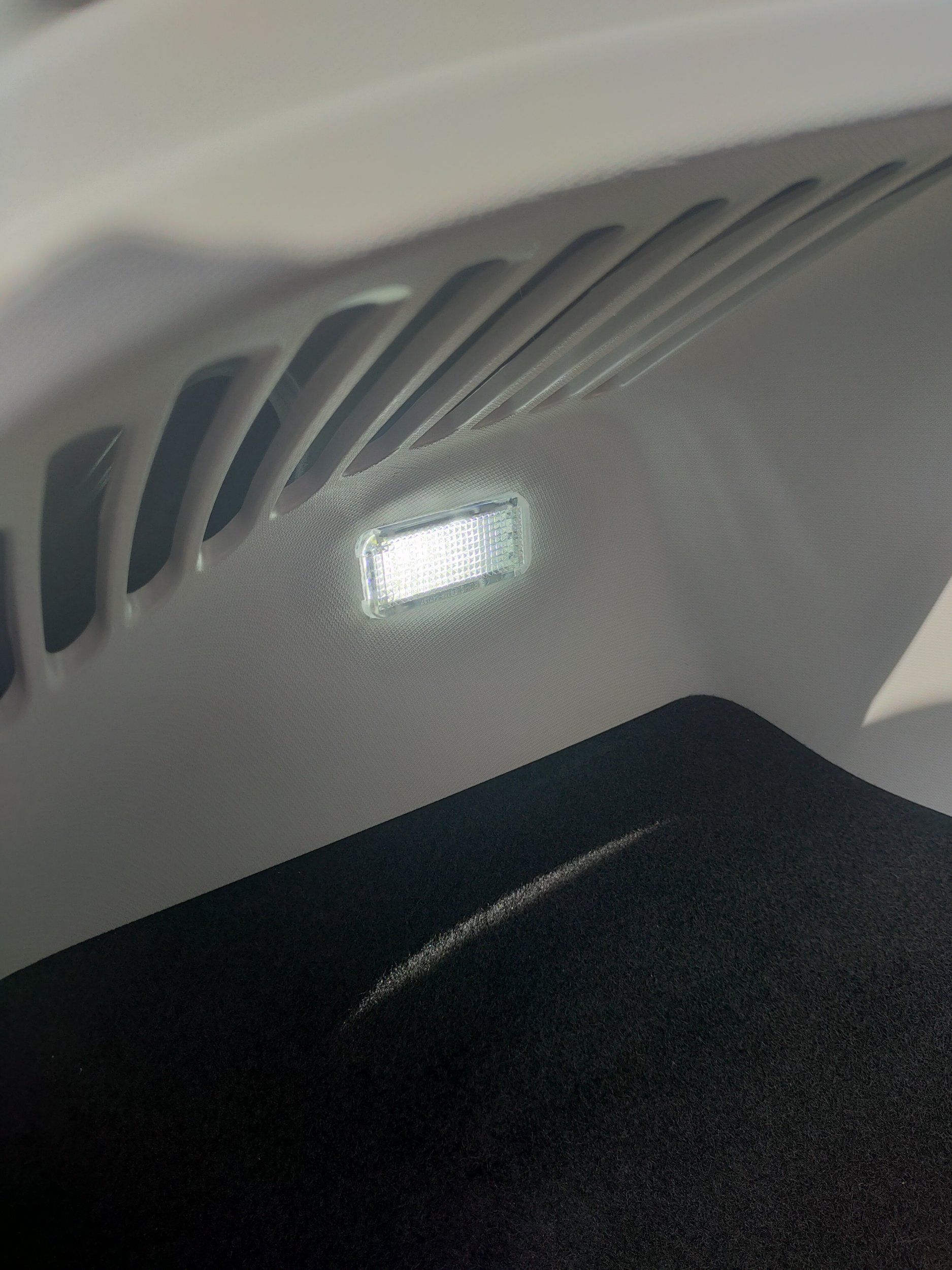

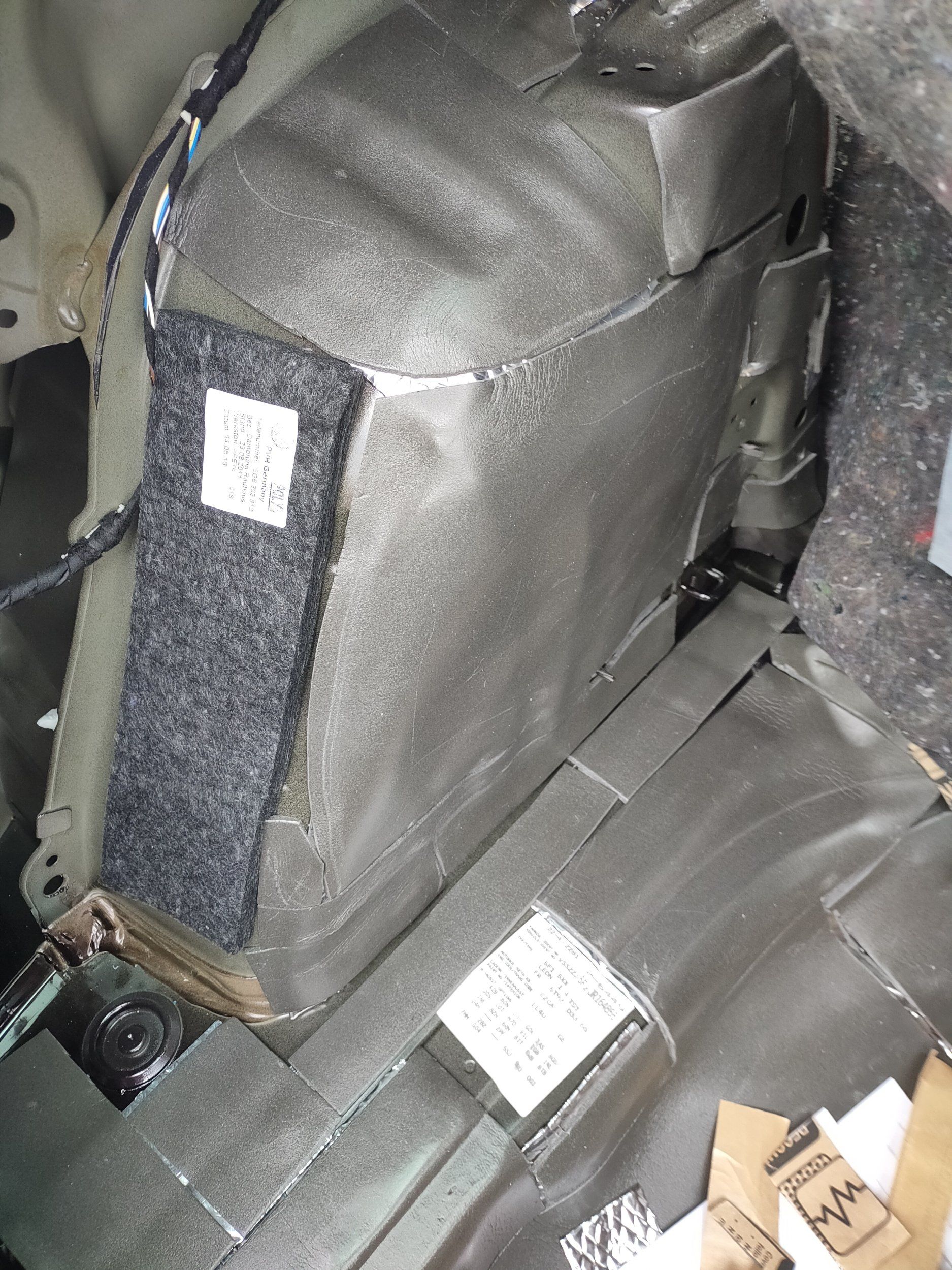

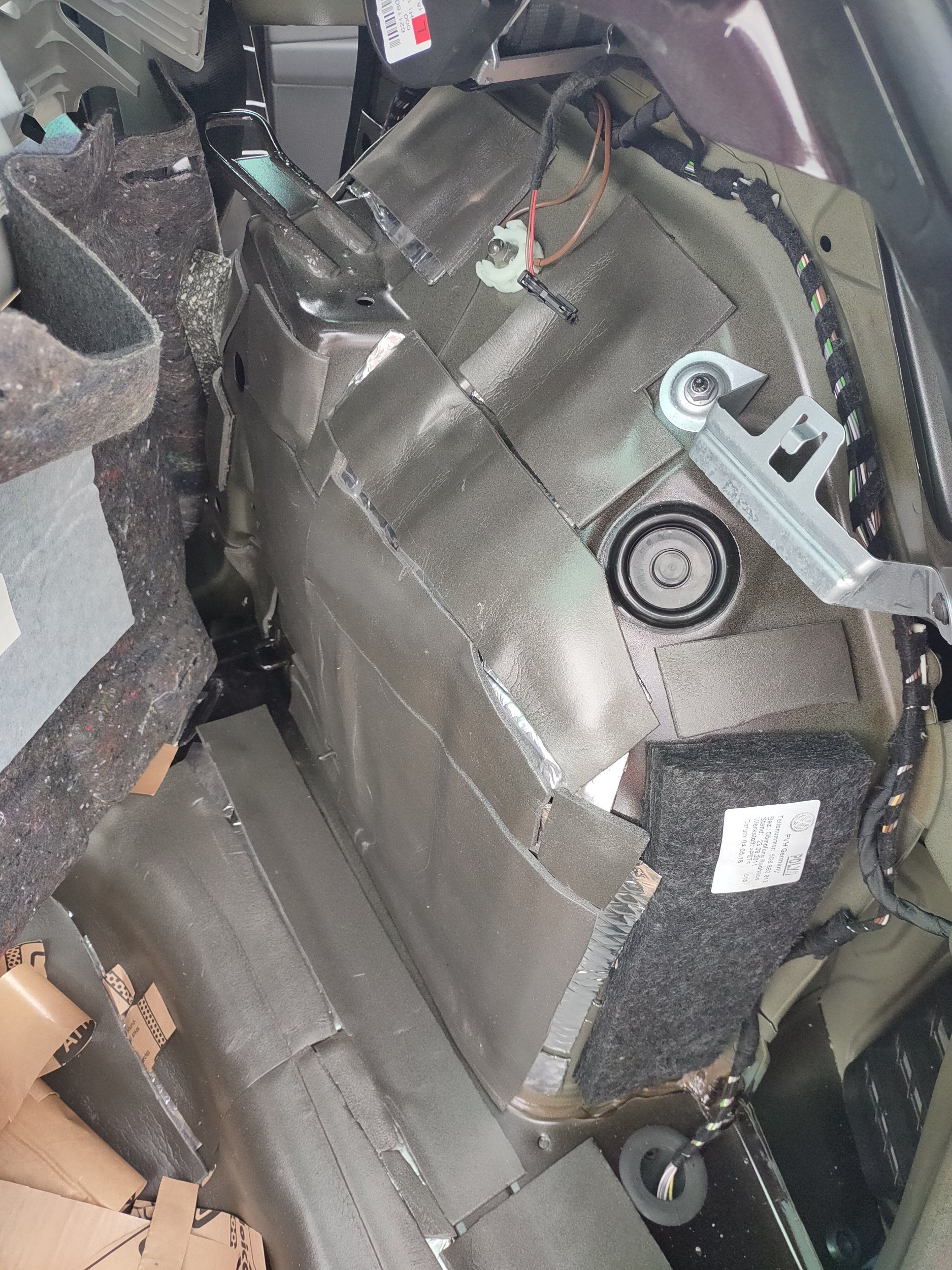

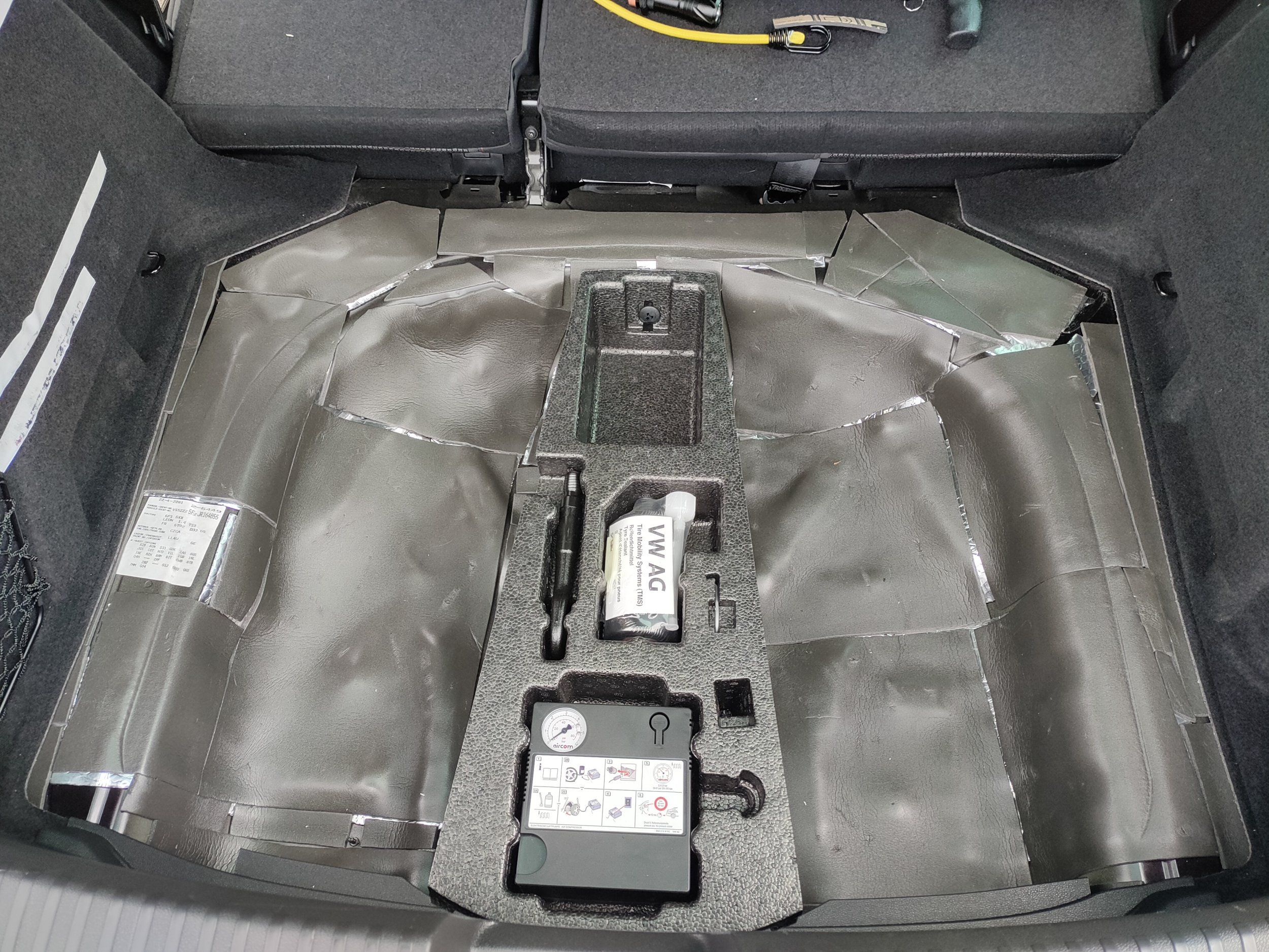

After soundproofing the doors a few weeks ago, I did the rear wheel arches and finished off the boot floor. Made a big difference to noise and music. I also upgraded the interior LED boot light and installed another one on the opposite side. Here are links to what I used.....

@Don1961 Good job, I did mine earlier in the year and it's a very underrated thing to do. I plan on doing under the carpet and the roof. If it turns out to make a reasonable difference I'll let you know.
With the light, did you just tap into the two wires and run them to the other side?
Don1961
Apr 11, 2019
213
118
Hi. Thanks. Yeah.... tapped off the two wires for original light, ran them over the top and then two bullet connectors onto new light. The new light plugs into original light socket. Checked with OBDeleven afterwards and no fault codes. You have to lengthen original hole by about a mm to fit new light
There's a hole already there?
Those lights look exactly like the ones I just fitted in my footwell and they required some trimming too.
Don1961
Apr 11, 2019
213
118
No. Sorry. The hole on the right hand side, for the original light. You have to cut out the hole for the new light on the left hand side.

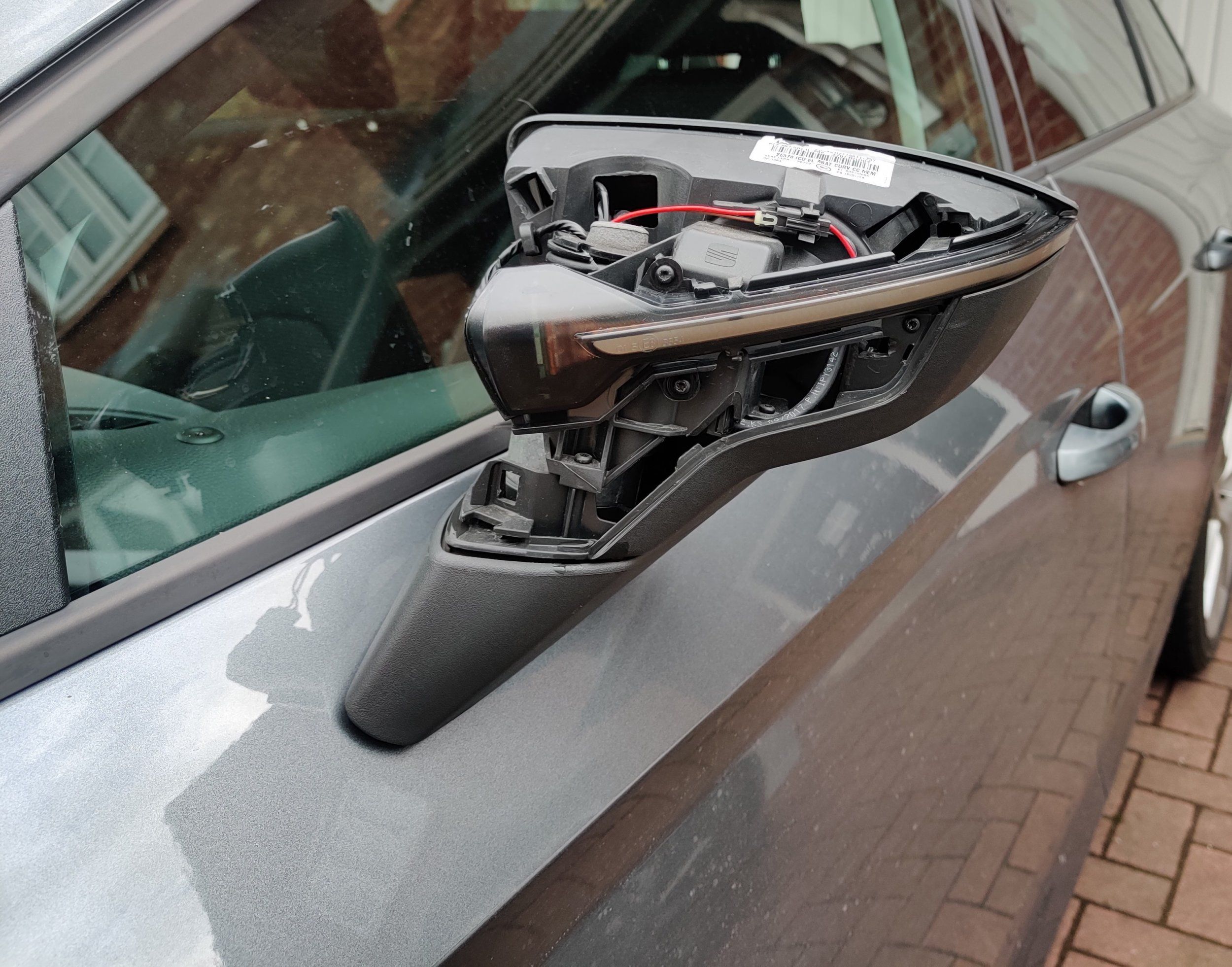

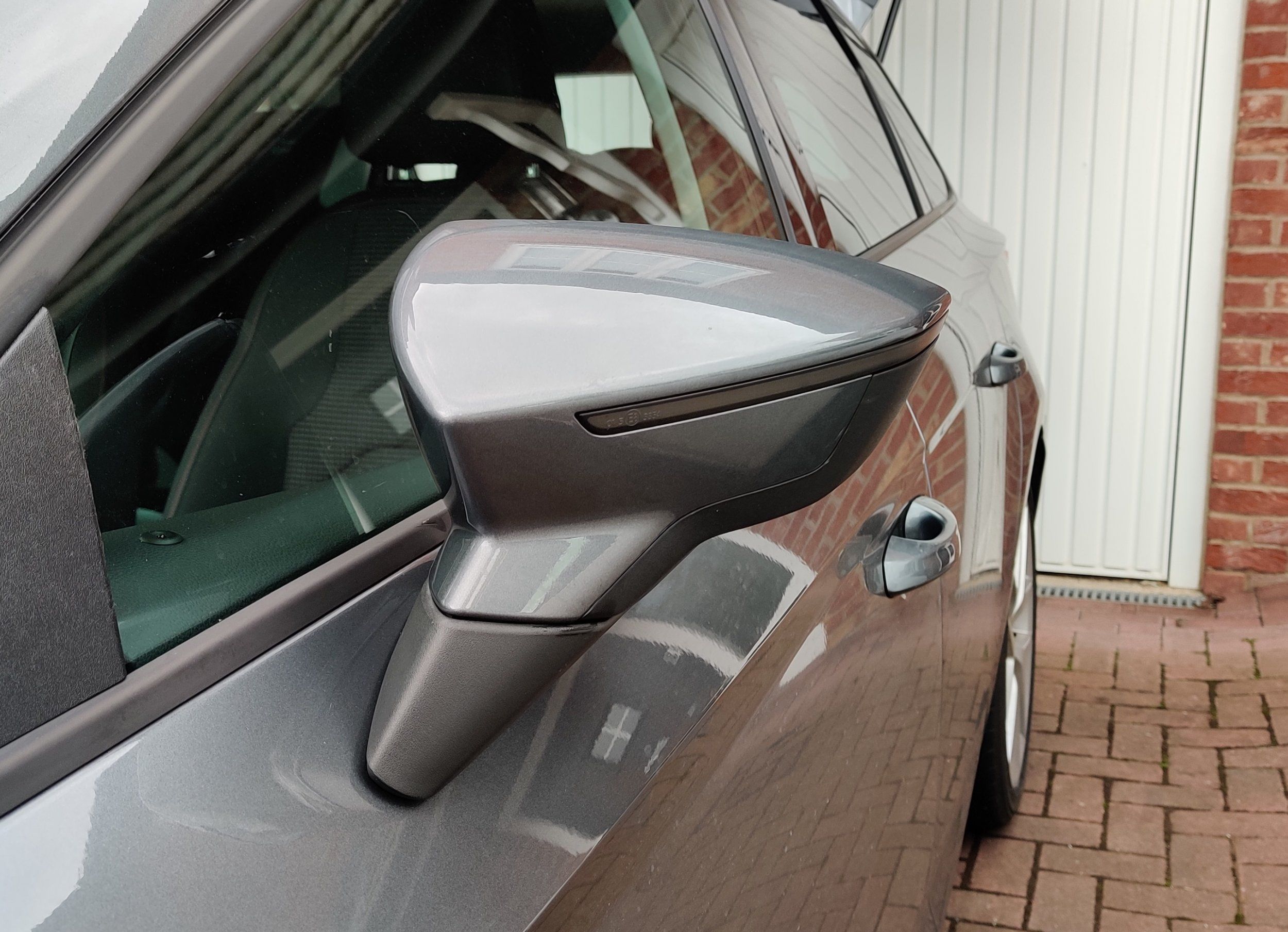

Then my first hardware change - fitted sequential indicators - which IMO greatly improves the look of the car. Partly because I like the sweeping signal, but also because the grey tint blends into the mirror cover
