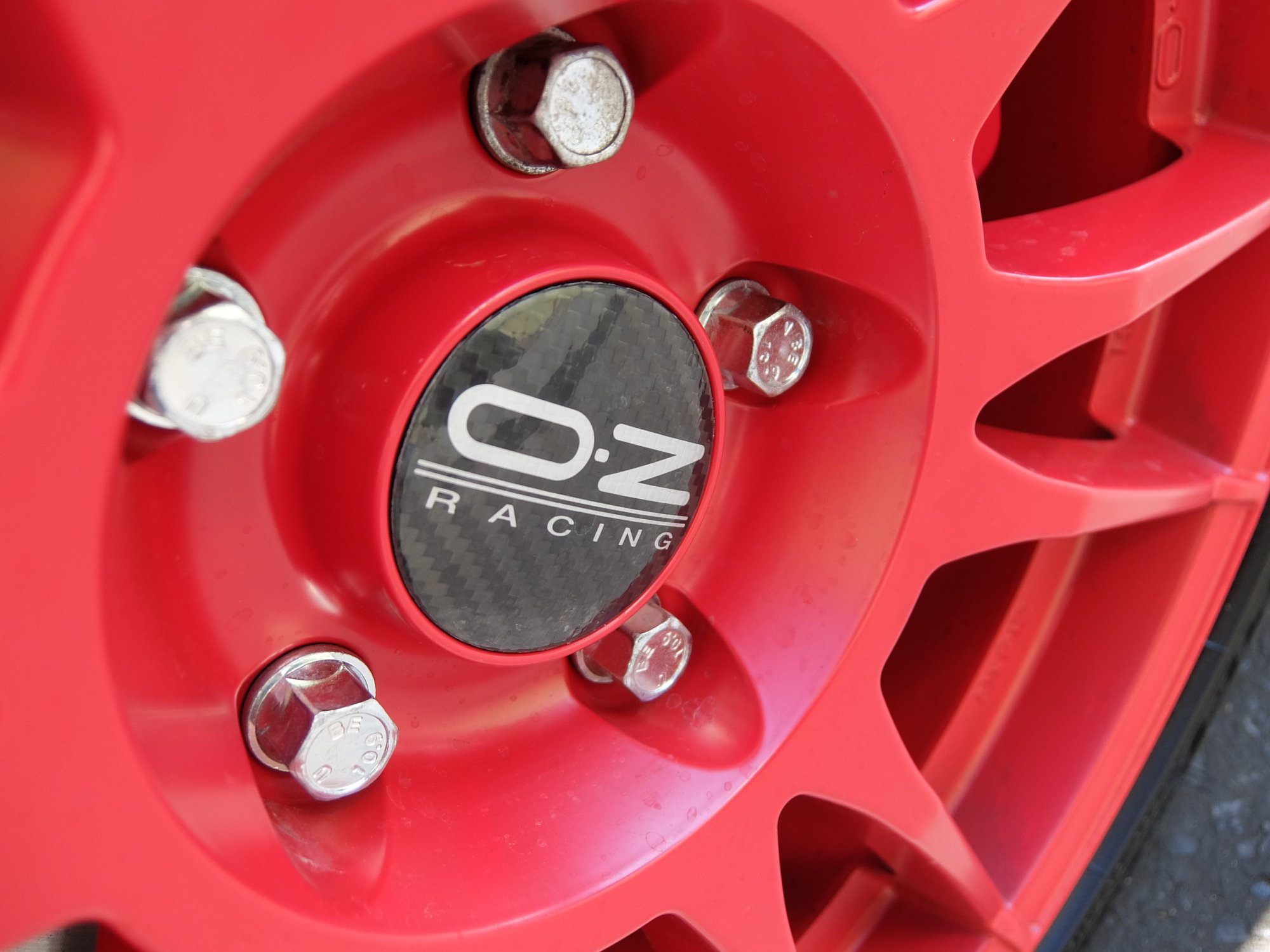

@Deano j1971 I am no expert @Damo H has a fair bit of experience on this stuff.
Personally I have ET45 and no spacers but from memory the key bit is also about how the spokes sit.
My BBK setup is 380 x 32mm
Hopefully you can see in the picture mine roll out from the center to give extra clearance of the BBK
from the outside
and with the BBK Showing
As I have two sets of wheels more than happy to meet in the middle so you can try a set of my wheels on your car first if that helps.
Update
On my setup19" was the smallest possible size.
