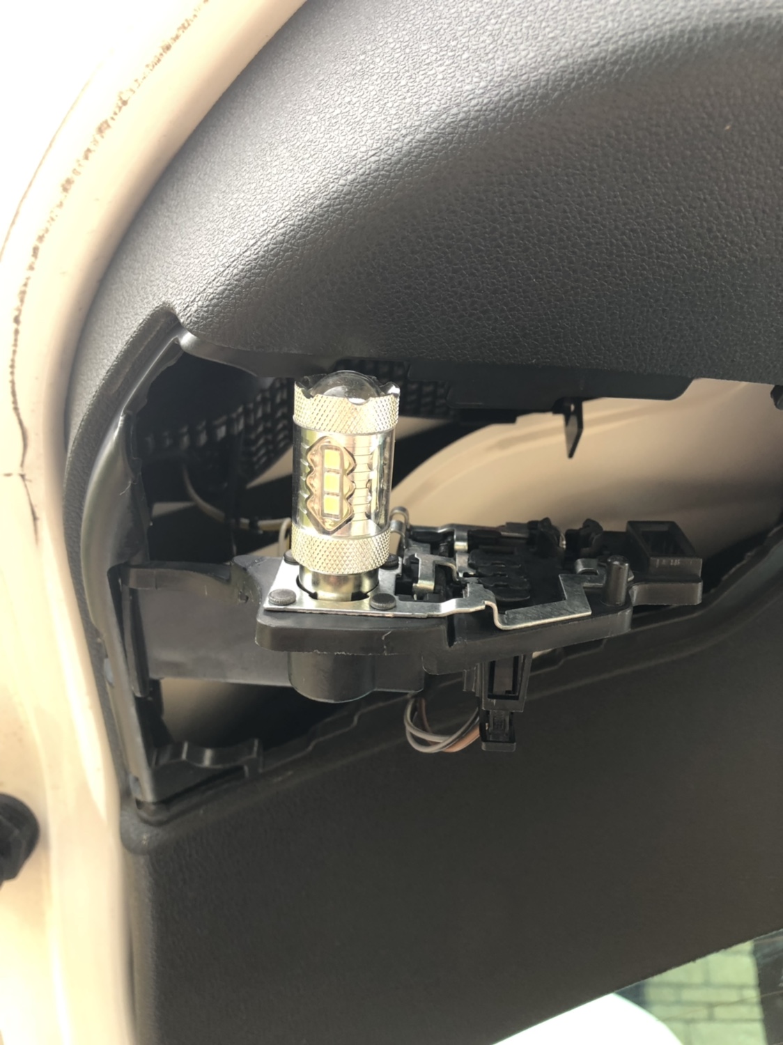

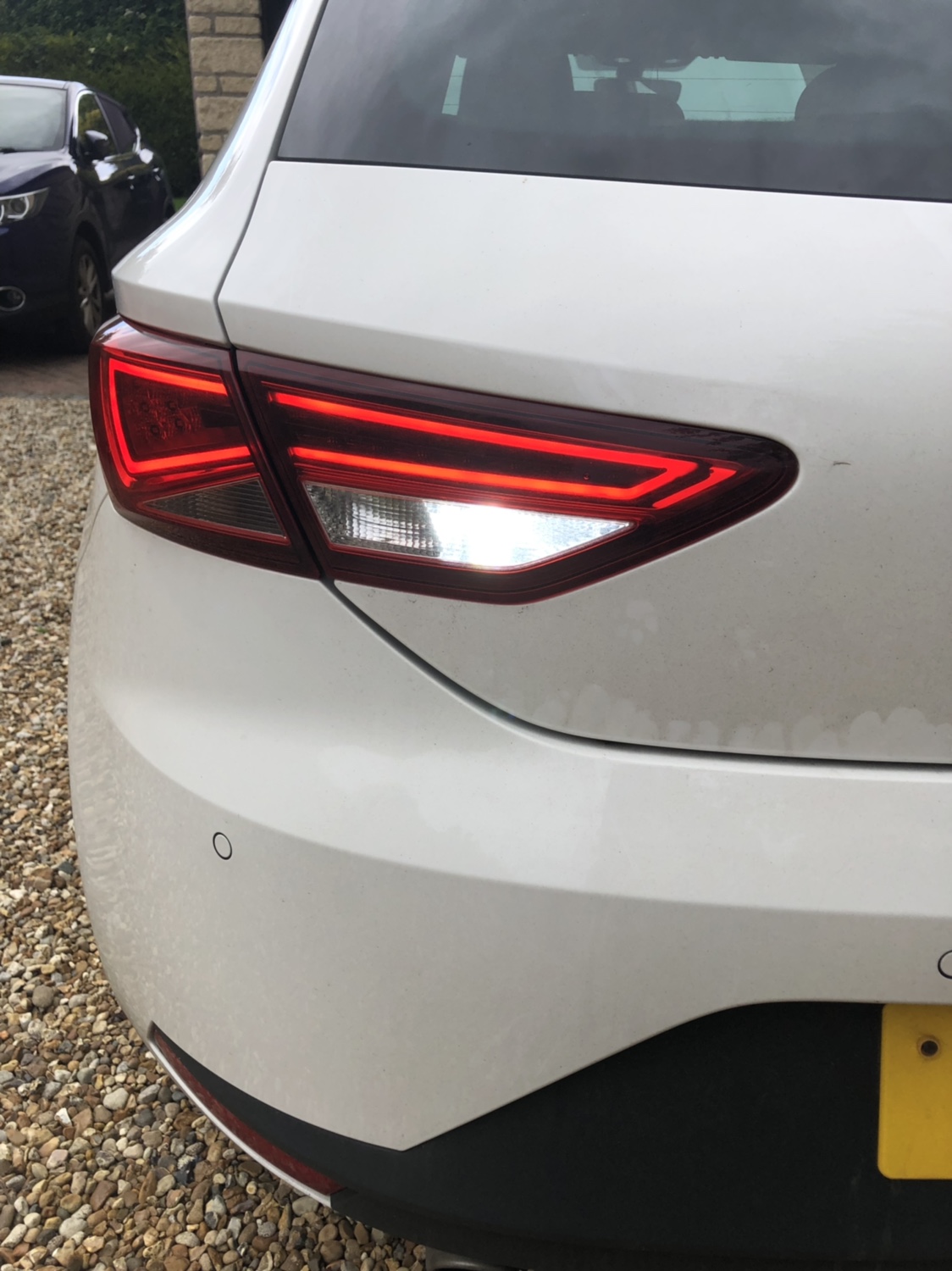

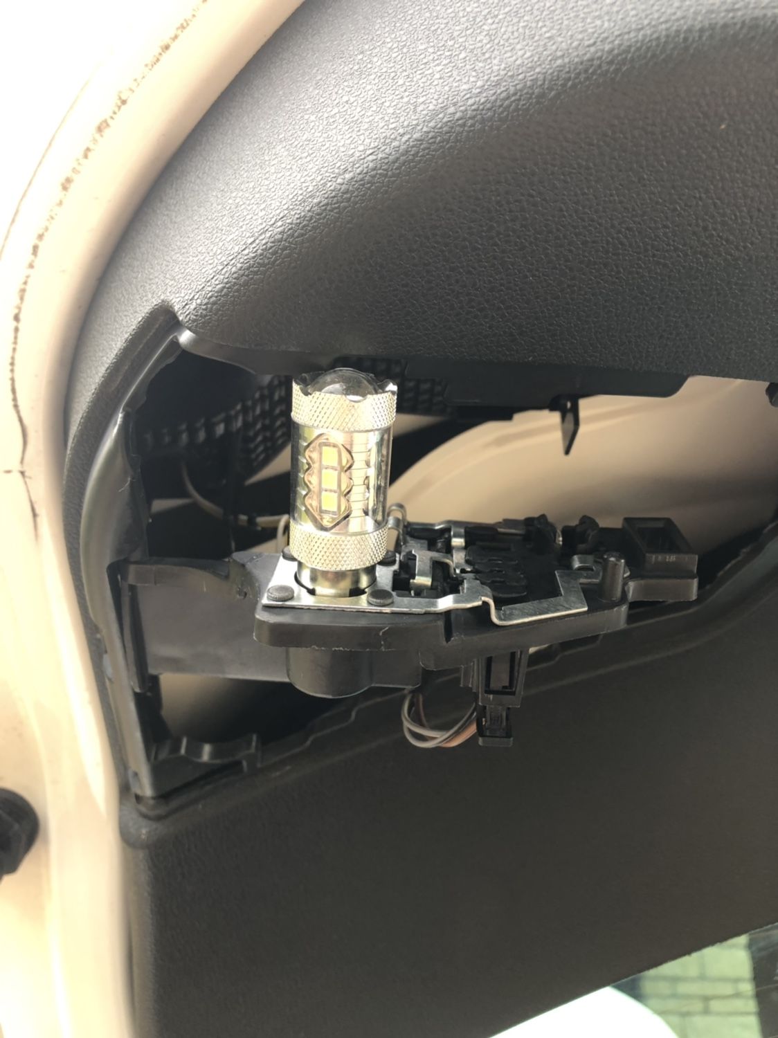

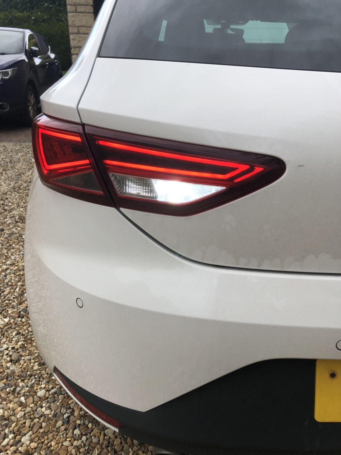

Couple of things today when I got a spare twenty minutes.
LED reversing bulb fitted
View attachment 7829 View attachment 7830
This was a cheapo from aliexpress so v pleased at the quality.
I then activated one touch mirrors, needle sweep, cornering lights and rear DRLs via Carista. I also activated the beep on lock and unlock but didn’t like the chirp so switched it off.

Its dead easy mate - on the left as you look up inside the boot lid theres a panel which just pops off by hand. You then unfasten two clips (there's only two visible) and pop out the light module. There is only one bulb in it. Its then a standard 2 prong bulb so you push and release the old and twist in the new. Clip the module back in and replace the panle.
BTW to test it you have to close the boot lid - I tried with it open and it didn't work so I thought I'd done something wrong!
