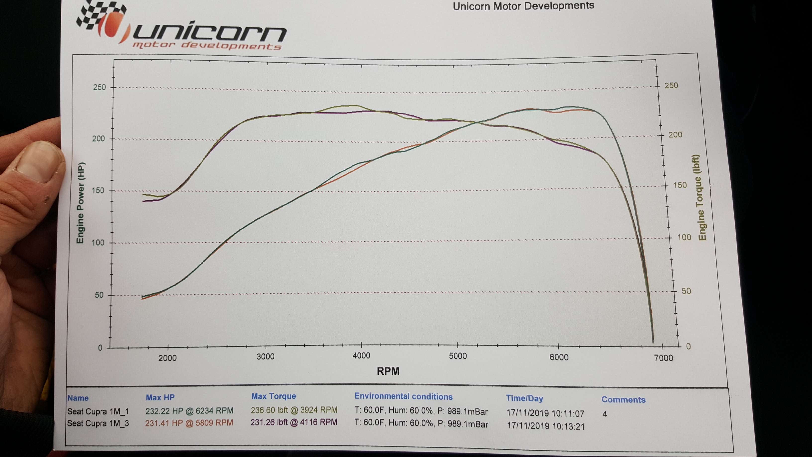

The dyno showed a nice smooth curve yesterday

Your torque is nice and even abroad the powerband. But still far below 300ft. Can bw higher
I think around 280hp should be doable with the right mods. Some push up to 290/300

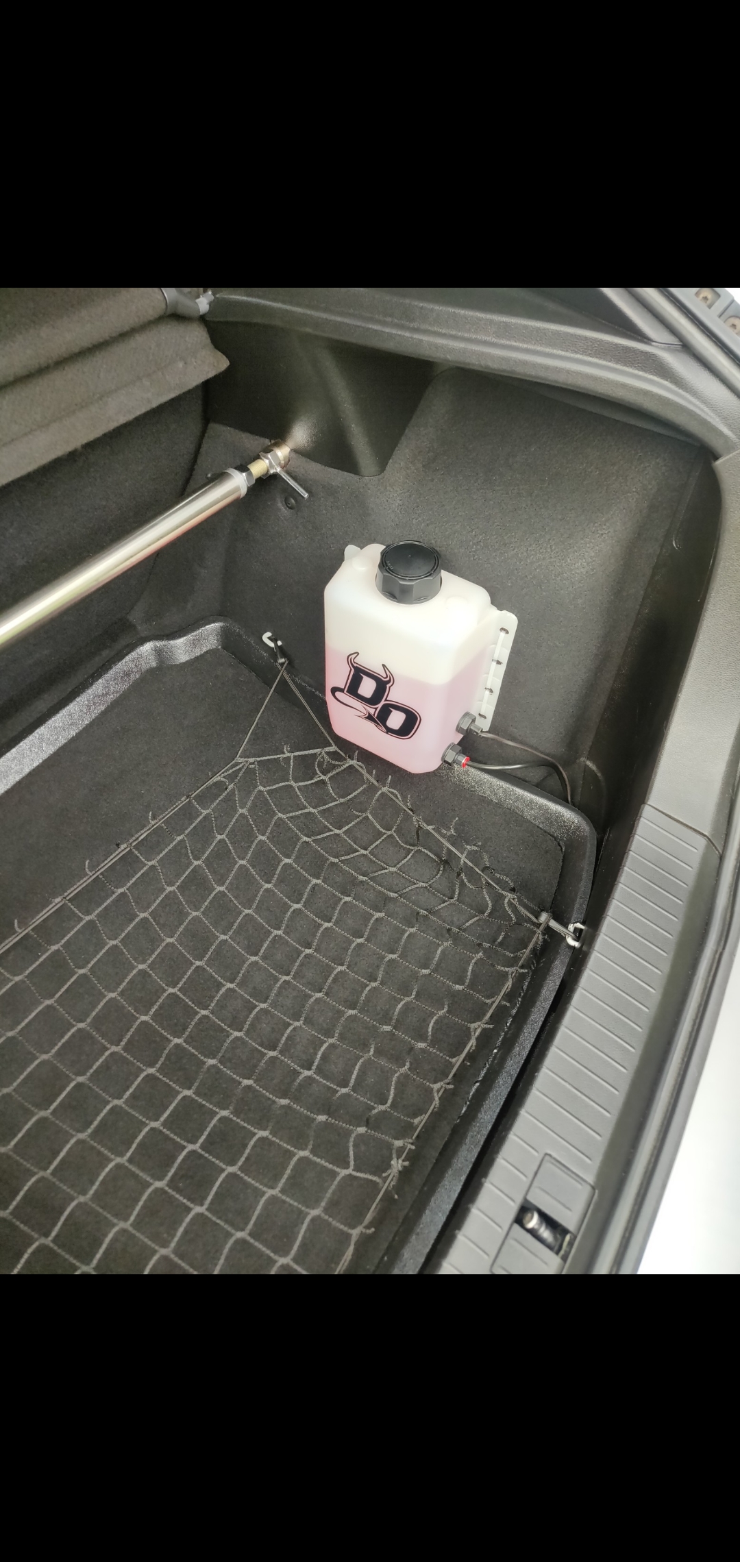

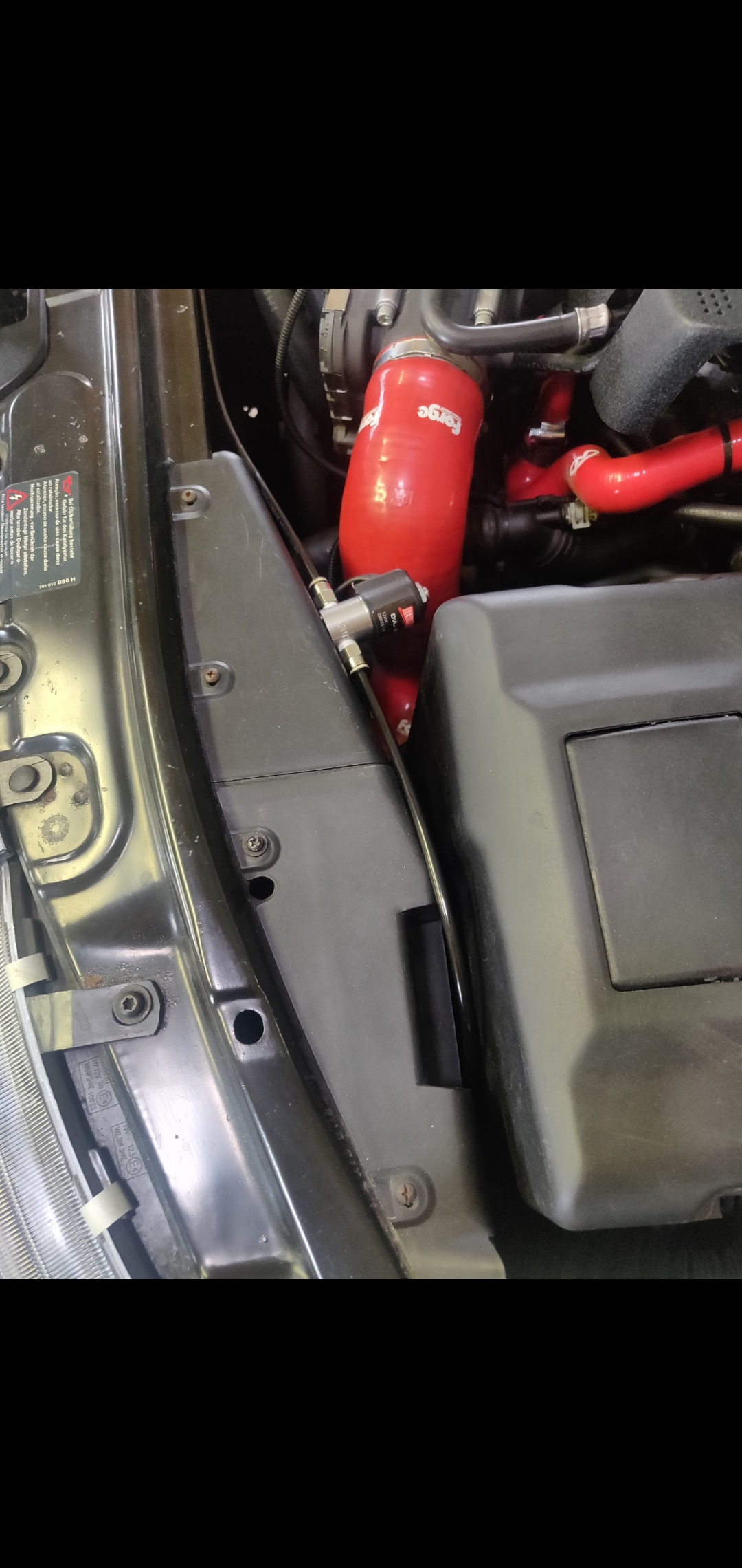

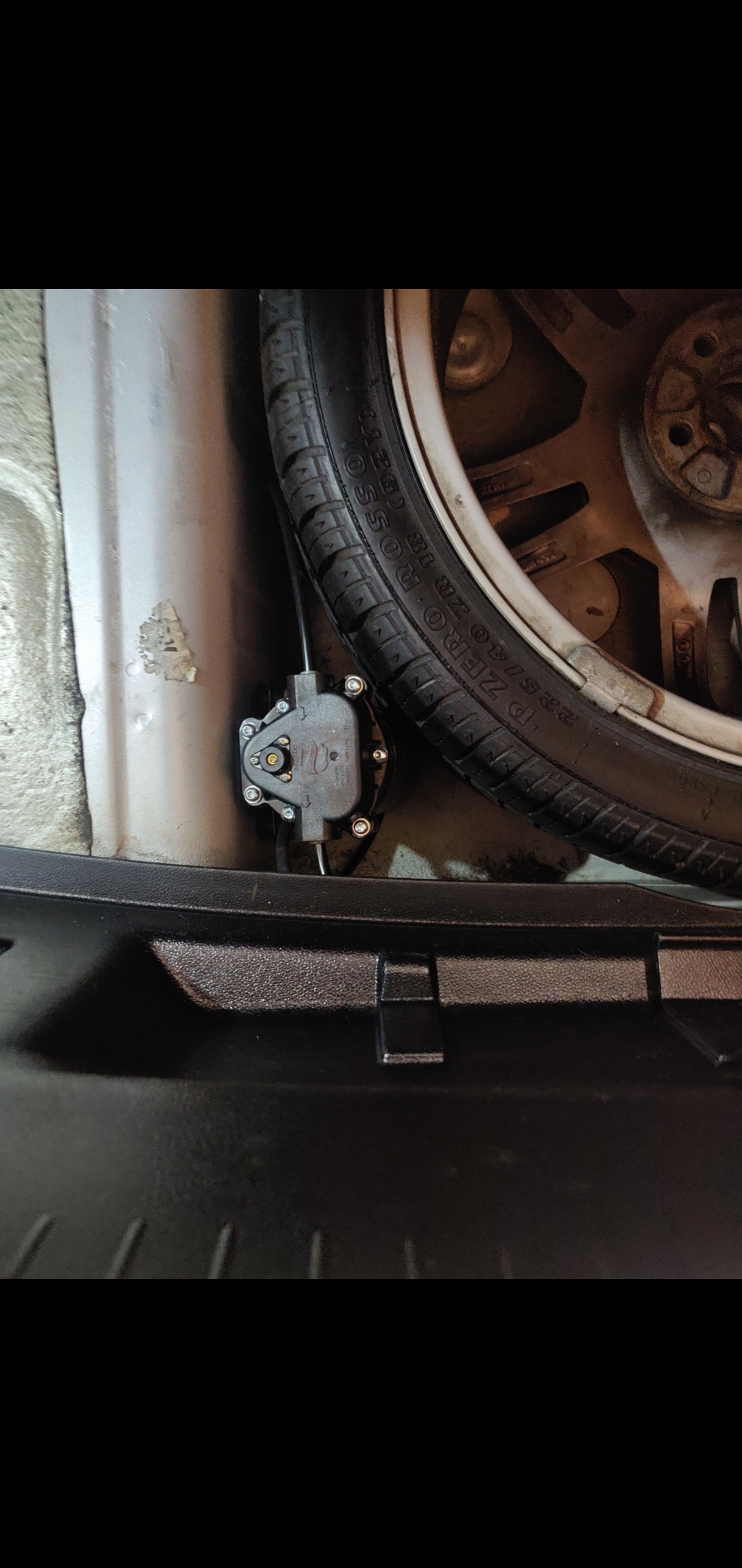

My nozzle is mounted down by intercooler piping. The pump is in the spare wheel cavity. Perfect fit even with the wheel in there. I have a 4 quart tank fitted in boot held by cable ties. This is a perfect size. I would imagine I go through full tank every 1.5 tanks of petrol. I recommend the Devil's Own kit and you can also buy the devil juice already mixed which saves me time.

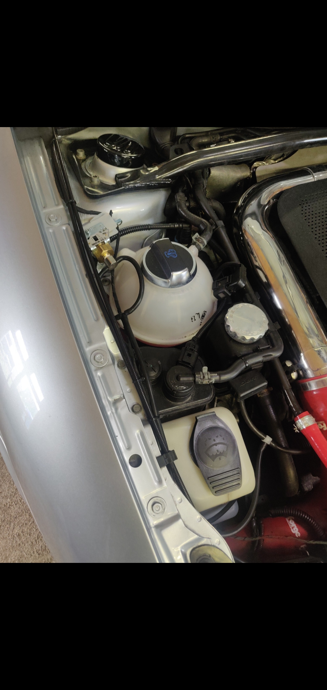

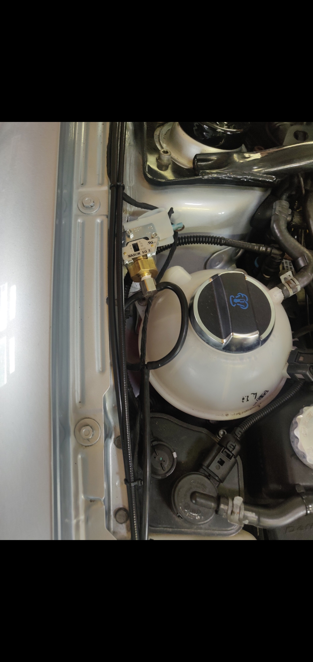

I didn't actually Need the solenoid but he fitted it anyway.
Then had to mount this somewhere. The actual nozzle is much further down underneath this point by intercooler.
4 Quart tank perfect size.
And pump fits lovely here.
