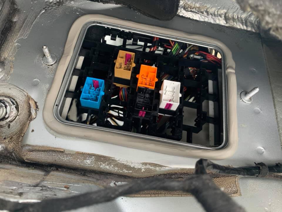

The butyl tape fixed my problem , water is no longer coming into the cabin , but seeing as this thread is quite active still.
I couldn't find anything on this issue , water is collecting onto the door sills (side skirts). It's not leaking into the cabin , but still curious on what's the reason for that to happen. I did all 4 doors with butyl tape and only 1 doesn't collect water on the door sills. Any tips , where to check etc. are appreciated.
andycupra
status subject to change
honestly sounds like a poor job done. sadly. many people over the years have done the job and its simply not worked.
im not 100% sure the butyl is the best and easilest thing to work with.
cleaning and clearing off the old stuff is difficult but something to spend time doing.
water on the sill in idicative of the seal leaking. whether it enters the cabin is down to the angle the car is sat at as well as how fast the leak is. if its leaking faster than the water drains away then it enters the cabin.
