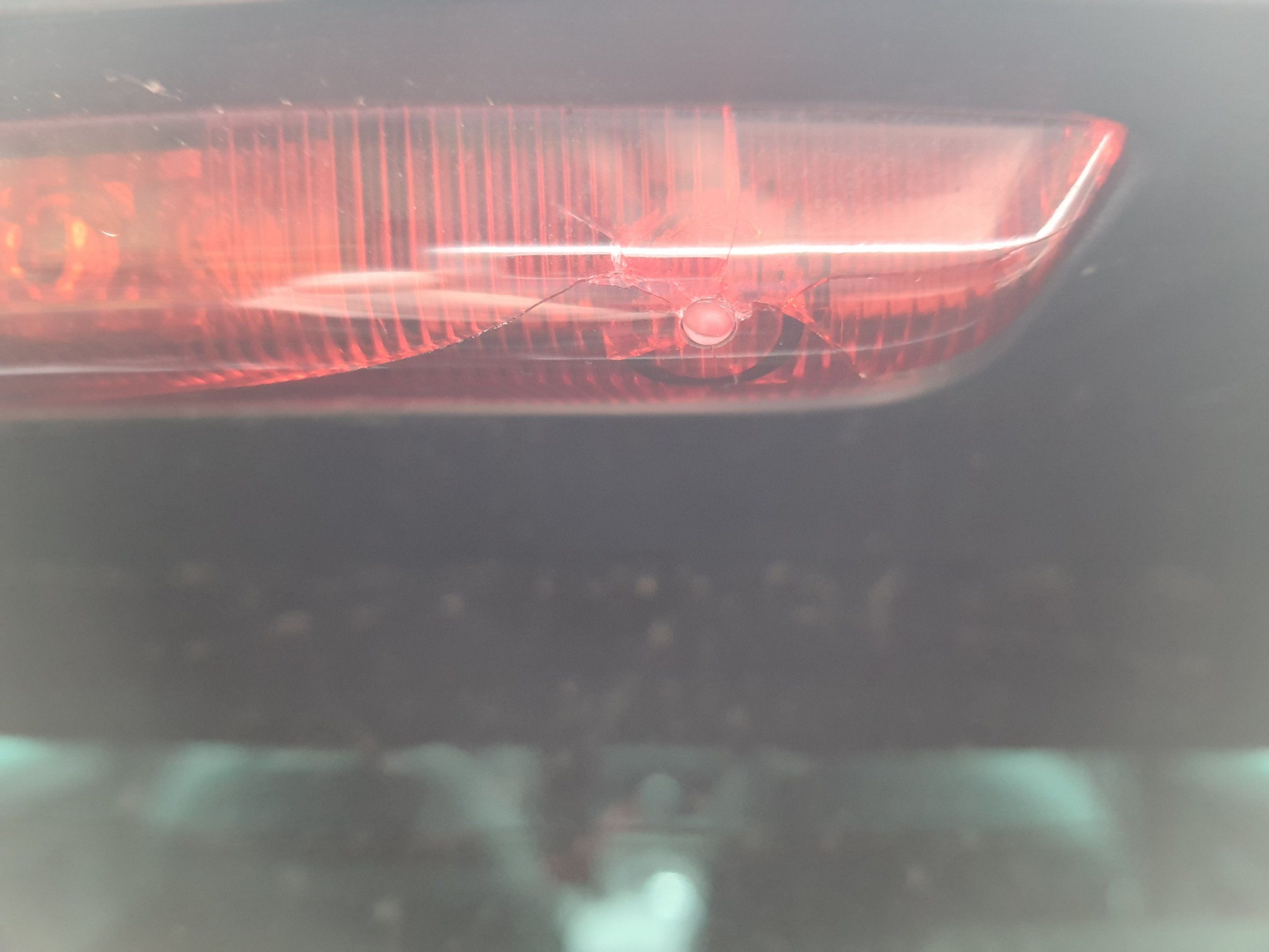

The brake light integrated into the spoiler of my Cupra is broken. No idea how.
Does anyone know the part number, or if its the same on the Cupra as it is on the other models?

Known fault on pre-FL and FL cars. There is a stress raiser around the washer nozzle and cracks propagate - I guess this is where your is broken?
If the car is in warranty get them to replace it.
By the way, I’m a fairly competent engineer and found the lens replacement to be an absolute PITA!

Yeah i checked, thats where its broken. I'll get to the dealer monday and mention it. I find it helps if you say the owners club say its a known fault..

Yes - you are correct that it’s a design error over manufacturing defect. It’s fatigue cracking from the stress raiser around the washer exit point in the lens.
