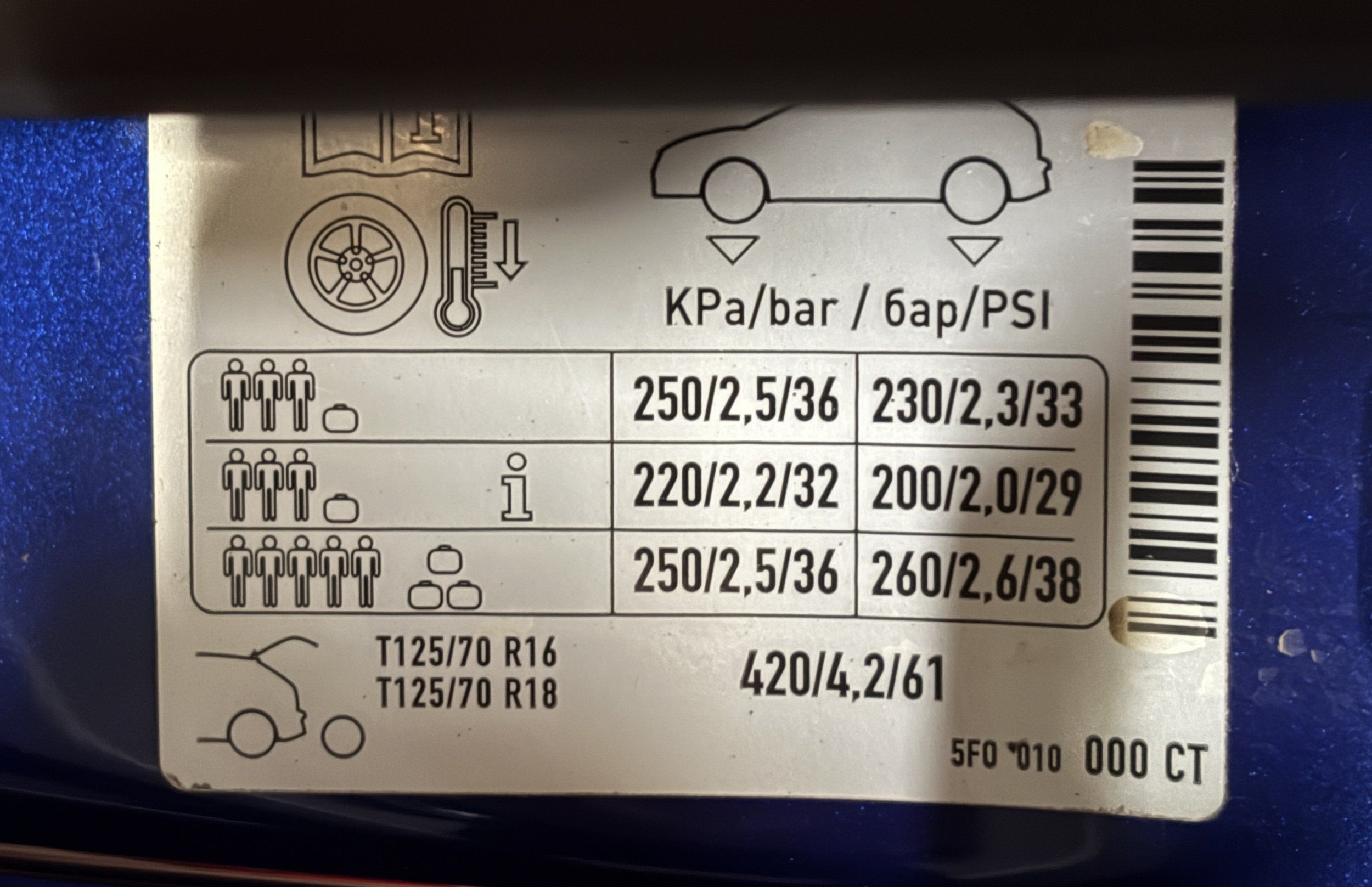

I've just got a Leon MK3 2019, and I notice the tyre pressure label has three listings, one of which has an 'i' with lower pressure for three passengers. I can't see it referenced in the manual. Does anyone know what the 'i' means? Thanks

The "i" icon symbolizes "information", meaning you need to look at the owner's manual for explanation. Maybe you missed it somehow, or maybe SEAT have forgotten to put it into manual :)
Anyway, those lower values are for "comfort" setting, meaning lower fuel efficiency but better ride quality.

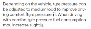

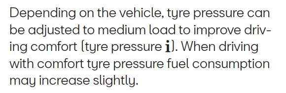

Thanks for the info. 👍 Yes looks like you're correct. I found the reference in the manual. Cheers
