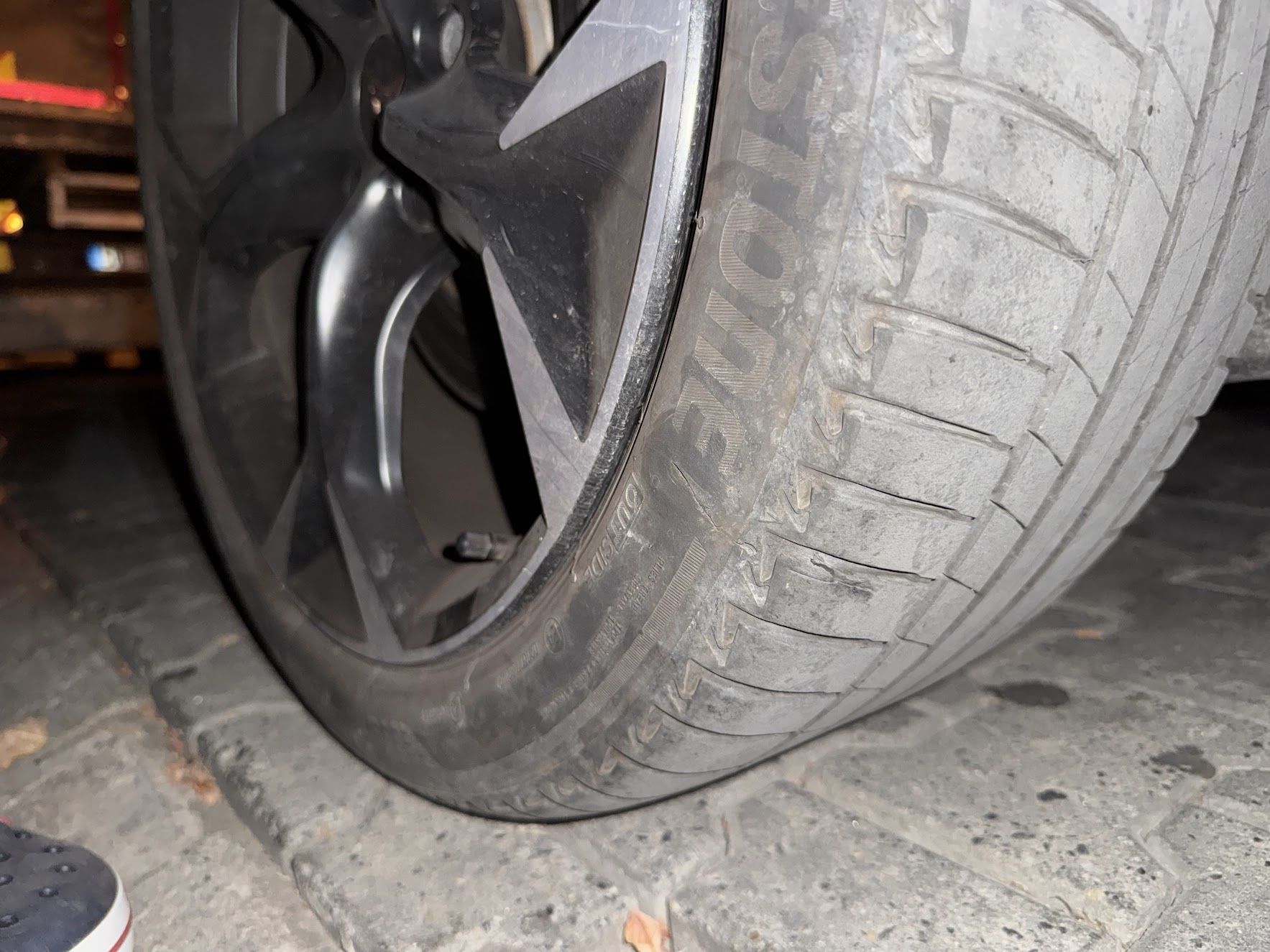

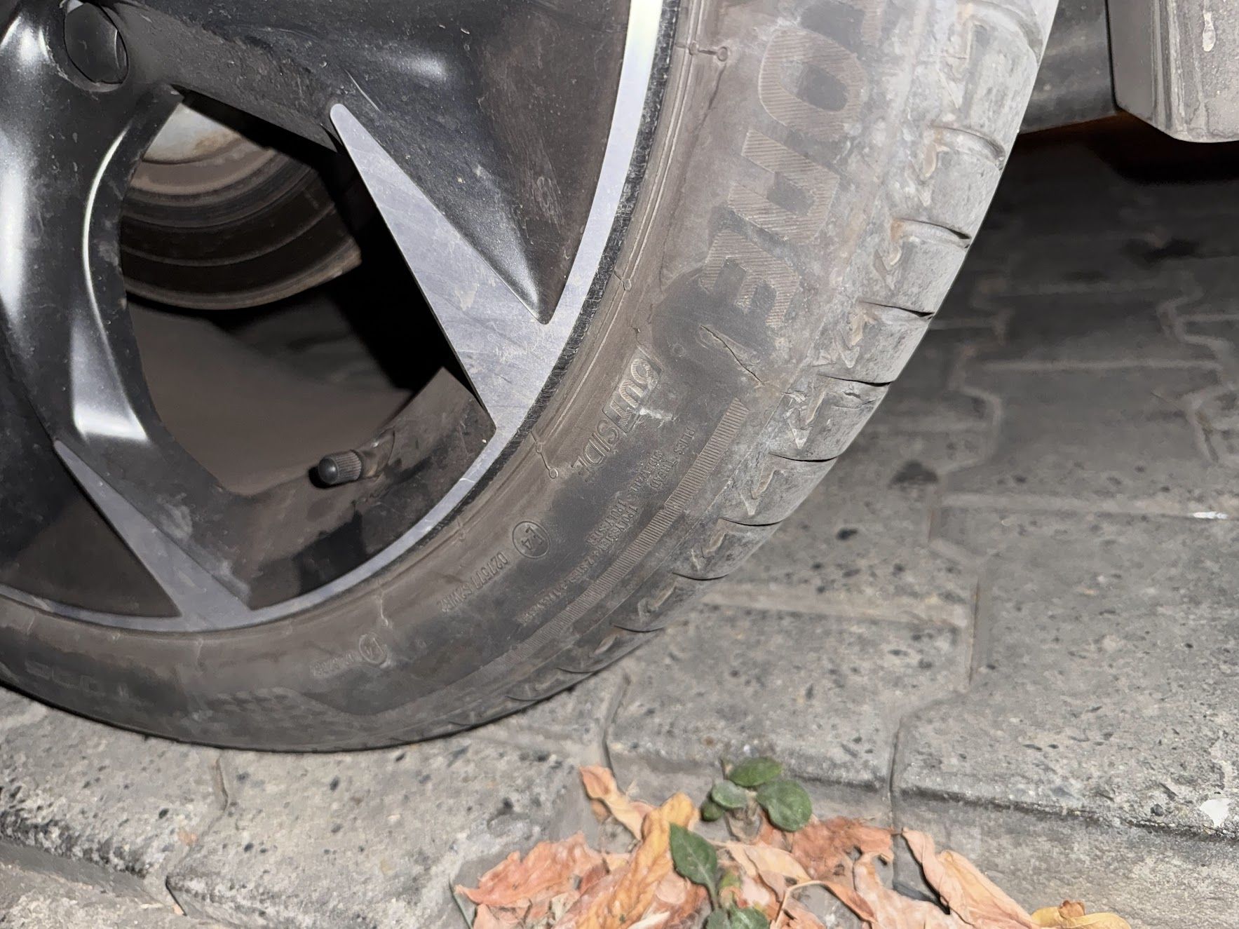

I saw there is a big crack (at least it is to me :) ) on my summer tyre. Can I continue to use it or just throw them away?
Car has extended warranty but Cupra told me that I made 38k km with the car and that makes tyre warranty invalid. They are not considering that I have a winter tyre set which I drive half a year.
My tyres look worse. I don't do many miles, so they tend to crack before they wear. I wouldn't say that was excessive. How much tread is left of the tyre?
To me it doesn't look too serious; it looks as if you scratched the tire against something. But as long as it doesn't deform the side-wall (outwards bulge) and the wire mesh isn't visible/exposed, I think you're safe.
For your peace of mind move the "suspect" tire on the rear axle...
To me that's damage from a sharp object.
Out of interest why move to the rear?
It is already in the rear but I wonder if I should keep it or change all four completely for safety
