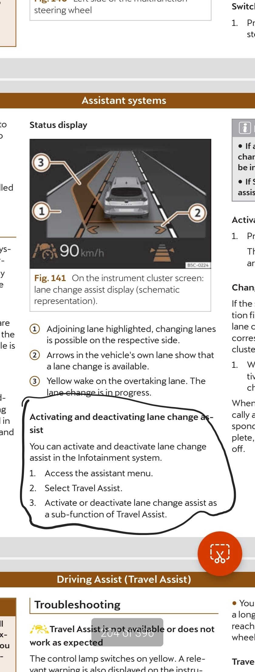

Feb 3, 2023
It's referenced in manual in few places.

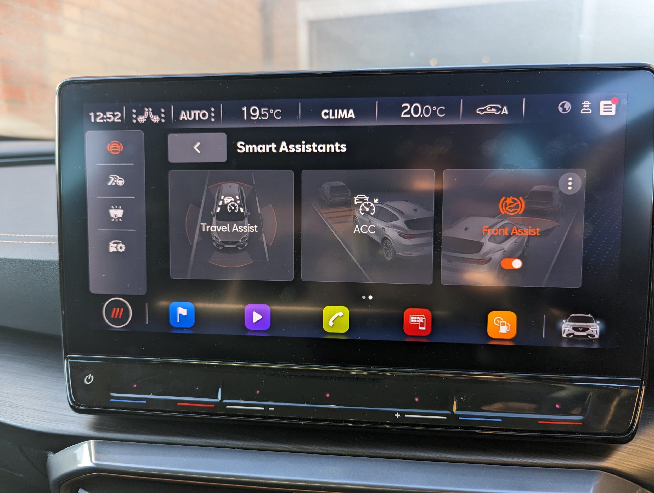

Feb 3, 2023
This is how the menu looks like in the infotainment.
I found it in another post on this forum related to travel assist retrofit. SW version of infotainment from the picture below is 1899.
