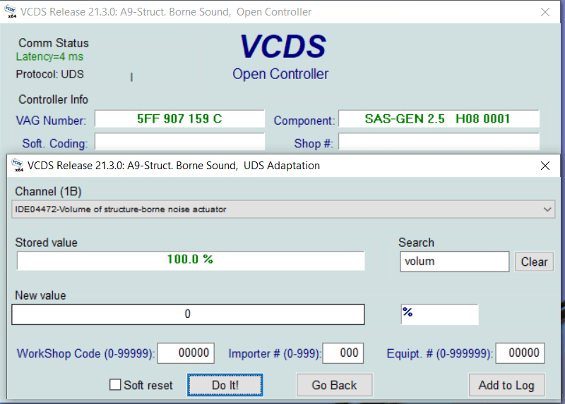

Disabled the Subi boxer sound mode and love it!. Definitely, CUPRA needs to surface the adjustment on driving profiles or whatever they fit.
