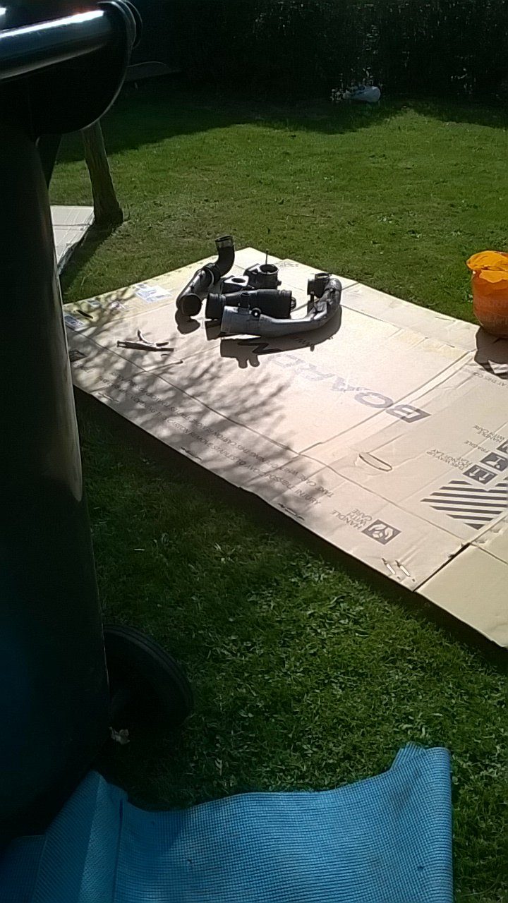

*** Update ***
Finally started stripping Down the tdi yesterday, so far got oil and water emptied, turbo oil return, egr valve and egr pipework removed, charge pipe and intercooler pipe off, had a nightmare with the egr to exhaust pipe as I was trying to get it off in one bit but someone had cross threaded one of the three screws that mount the egr pipe and it would not come out so had to split the centre of egr pipe to unbolt the inlet manifold..... Turbo, exhaust manifold , tandem pump, timing belt and finally get the sodding head off and have a look at what's gone wrong..... Happy days
