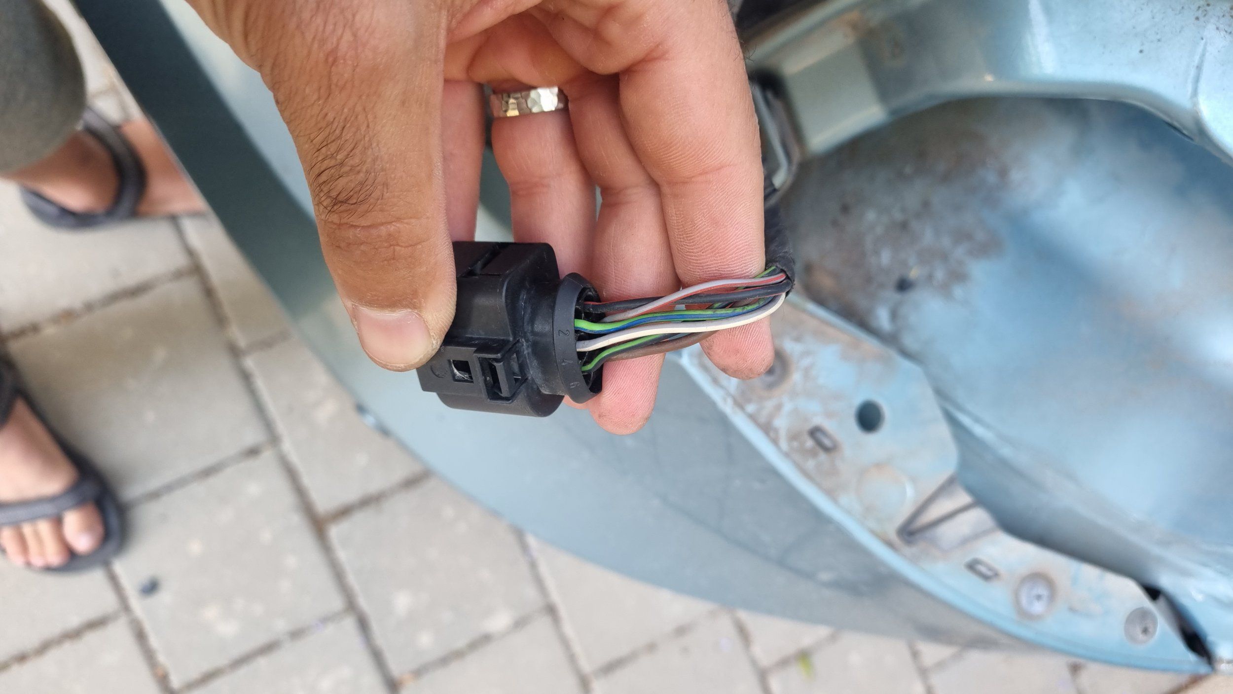

Yesterday I changed my right tail light bulb, the switch was turned on and suddenly the bulb i replaced -turned off
So right now the right tail light work fine(signal/reverse/brake light)
Except the light that suppose to work constant
What have i done so far:
1.Replaced the bulb again-didn't worked
2. Checked several time the fuse box with multimeter and they all good
3. Dissembled the tail light and switch between them-the right tail light work fine when connected to the left connector
4. Checked the right connector with a test light and there isn't any voltage on the constant light wire
Any suggestion what should I do next?

Place the vehicle on the lift. Remove the underbody panel. 90% cable break at the reverse gear switch
cairus
Jun 4, 2024
464
138
Disconnect the battery for 20 minutes and hold the connections that are normal on the battery together.
