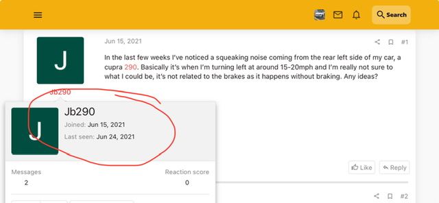

In the last few weeks I’ve noticed a squeaking noise coming from the rear left side of my car, a cupra 290. Basically it’s when I’m turning left at around 15-20mph and I’m really not sure to what I could be, it’s not related to the brakes as it happens without braking. Any ideas?

It’s unlikely you’ll get a reply from the original poster - they’ve not been active on the forum for nearly four years.
