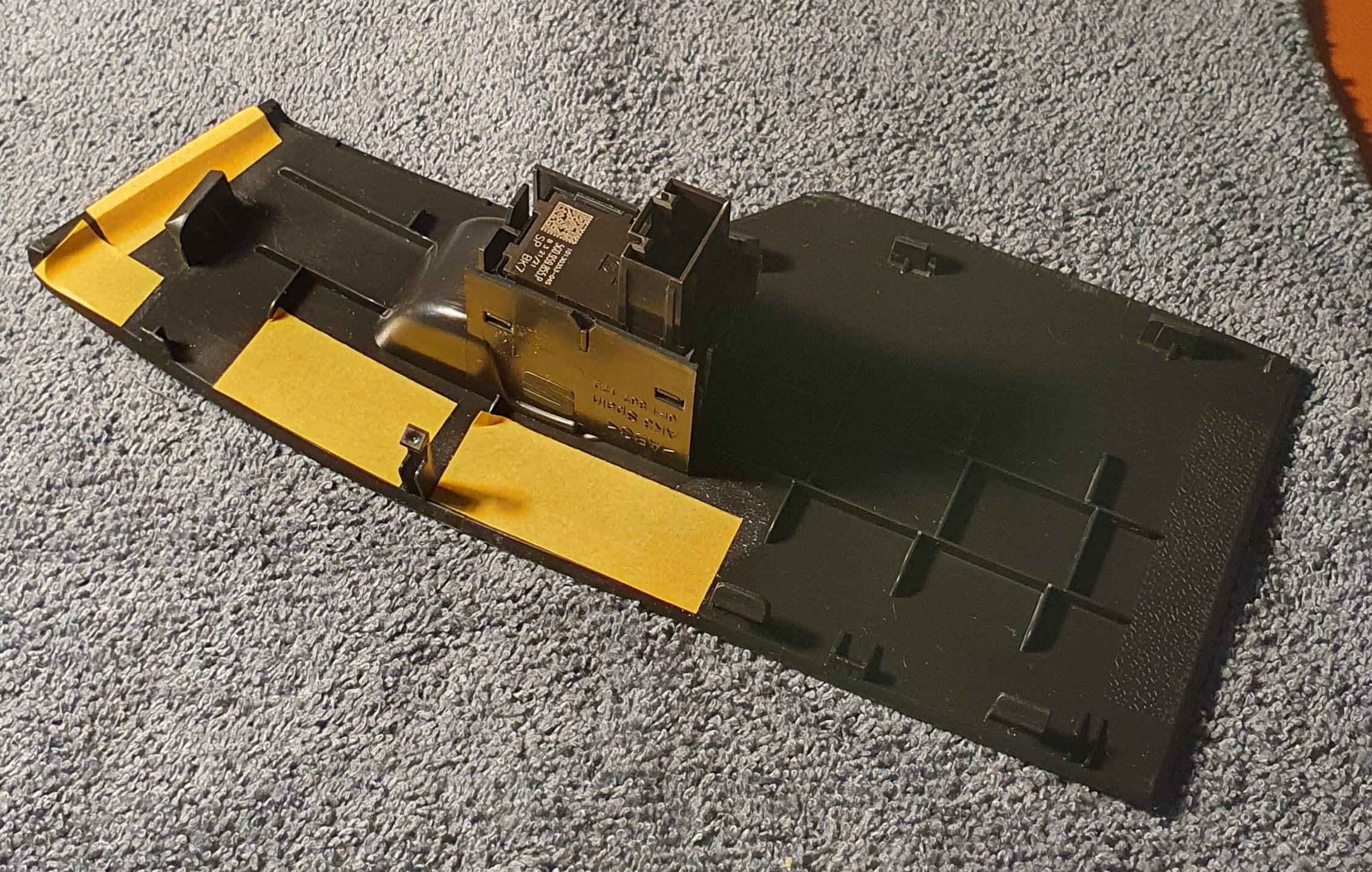

Hello Forum Members,

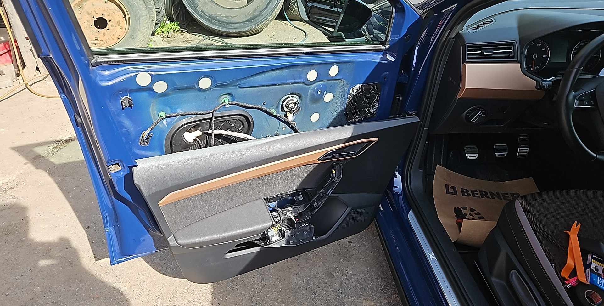

I have been complaining a lot about the various noises coming from my car since I bought it in 2021. It is frustrating that the problem has not been solved despite going to the service. As a result, I am looking for solutions to these annoying noises myself.

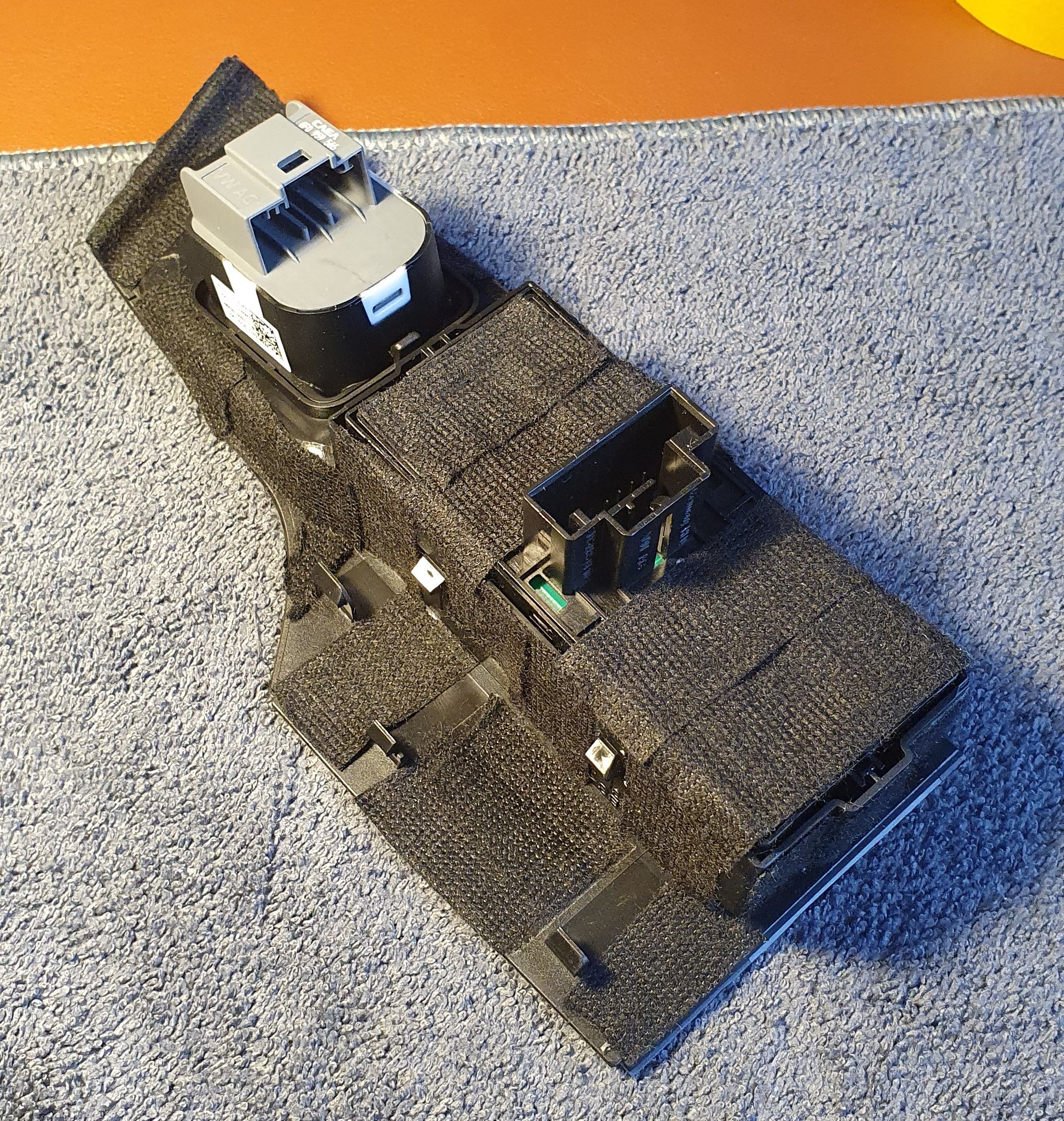

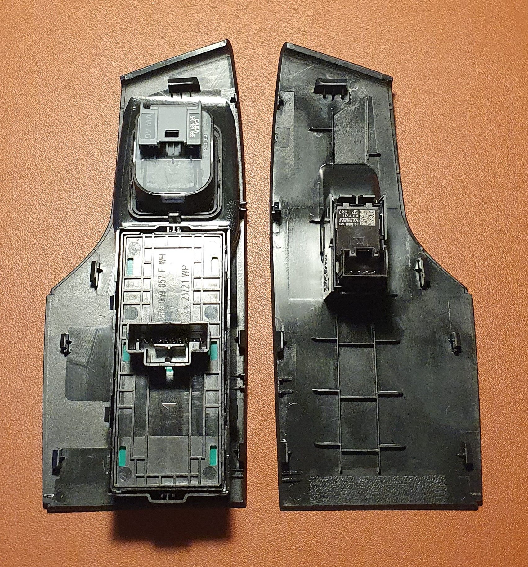

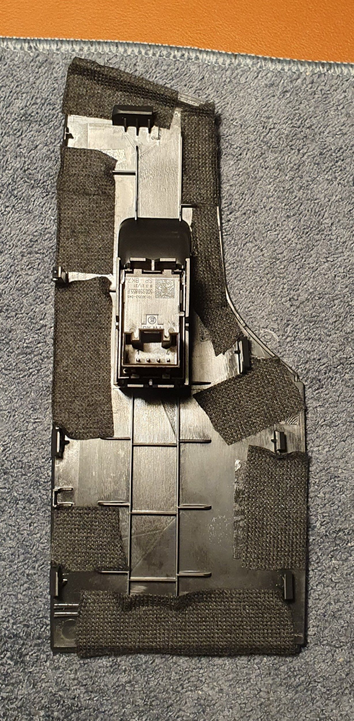

I started with the creaking noises coming from the doors. As you can see in the photos, I removed the window opening and closing buttons and stuck felt and fur-like coated tapes on the parts that touch the other plastics. I hope this will reduce the noise significantly.
I will share the solutions to the noises coming from different parts of the car with you in the coming days.
I would be very happy if you could also share the solutions to other noises in your car.
See you on the forum!

i've tried a lot of things, including silicone spray, but the sounds keep coming...
I went and tried a different car, a 2023 model, and there are no such problems with it, and it even feels much more sturdy the sound of the door closing is also very different in a good mean

yes, I used a product similar to killmat and applied a thin layer of closed cell sponge. although the noise has significantly reduced but I have not been able to stop these crunching sounds.

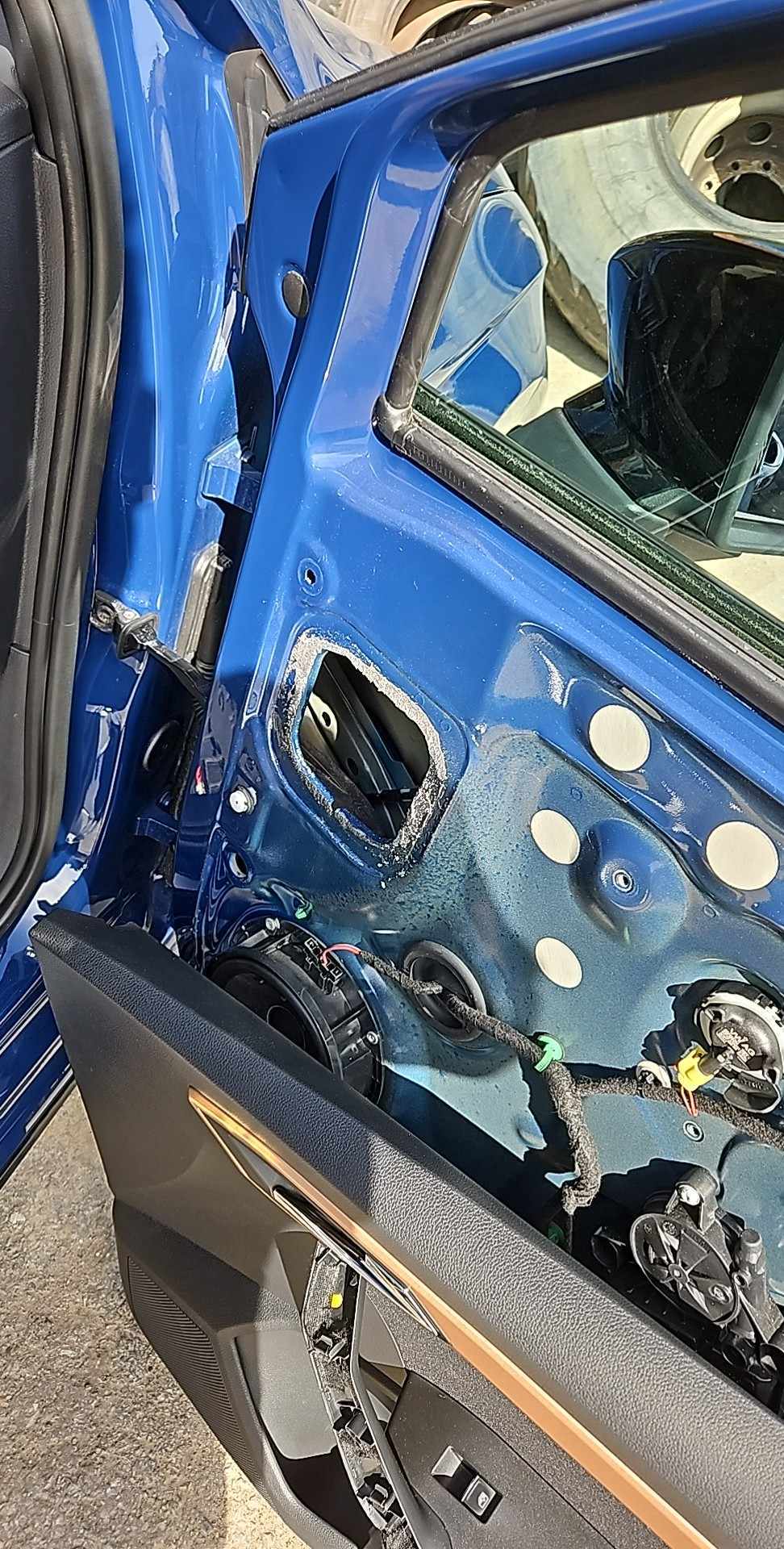

I would like to add that under the door upholstery there are some soundproofing sponges and they tend to peel off, which is why, for example, when listening to music, you can hear a rattling/creaking noise - you can glue it or stick a soundproofing mat above/below the sponge.
I peeled them off completely and replaced them with a soundproofing mat and glued sponges on the mat.
I'm attaching a photo of what it looks like
