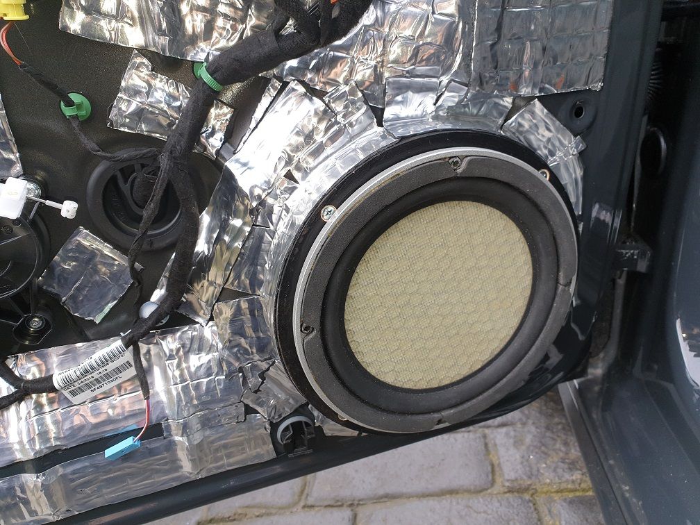

yes, 8" take advantage and go with 8's! I fitted 8" subs in mine but heavily beefed up the speaker mounting and deadened it thoroughly..

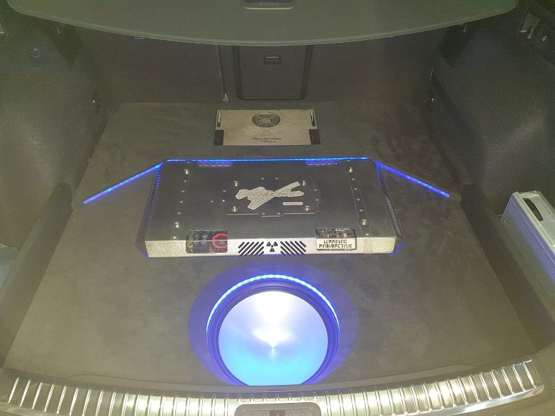

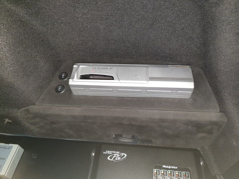

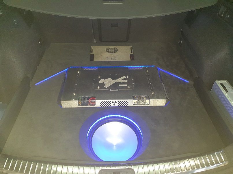

old school Phoenix Gold amps, head-unit power wouldn't do them justice! I've made a beauty panel to cover all the wiring and stuff and also it all fits below the original floor so still 100% practical.
PS- ignore the dodgy wiring, it has since been finished and mega OCD!

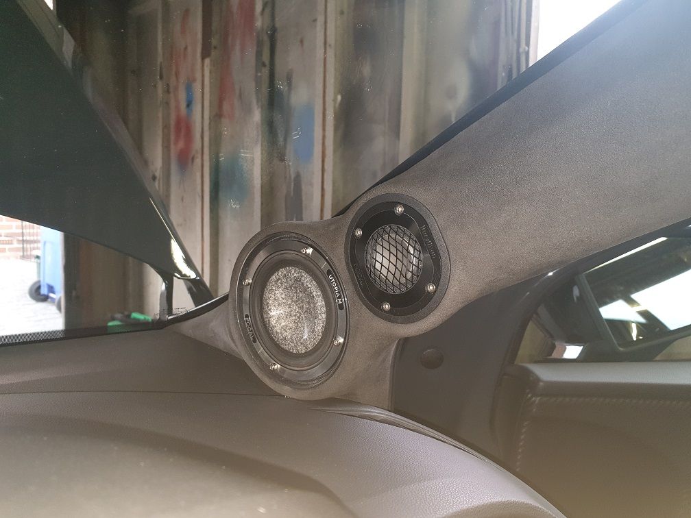

Looks amazing, are they custom pillars?

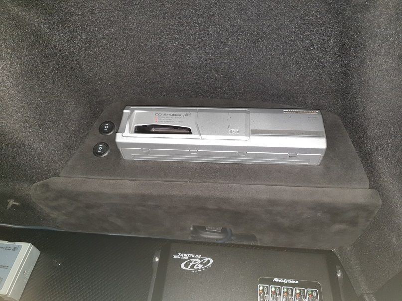

yes, kept the original head-unit but also have a CD multiplayer player hooked into it all too as still have about 500 CD's I can't be bothered to convert to SD card!
I made very good use of my 9 weeks of furlough though, I built the A pillar pods and also the beauty panel for the boot and CD changer build. I used some Alcantara suede I had left over from my previous Skoda build and it matched the Cupra interior perfect!
if you need any advice on anything audio related just ask away, been doing this mad hobby for 30 years now!

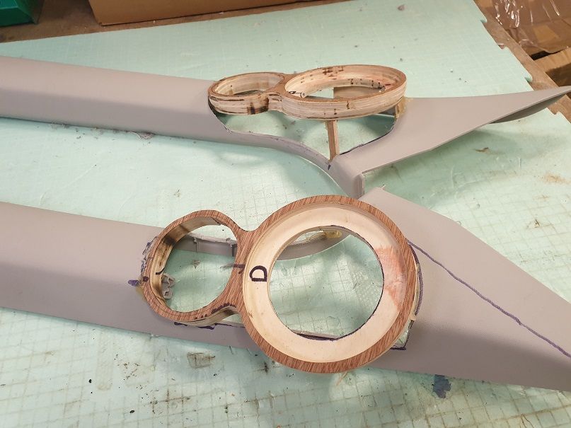

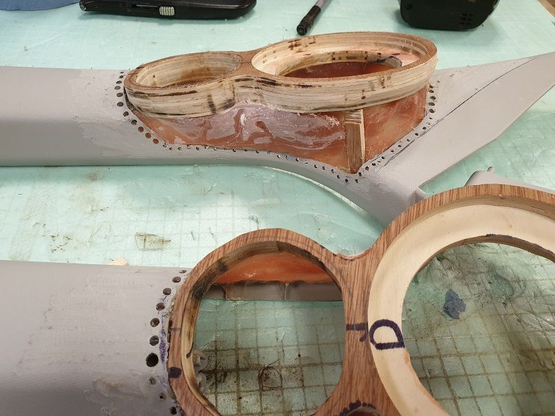

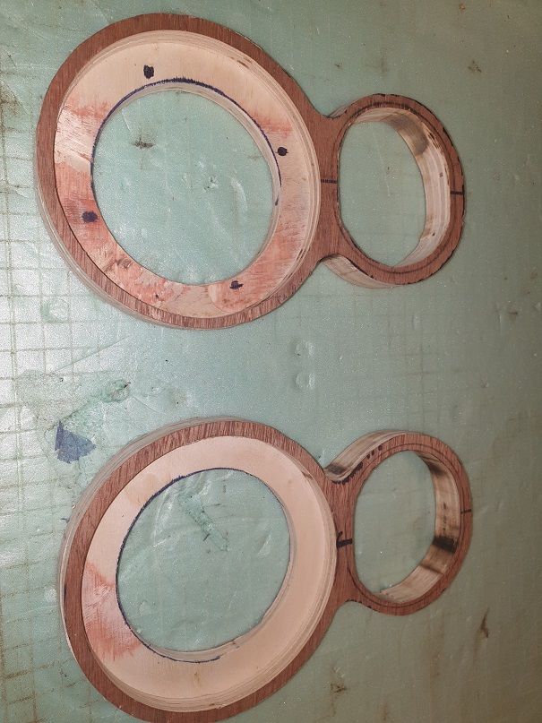

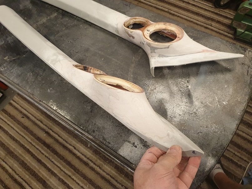

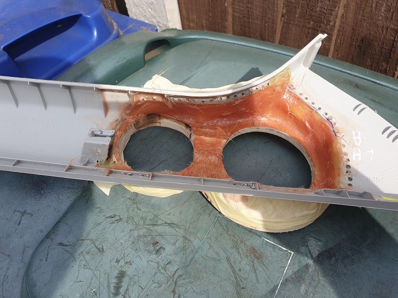

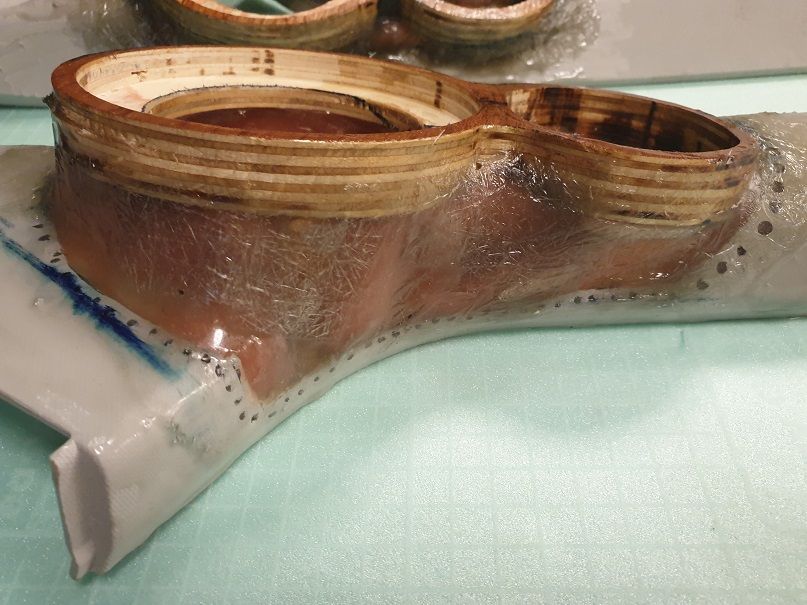

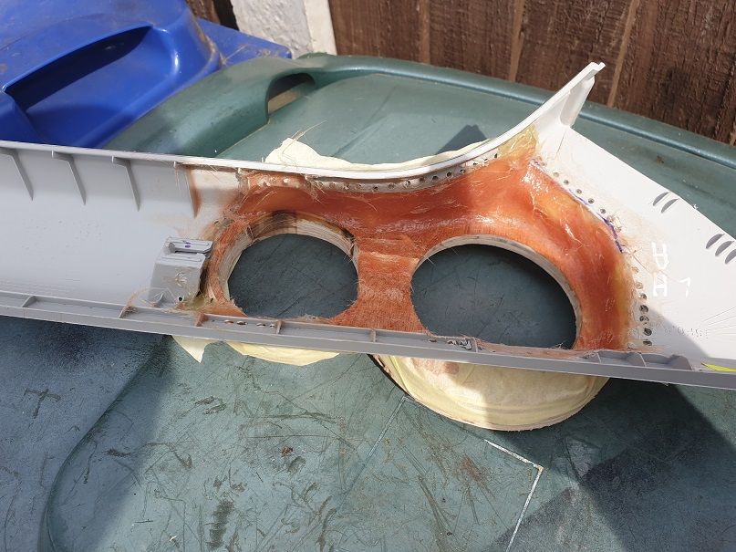

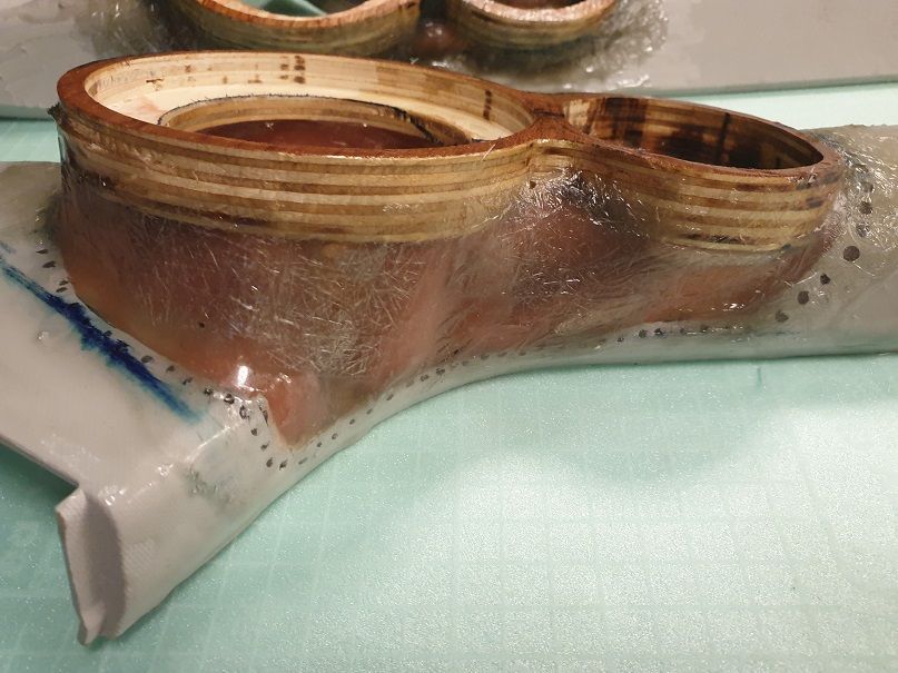

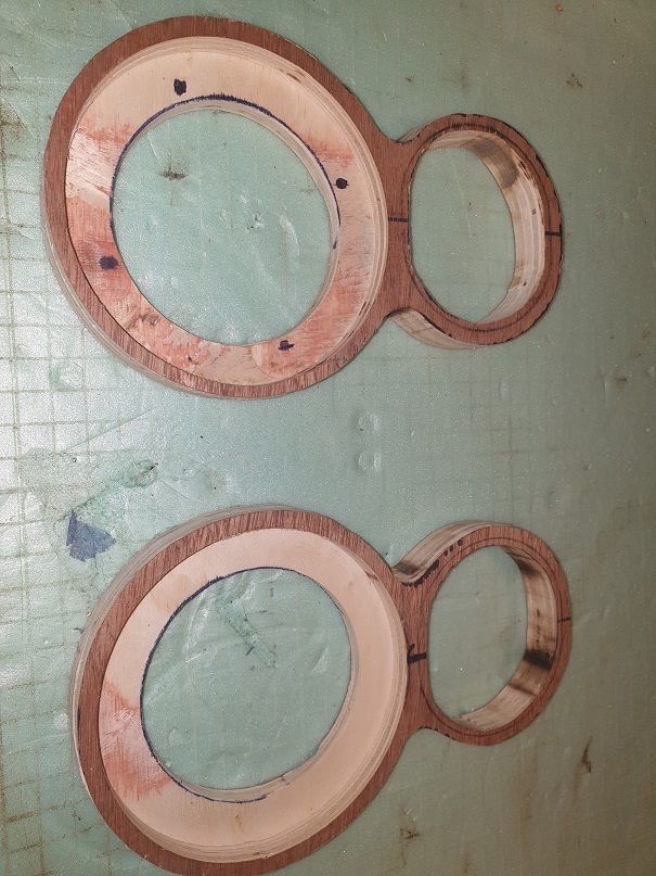

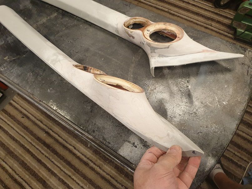

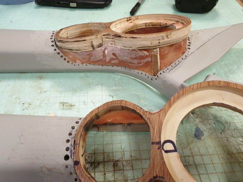

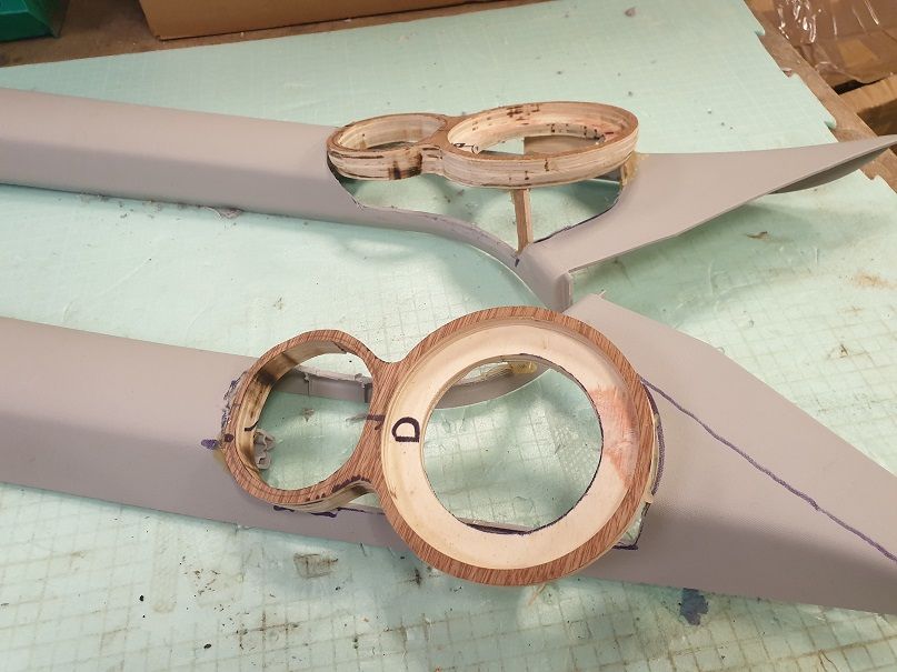

How did you build the a pillars to fit the speakers, it looks really good

Looks very good nice workmanship.
How did you get your sub in the boot sunken looking so nice.
What do you think of the vocal isu200 for the front and the isu165 for the back?
Sent from my SM-N770F using Tapatalk
can't go wrong with Focal, I've ran them for years, mainly the Utopia versions.
I built the sub/wheel well enclosure out of fibreglass, I cheated a little though as I re-used the enclosure out of my old Octavia as it has the exact same floor press!
