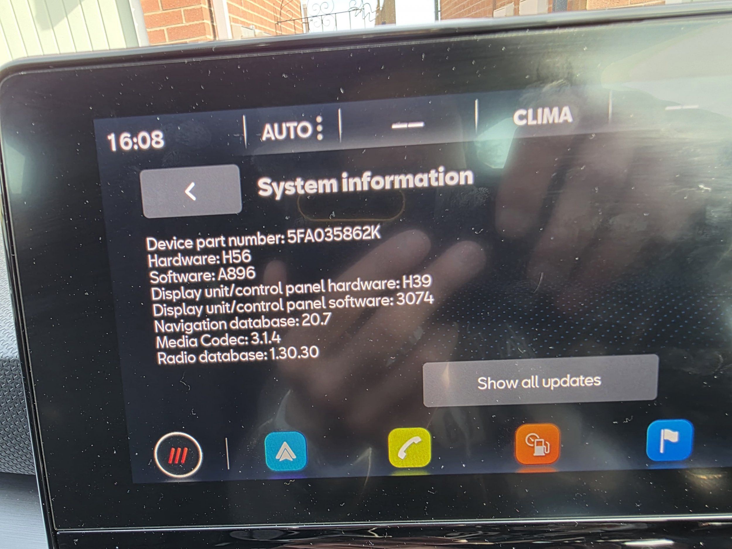

I just bought a Seat Leon FR TSI EVO 1.0L 2021 plate (MK4?) on Saturday.
I'm also experiencing pops and clicks while driving from day one, both on radio and playing music via android.
Though today, while driving someone new, on the motorway I noticed my location on Waze hadn't changed and the actual car location wasn't even on the road. Found a safe place to stop. I tried Google maps, same problem except it as warping forward and back to different spots.
Eventually I had to just disable the Bluetooth connection on and phone and just use my phone directly for directions as I was running very late from trying to fix the issue.
The SOS light also turned on my dash during all this. Luckily on my way back home after having the car off for some time, the SOS issue resolved itself. After getting home I tested the Android Play link again and it was fine though I'm very hesitant testing for longer journeys especially to new places.

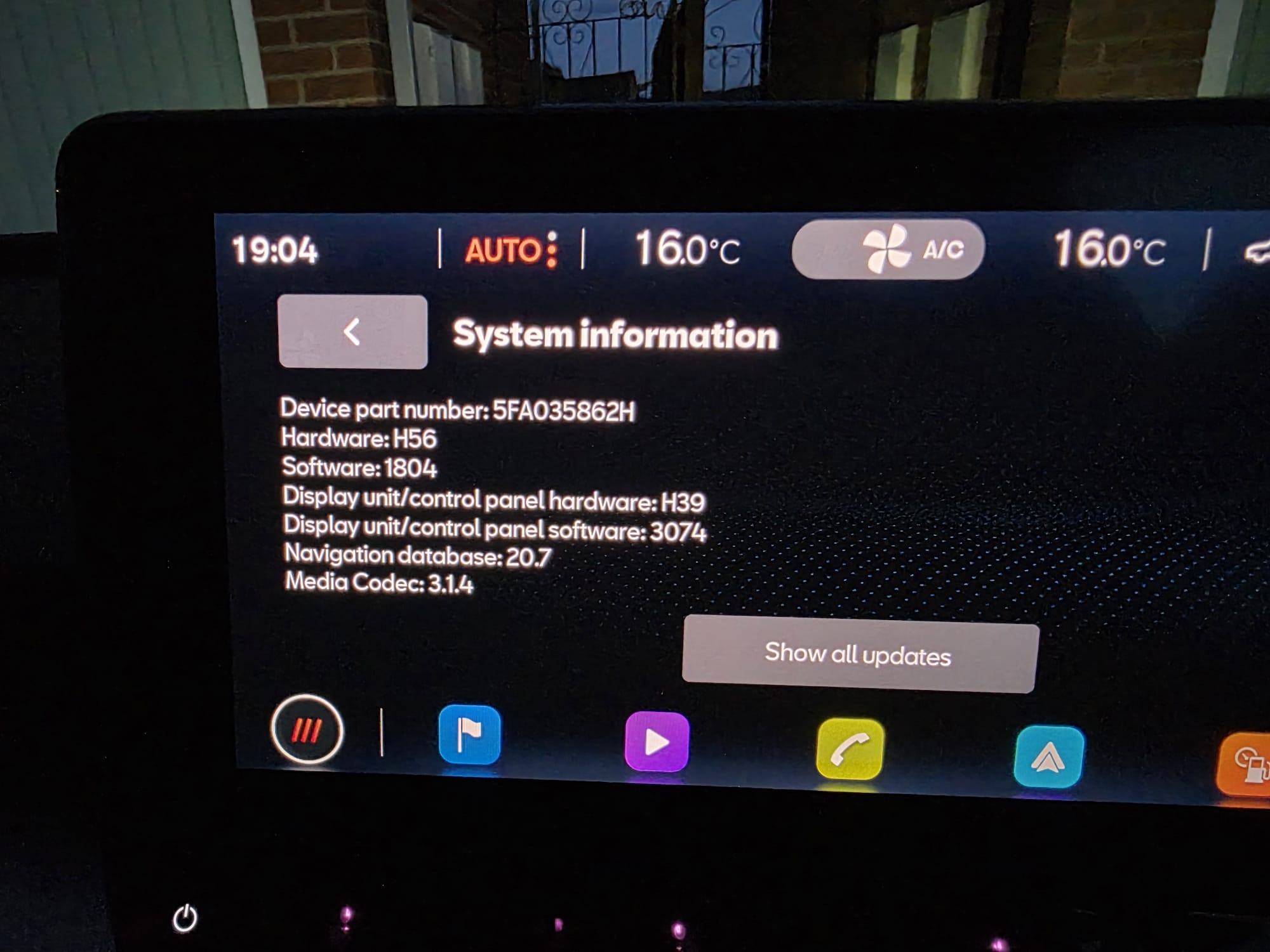

I do (I think) have the latest software, A896 that was performed over the air using my home wifi. Otherwise, it was previously 1804.
I will try to use the car in max privacy mode to see if it stops the SOS warning issues after seeing if it happens a 2nd time. Fingers crossed it doesn't
I'm all ears for any advice or wisdom. Thanks.

Good to know and thanks for the information. I'm I correct that my only option now is to take this car to the SEAT dealer to fix? Yeah the navigation database issue makes sense as it really didn't know where I was on the road until I disabled the Bluetooth to just only use the phone for GPS and navigation. I'll see about quizzing the staff at a local SEAT dealership especially if its not something I can resolve myself.
The previously owners weren't very tech-savvy and drove it very lightly, 14k miles senior couple.
After more digging the A896 a 2nd phase update step to then becoming 1896. I've got the voice control function back today after an update.
further edit, ahhh nice I can download it here:
Thanks again for the pointers @Tell I will dig some more.
