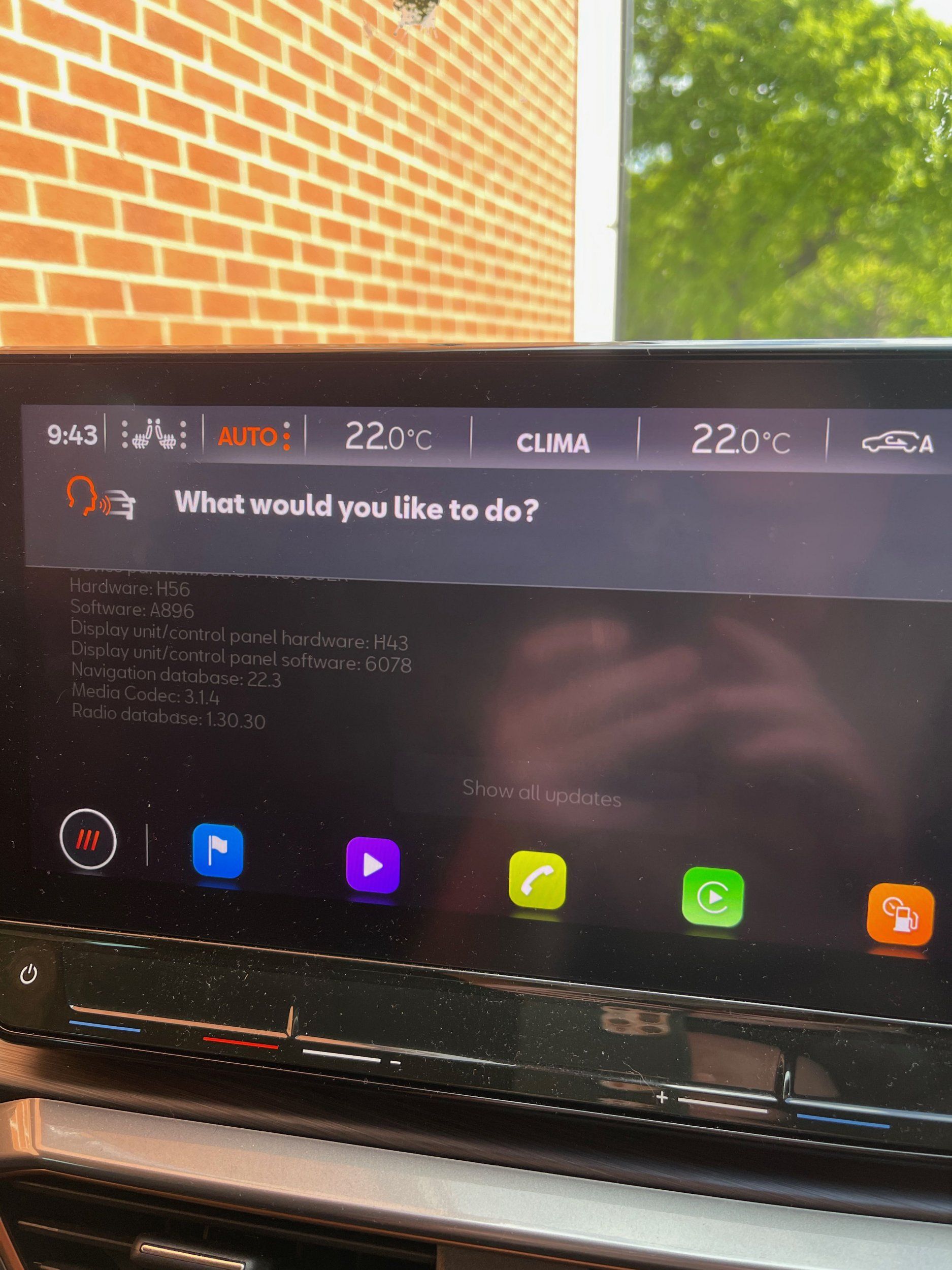

Not sure your second point is correct (about it being 1896 when fully updated OTA). I have version A896 and voice control back after second update - see below photo
It's been 3 days now with no further updates and still on A896 *with* voice control back again.
The full update will end up on 1896. A896 is the stop gap
