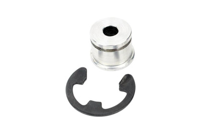

The advice I always read was to do only the front-to-back and not the side-to-side. I did the front-to-back with billet bushing and Forge big knob and absolutely loved it. Felt very mechanical and the heaver shift knob was a good addition. Shifting becomes way easier due to the added weight on the end of the "lever"
Solid shift bushings
The short shifter
Comparison
New shifter in place
Forge Big Knob
The short shifter
Comparison
Forge Big Knob
Thank you so much! Looks very clean and that’s what I wanna do. I updated my eBay watchlist for that shifter and I’ll get the shifter bushings too. Nice one. It’s annoying I’ll have to take it apart a bit to check what billet sizes I’ll need. Last year I got a new oem gearknob to replace the worn one so I’ll keep that stock.
