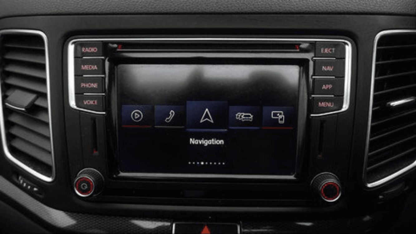

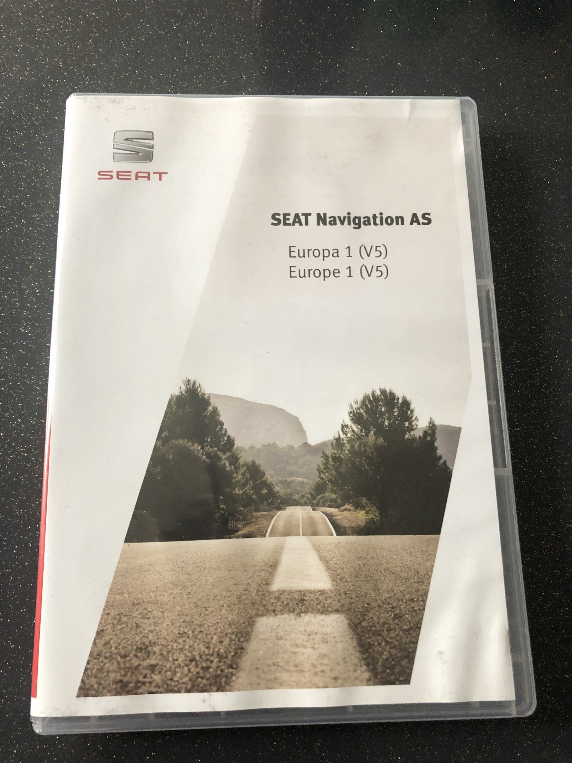

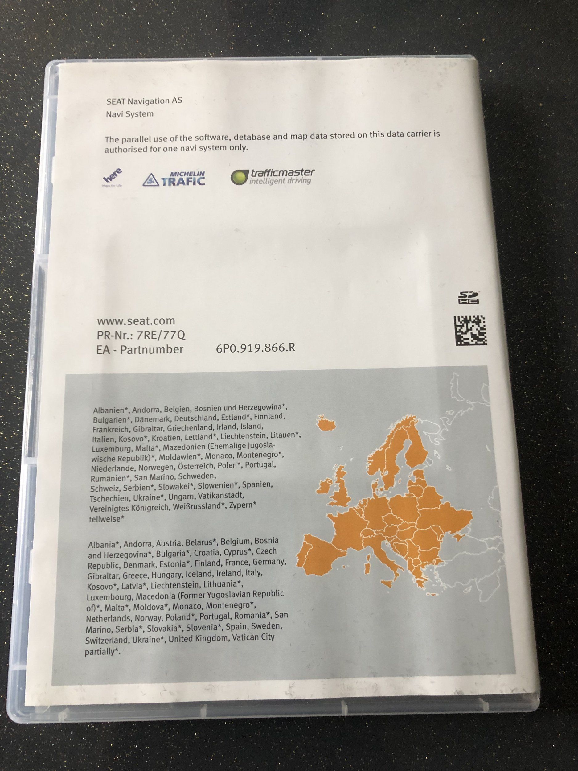

Hiya. Thanks for the reply. I was trying for hours last night and never got very far. Below is the unit we have. There was an empty sat nav box in the car when we bought it so I’m guessing it was activated at some point and I have a 32gb card of from what I have read it may not be able to be used. Hopefully you might be able to give a bit more of a paint by numbers answer if possible please. If I have to buy something then so be it but I don’t want to waste money on the wrong thing.
thanks for your help

The 6p on the back of the box means it's a mib2 standard those graphics fall in line with that.
You just need to get hold of a Vag card. I'd treat yourself to a 32gb Skoda card. I bought one last year to test out. Skoda announced that the all European map was breaking the 32gb barrier soon so did it to experiment. This year people have been buying them for the latest 1730 release.

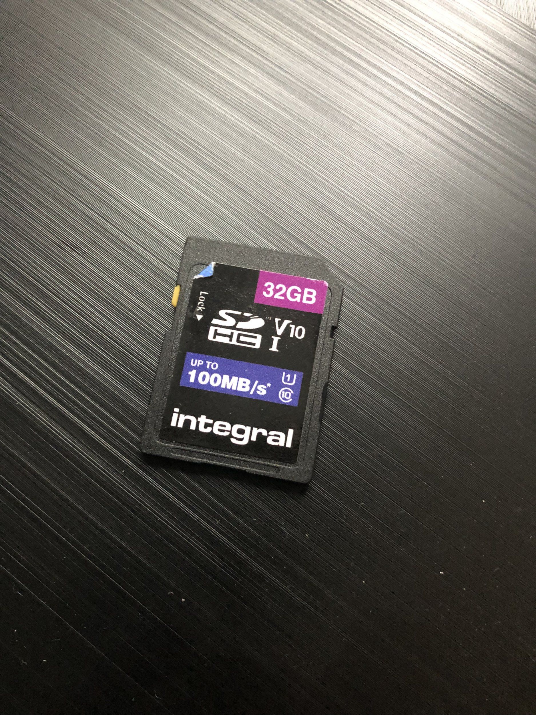

Well I got the Skoda card from the lovely online auction site but took a week to come but slotted in and worked straight away.
Reactions: Tell
