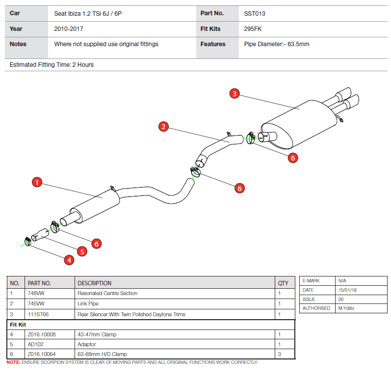

Hey all,
So I just bought a new scorpion exhaust to fit to my Ibiza, but when ive gone to check if the adapter provided fits on the cat pipe, its way too small. The diameter looks to be about 55mm but the adapter is about 48mm. Even the clamp provided (part 4) is too small to fit over the adapter anyway. Am I missing something here. As far as I know, the adapter is meant to go over both pipes, from the cat to the new resonator and then be clamped tight.
The part(s) in question are part 4 and 5 on the diagram attached. If anyone could shed some light on where I may be going wrong please do because i'm both confused and annoyed that the part doesnt even fit (from what I can tell).
Cheers

It looks like form the assembly drawing and parts listing, that they expect your existing part of the exhaust is smaller than the beginning of this new exhaust, I'm saying that as the adaptor as shown looks like that and its front clamp is a "43>47mm" one and the rear clamp is a "63>68mm" one.
Have you measured the O/D of the front pipe at the point where this new exhaust fits on to it?
Is this one of these situations where it only fits the earlier 12.TSI 8V engine and you have a later 1.2TSI 16V?
Edit:- have you checked a VAG parts listing to see if the early and later 1.2TSI engines joining sleeve for that point are different?

Hey,
Yes, I believe they are expecting the existing part to be smaller since there is a fair bit of gap when I insert the adapter.
I measured the O/D with a rule for a rough estimate, came out at around 54/55mm, but I can get my vernier callipers to it later if it helps for an exact figure.
The adapter O/D measures in at about 47/48mm, so I can't even get the clamp provided (43-47mm) around it, even if it did fit.
Everyother part fits, but just the adapter and clamp to actually join the exhaust to the cat doesn't from what I can tell.
Not sure about the VAG parts listing. Could you point me in the right direction. If it helps I know my engine code is CJZD.
Appreciate the help.

I've already bought a new or NOS VW Group sleeve for my wife's 2015 VW Polo 1.2TSI 110PS, ie CJZD, and it's "relaxed" inner diameter is 56.3mm - so that ties in with what you have, so either you have been sent the wrong joining sleeve or that exhaust is for the earlier engine, though if you have a suitable tapered sleeve that would probably work, very very annoying!

Yup, earlier 1.2TSI 8V engine has a "45 X 95" joining sleeve, later 1.2TSI 16V has a "55 X 95" joining sleeve.
Edit:- so it looks like you have a 45 > 65mm tapered adapter sleeve when it is a 55 > 65mm tapered adapter sleeve that you need.

Ah okay. Thanks for that. I'll get in touch with scorpion and see if they're willing to sent one out to me. If not I'll just have to buy one.
