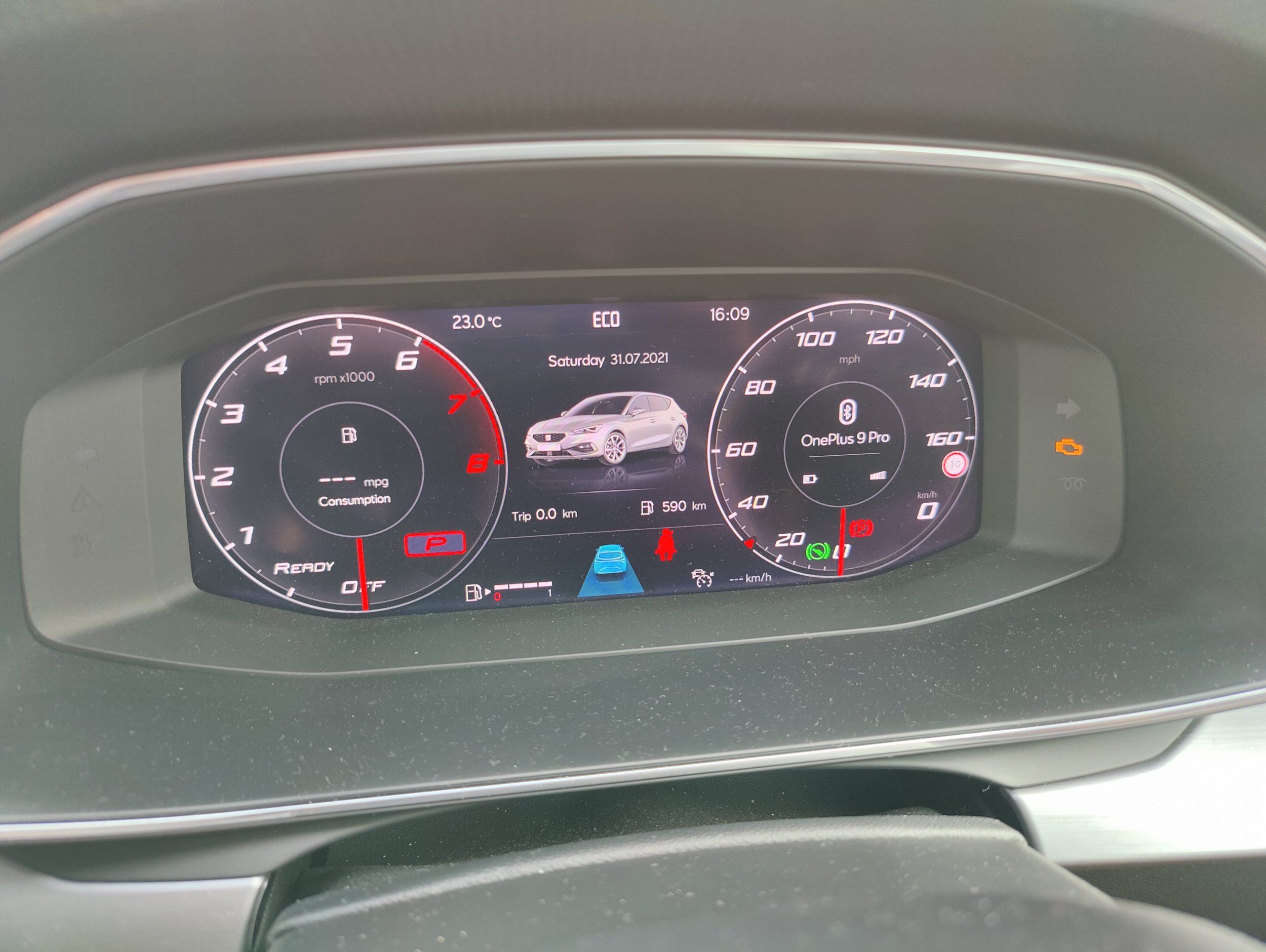

I have a issue with kph and PACC. If you restart the infotainment (touch button for 10 seconds) while the ignition is on the car starts reading mph road signs as kph and converts them into mph. The best fix I've found is to turn the ignition off and back on.
Pass 30 mph sign
Car reads it as 30 kph
Sets PACC to 19 mph

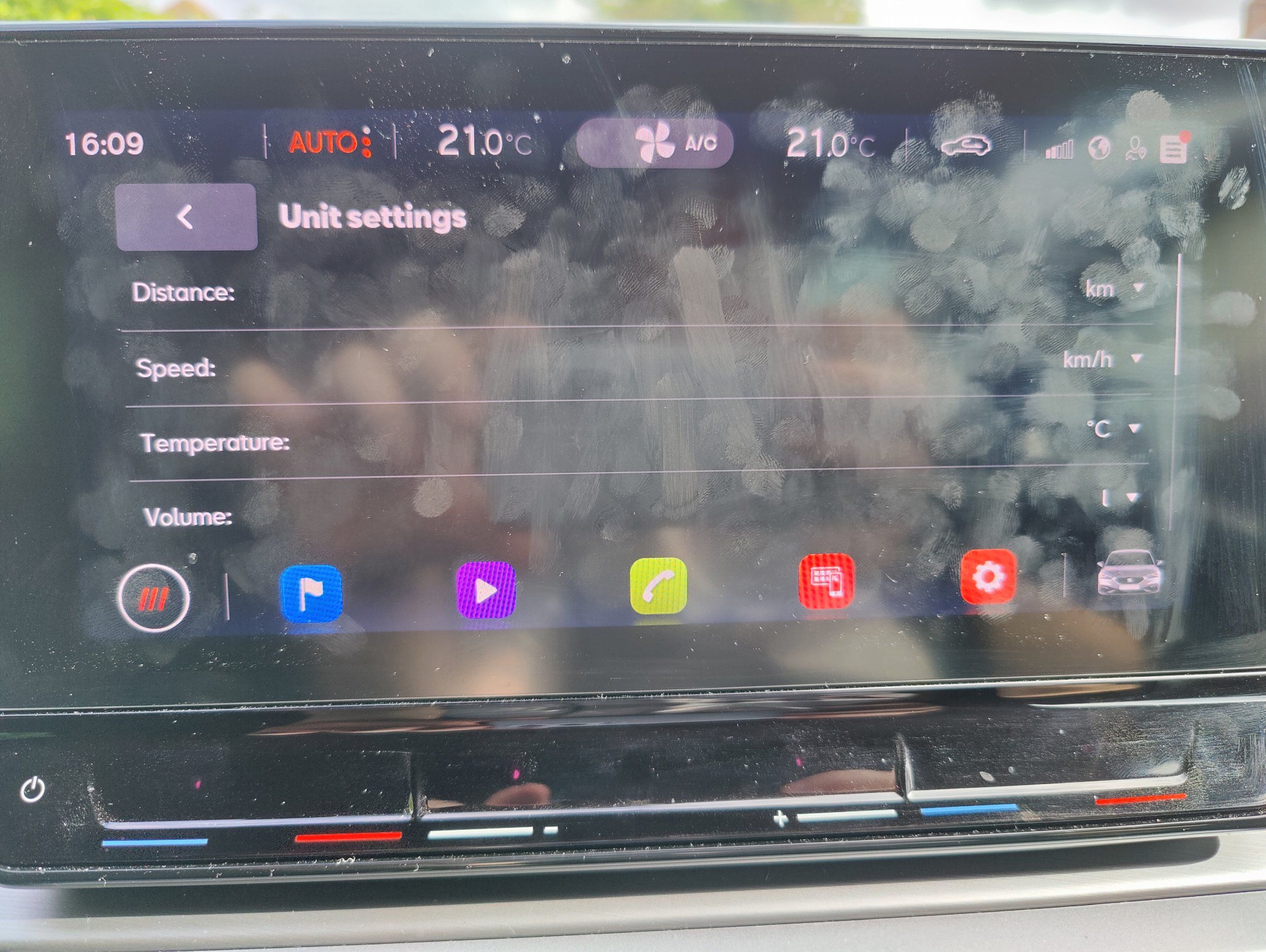

There is a units menu in the infotainment settings. It changes the dashboard too but not the dial view (dial is still in mph)

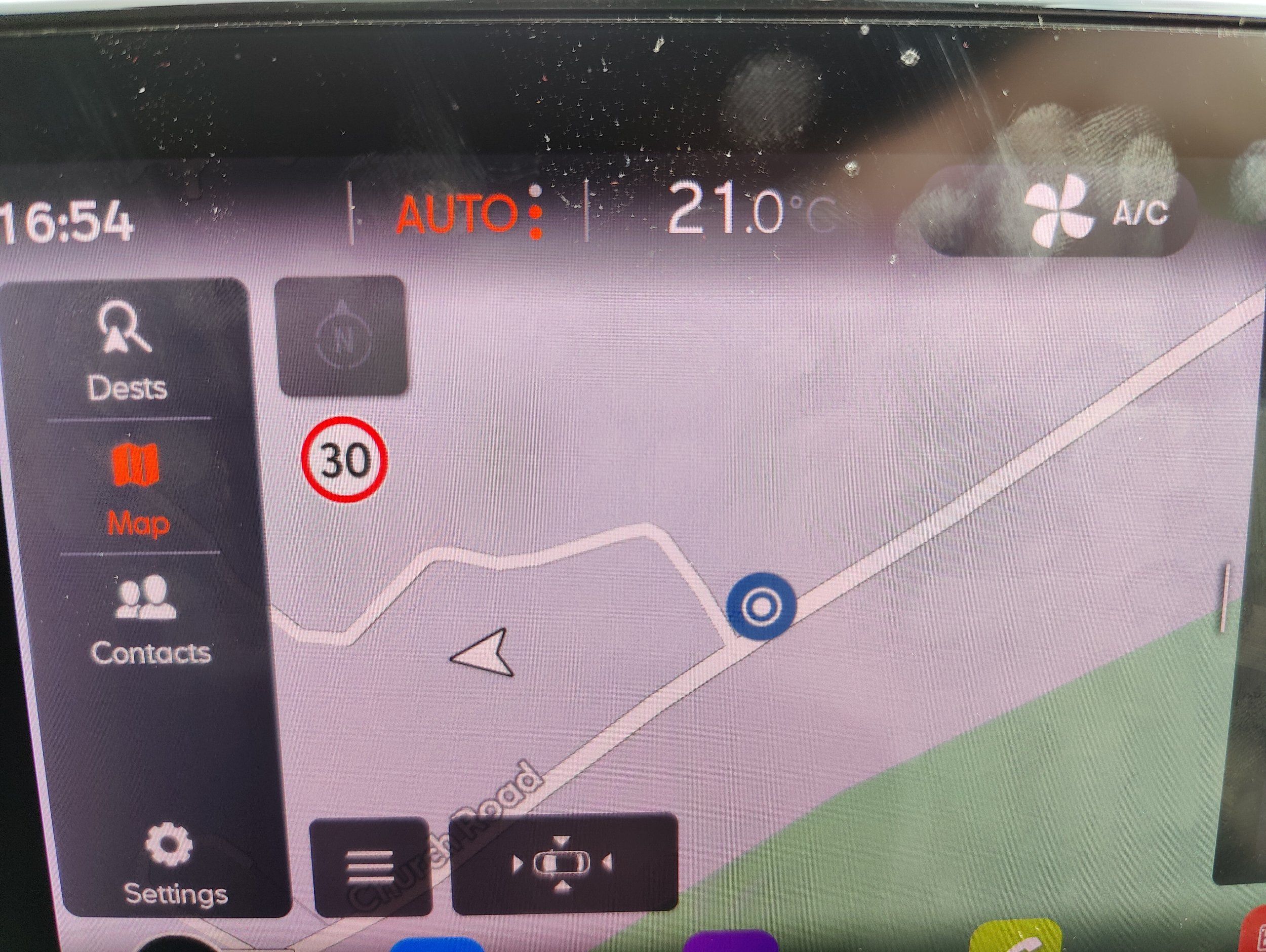

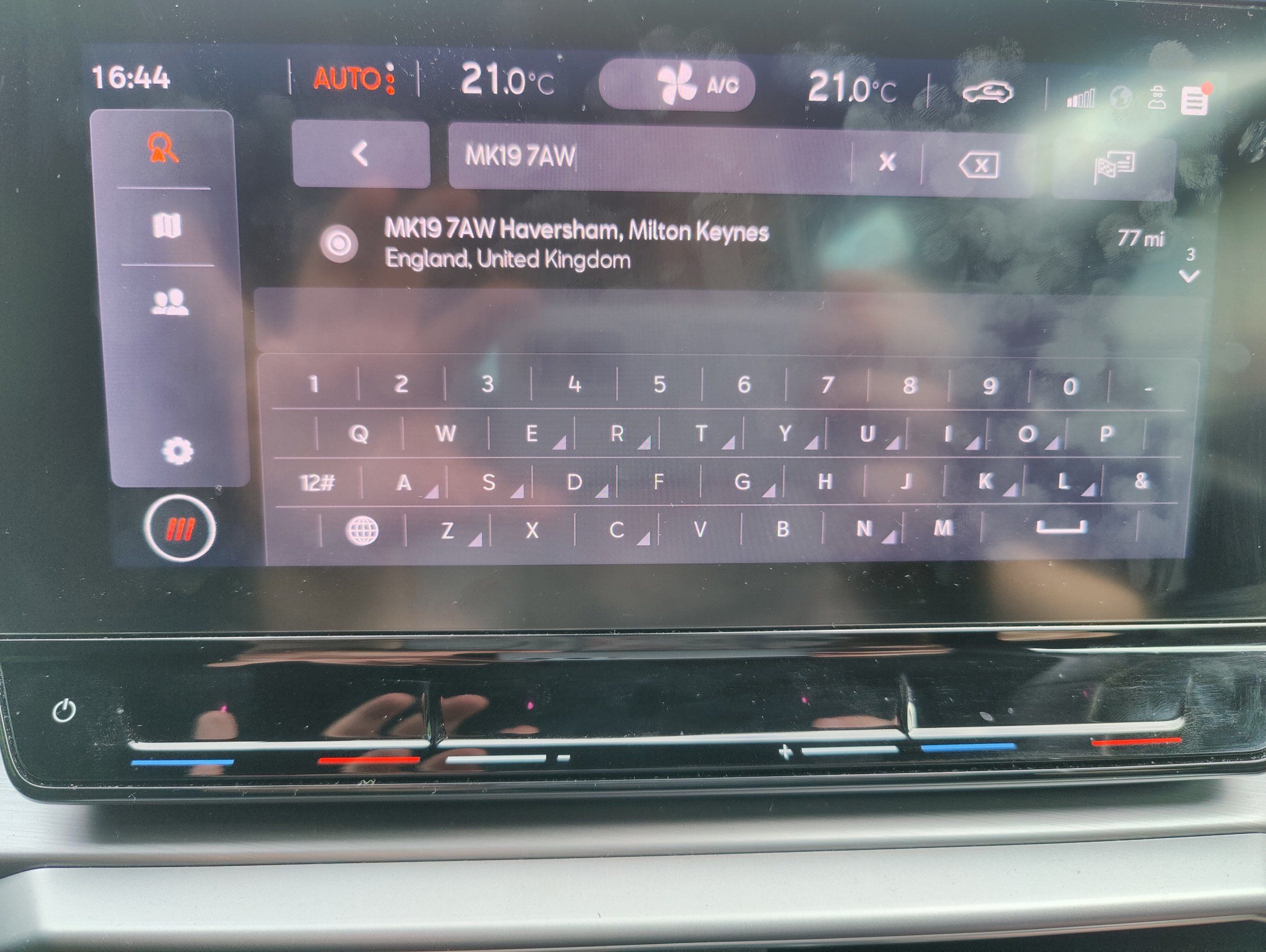

Reckon you should try a range of postcodes on a residential road with a bend in it to fully test it. Like roads with crescents.
MK19 7AN
MK19 7AW
Could be candidates for pushing the coordinates off road. Reckon they would be for people with the issue. Two arcs of a crescent road.

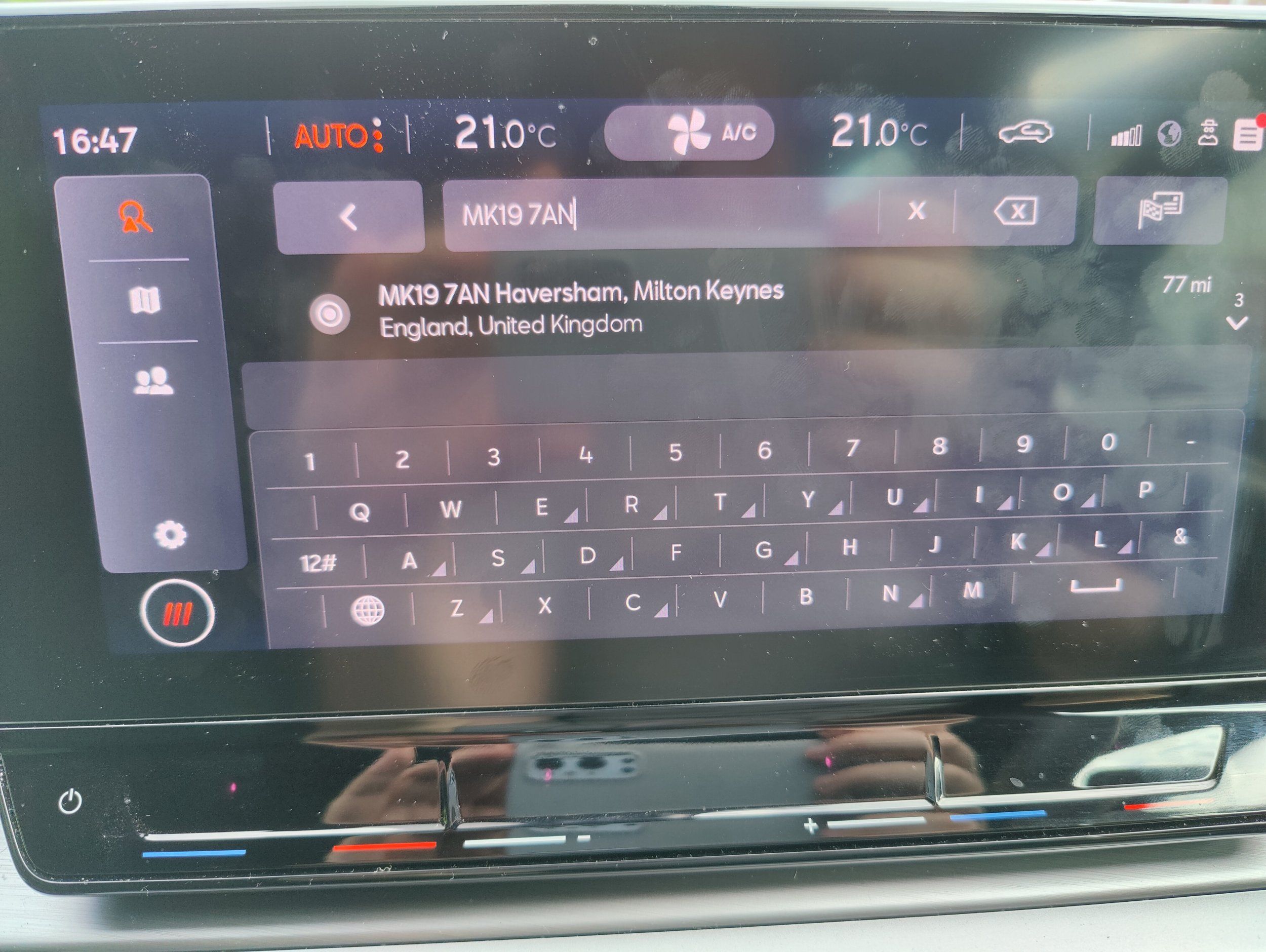

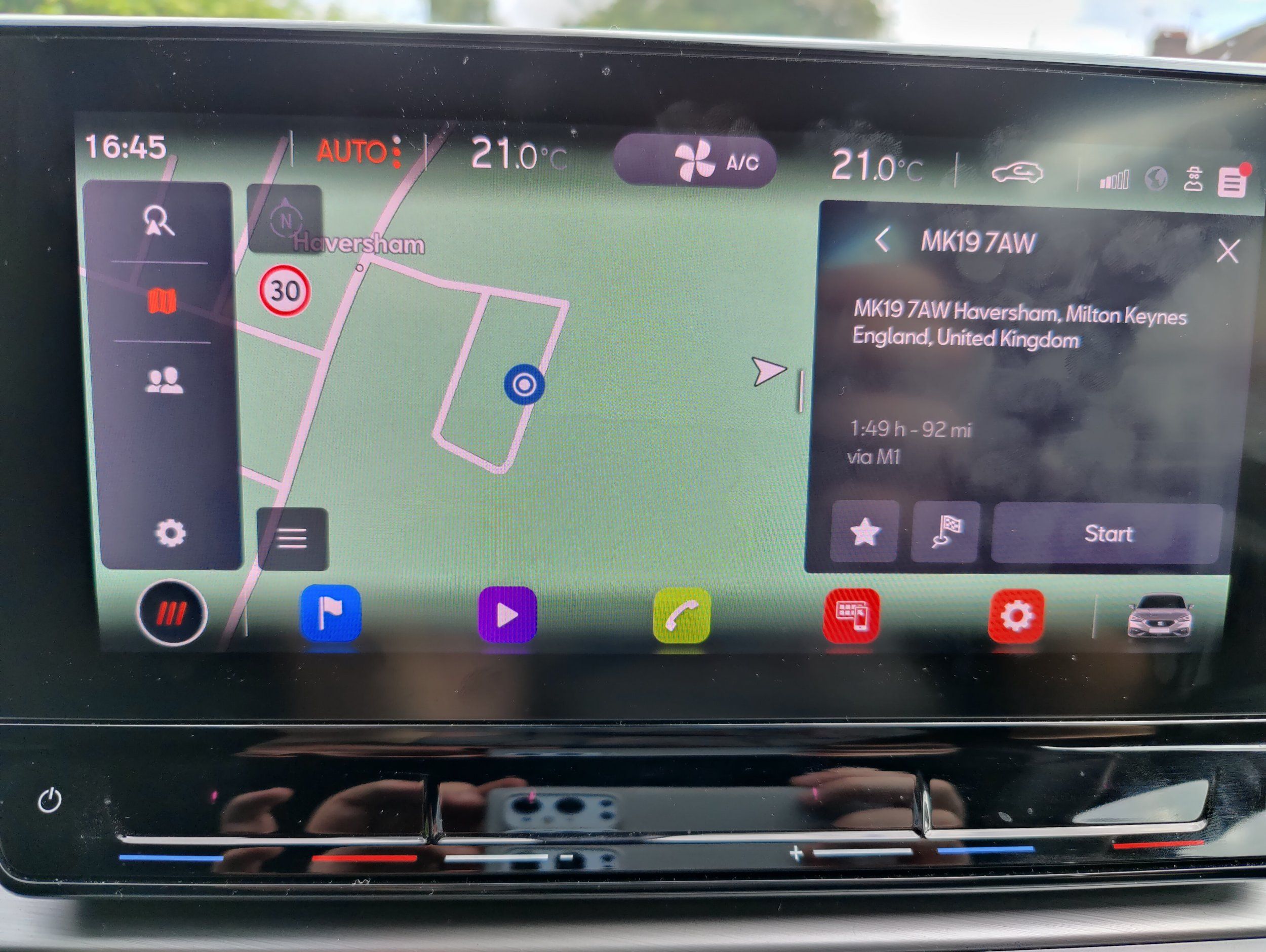

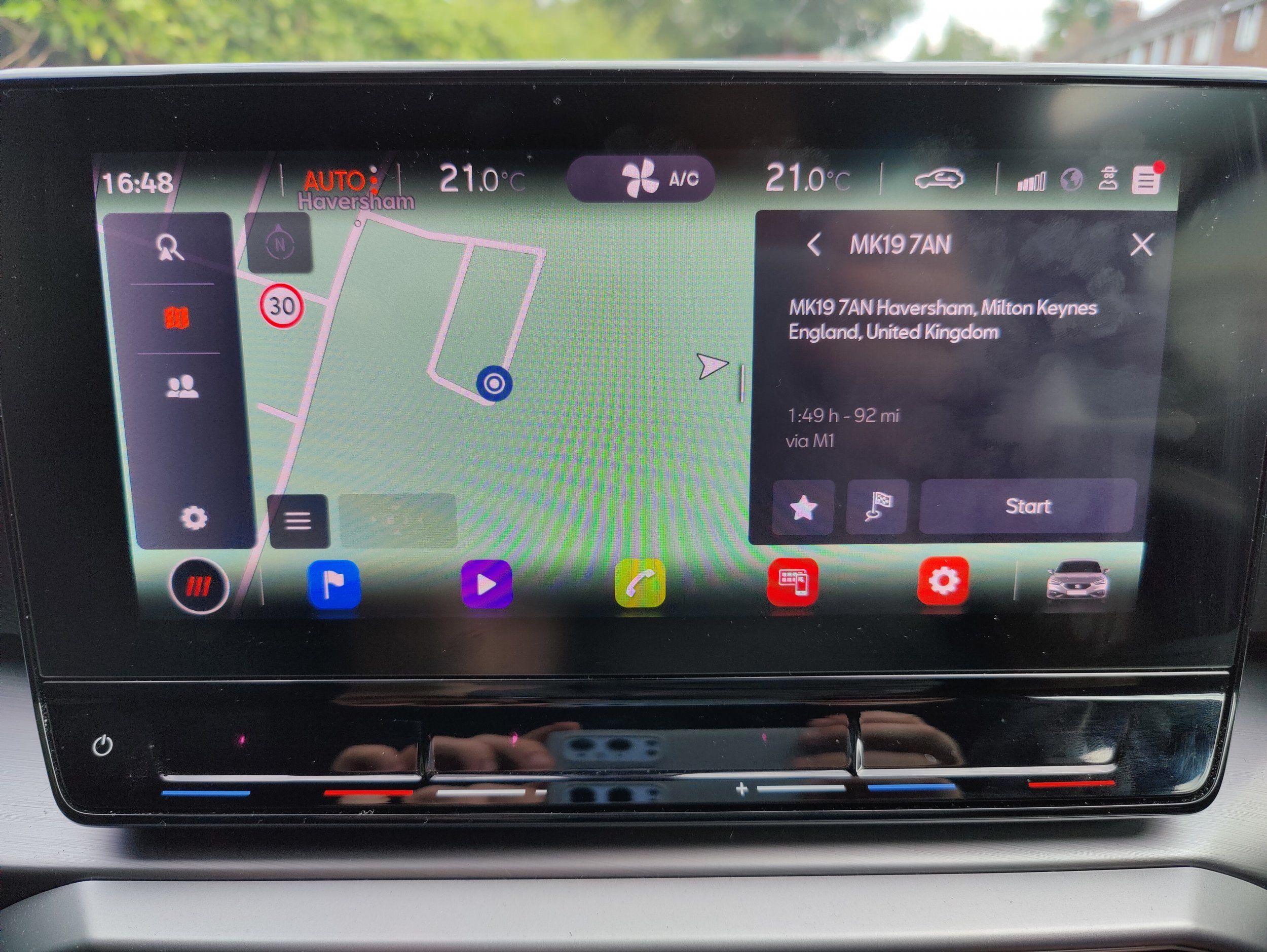

Tried in guest with max privacy
For MK19 7AN I got this
MK19 7AW this
Tried with a few local postcodes, it always seems to take you to the road than the actual location (where the contacts icon is)
)They might be doing it better now. AW one should be on the top bar, the other post codes run on the sides and bottom. I guess they have sorted out their processing now. Those are residential ones.
Business address postcodes (large user postcodes) which only have one point on the map I could see they could show you the point but the Here Maps road anchor that relates to it. Business POIs get the blob and the anchor point on the road.
Residential addresses with house numbers share the post code but if street numbered get their own anchor on the house number.

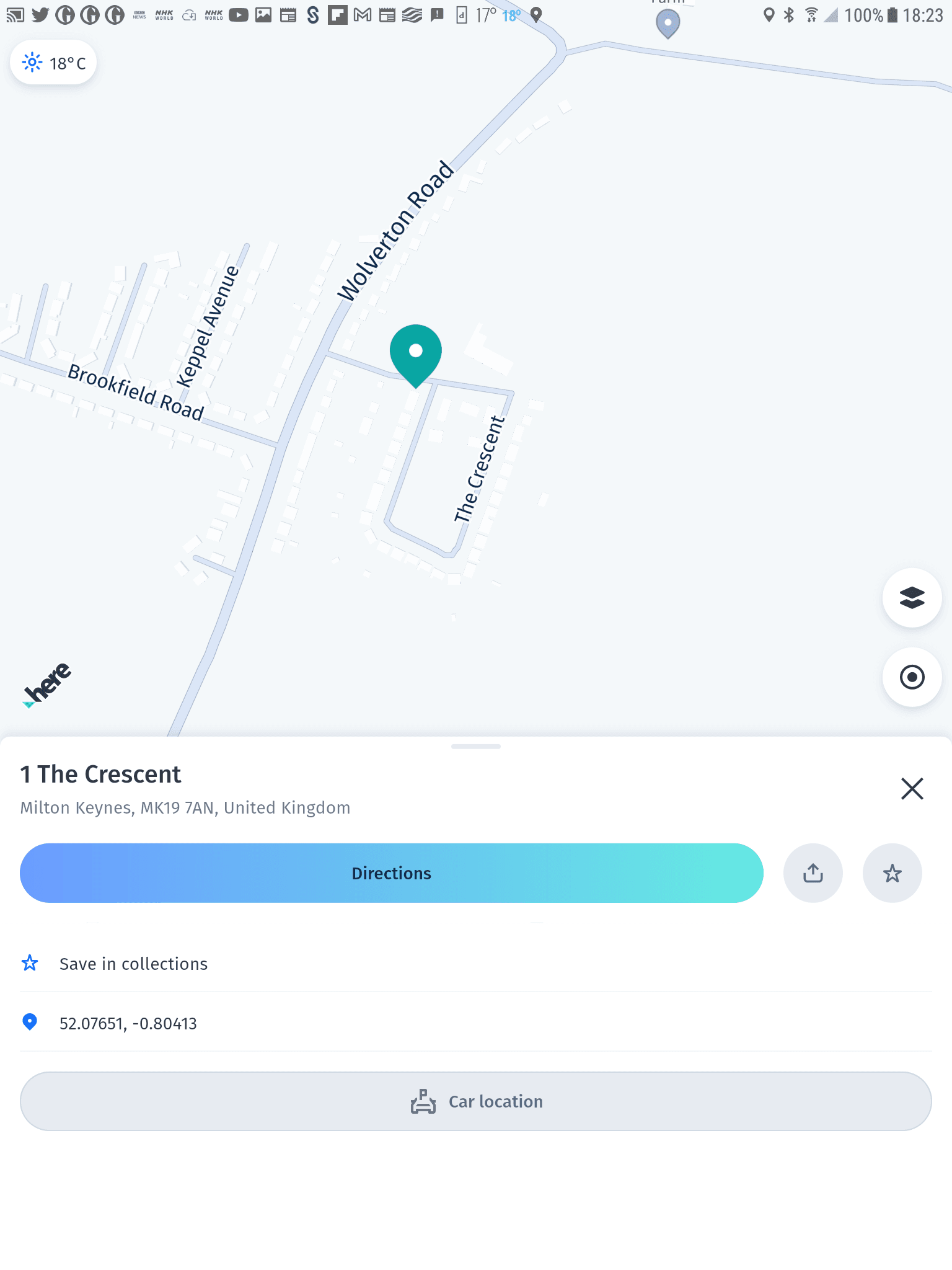

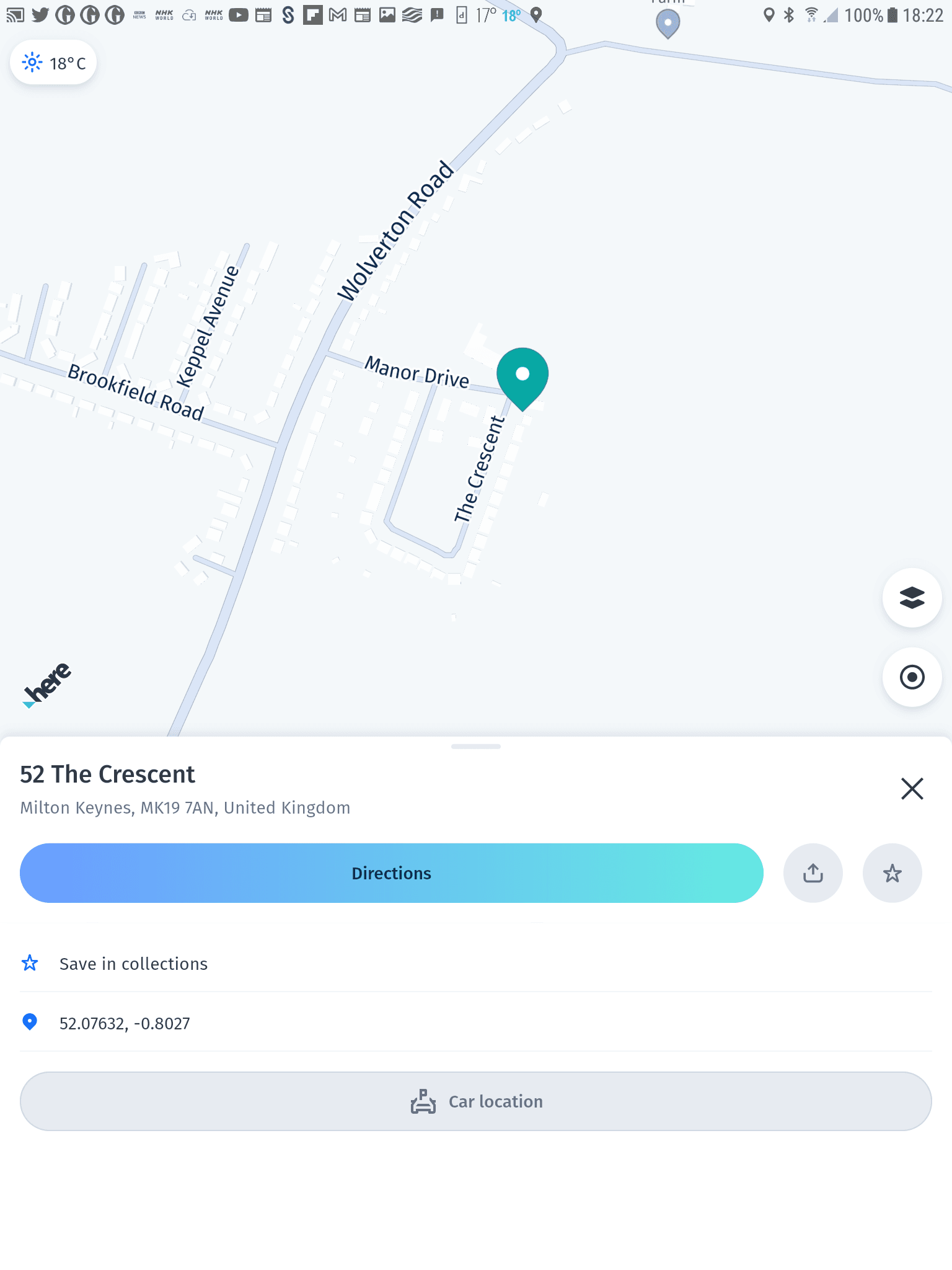

In this example if they have implemented the Here Maps data if you tap in 52 The Crescent MK... should put you too right of the ark. 1 The Creseent MK top left. As attached. That's the Here Maps data that tallies with the OS Local Authority planning map which shows the house numbers.
That's why I always say use the house numbering if you can rather than the postcode. Business address (large users) always only have one so that doesn't apply but residential address share postcodes.
To make postcodes work alone they have to be placed on the segments of the road. Clearly some of the ones reported early didn't.

Your kph issue must be that after a reboot it's not re reading the cars other system(s) where the mph setting is picked up, unlike the mib2 (I think). I only see kph before I start it then they revert to mph.
