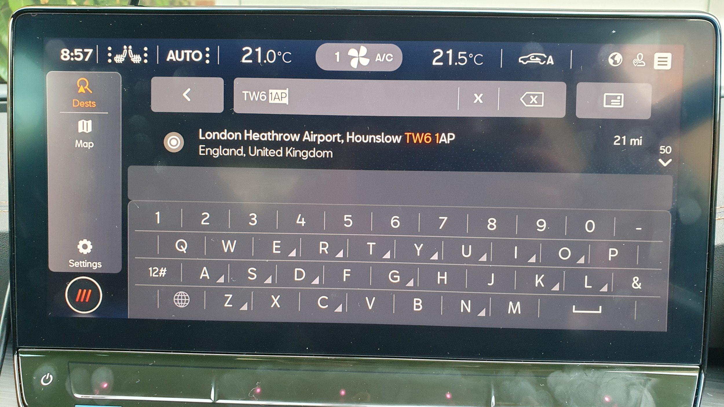

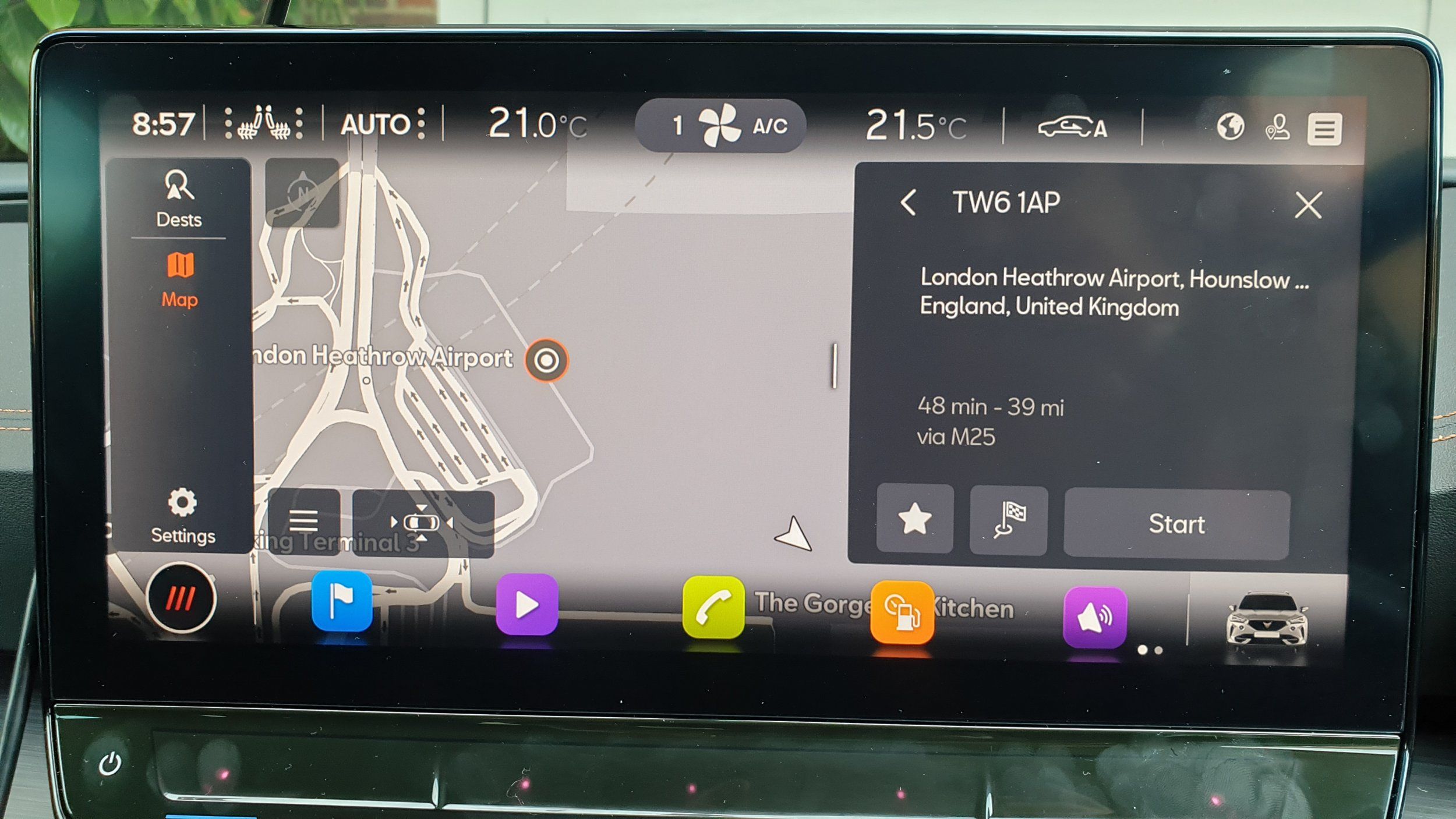

I have been looking at discussions here and on other VAG forums and comments were made about privacy settings and connections (the little world icon needs to be not greyed out). So I joined SEAT Connect, added myself as Primary User (which reset virtually everything on the car :mad::rolleyes:) and now have a globe lit up and have changed Privacy to the lowest level possible.
The net result? I can now get actual locations when entering a postcode BUT only when the first characters are entered. So using the example from Agnes.Surrey, I can type "TW6 1" and get a broad destination (Hounslow?) but if I type "TW6 1A" I lose that and get a message saying that it is not recognised and asking me if I want to go to "step-by-step input" which seems to require all the details of the address to be entered manually; if I enter the full postcode I get the offroad coordinates.

Agnes.Surrey
Nov 6, 2020
772
420
Surrey
Navigation is in the car and it should work. Also, problem doesn't seem to be tied to certain version of software, because it works for some people and doesn't for others. I would be really unhappy, if I collected the car and it couldn't recognise UK post codes. It's not 15 years old Mercedes that wasn't able to read whole post codes. We're in 2021.
