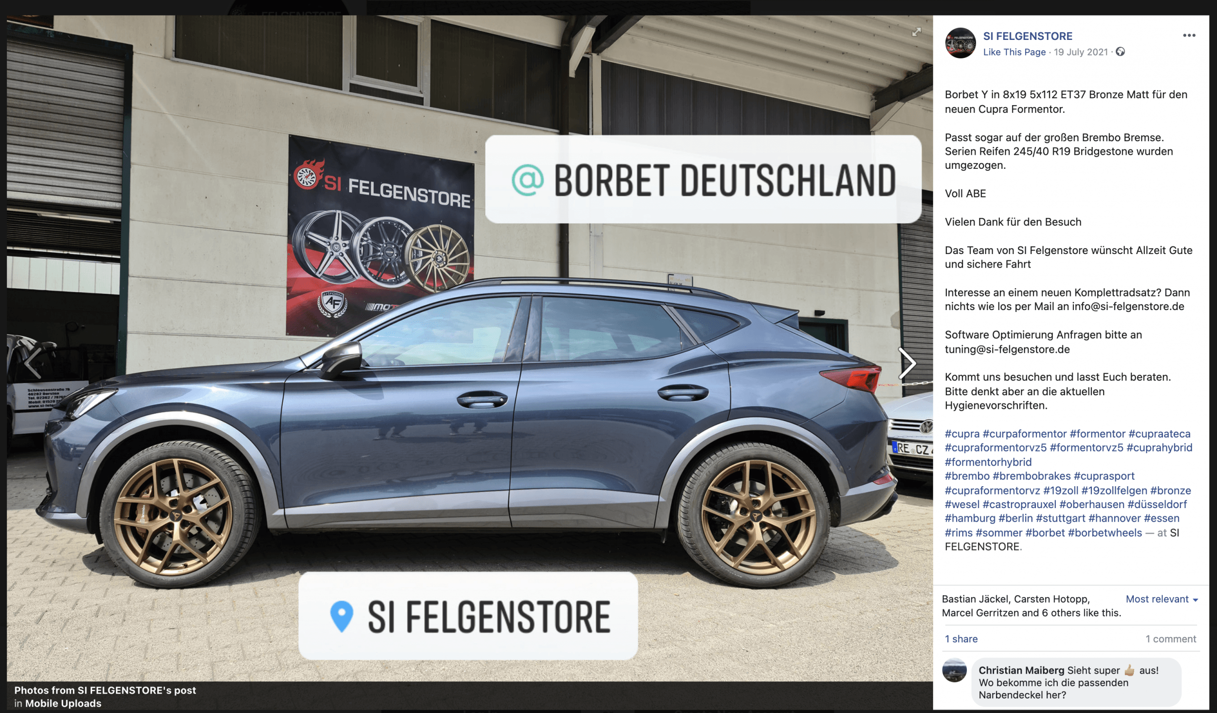

Borbet Y in 8x19 5x112 ET37 Bronze Matt

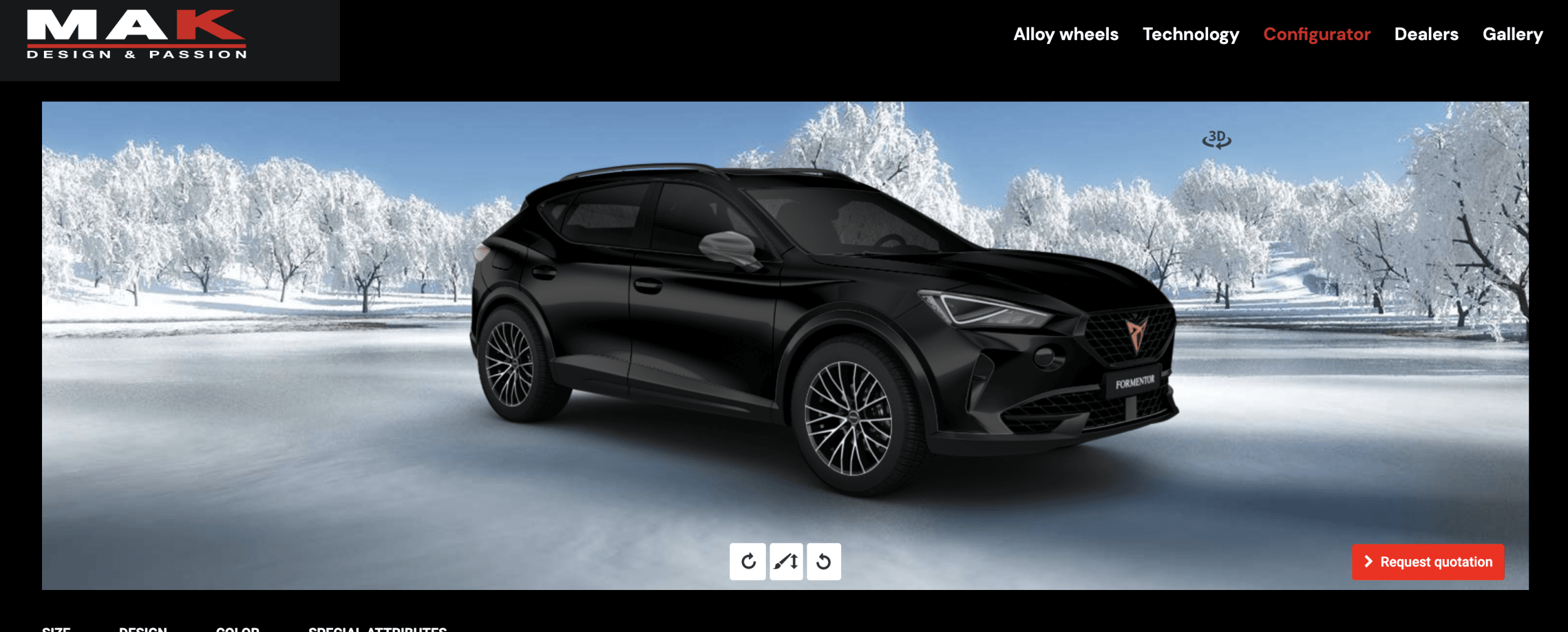

From Mak, I also like the Speciale D which is available in the exact same dimensions with ET45 as the original rims (but not reported compatible with the Brembo on the reseller site listed before):
https://www.makwheels.it/en/configurator/#298742446!EB51542

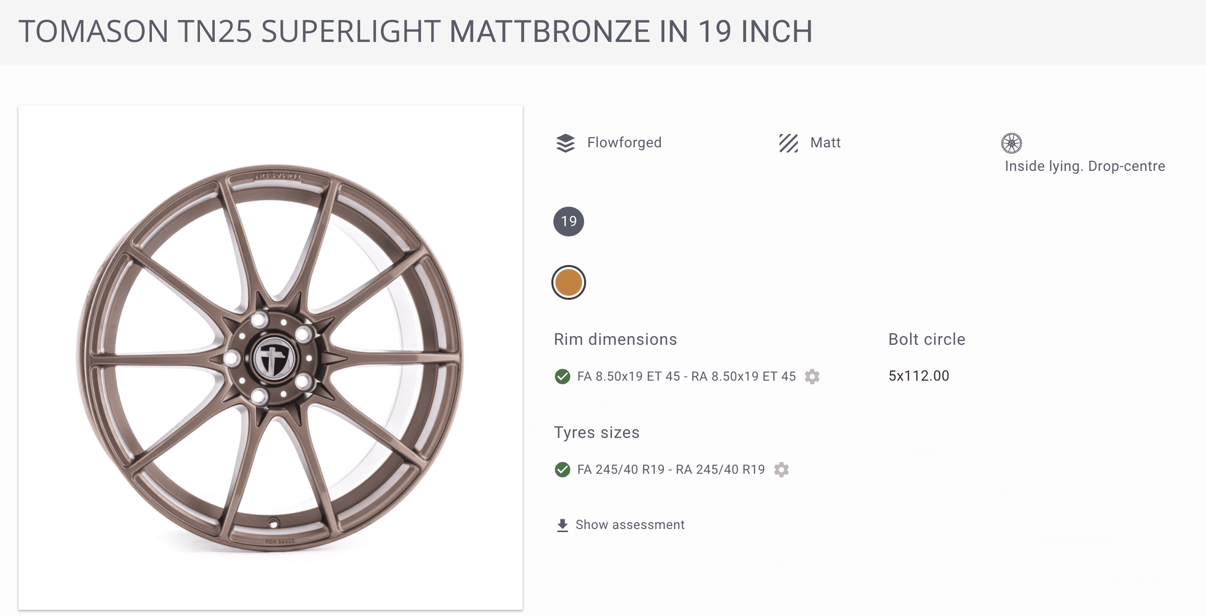

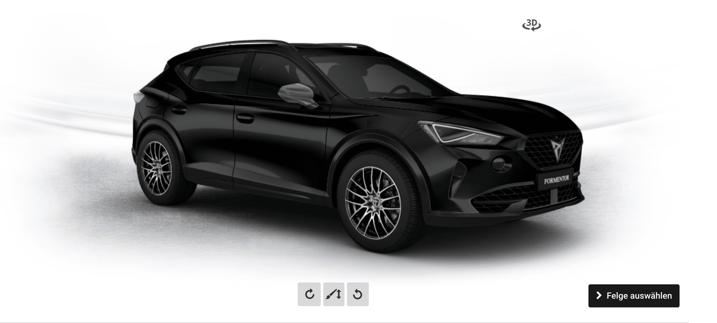

I have also found rims I like with the exact same dimensions from Tomason: The TN25 Superlight also in ET45.
One reseller told me that these would work, I have contacted Tomason 3 times including one last attempt in german but haven't got any answer from there.
I suppose the reseller only ensured that it's the exact same dimensions as the original cupra rims and it's why I still don't feel confident enough to order them.
The images with this one is a simulation (without Brembo).

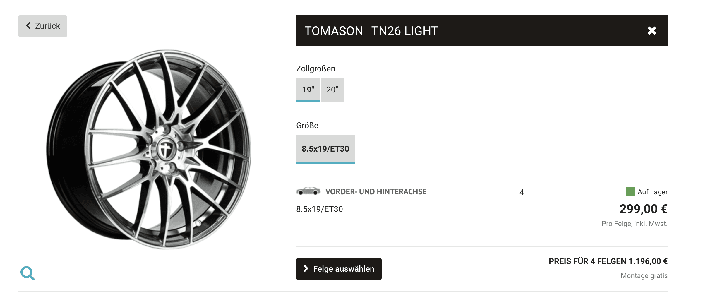

From Tomason, I even prefer the TN26 from Tomason but these are with different ET: 8.5x19 ET30 so also don't have a clue if it might work.

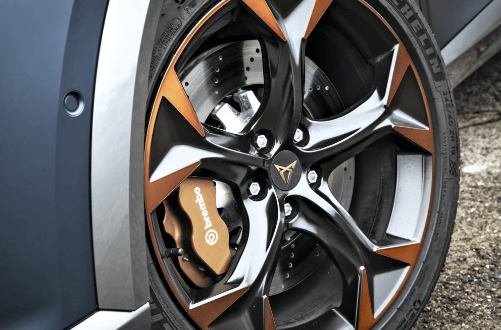

The problem is that they pretty much "stick out" even compared to the screws.

To clear Brembo's it is all about the spoke design.
Other than trying them on like a pair of trainers there is no real other way of confirming they will fit

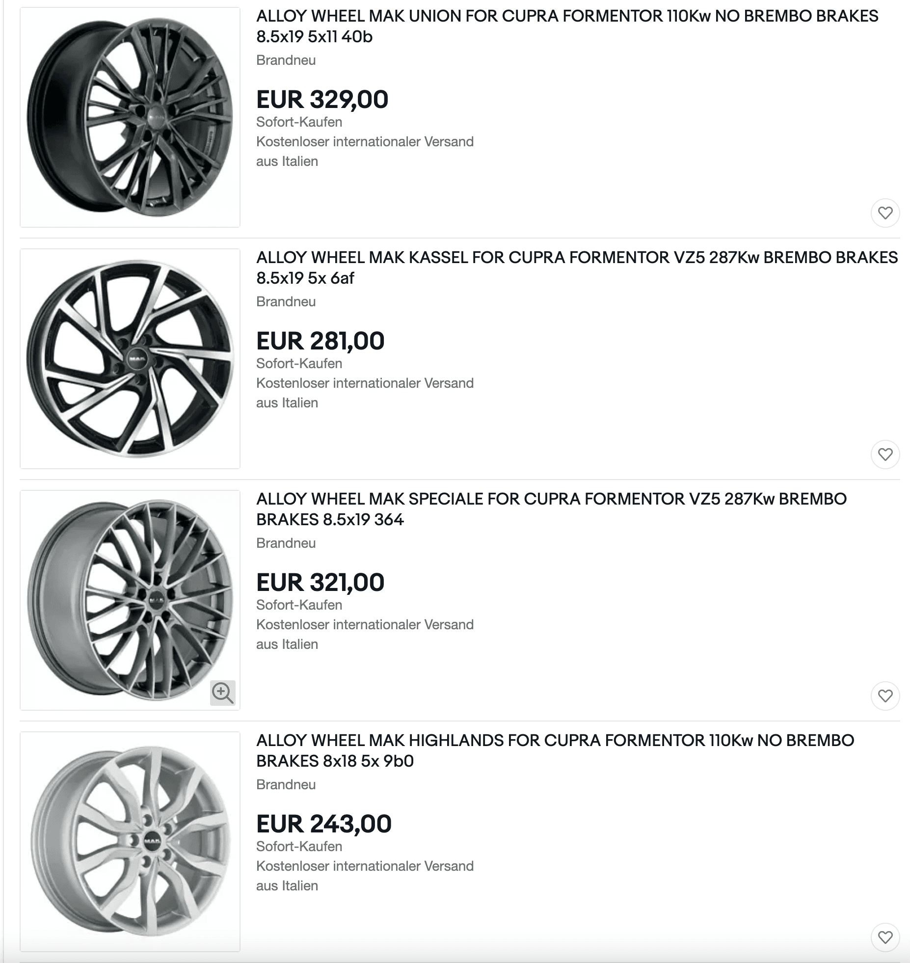

I've also found some ebay listing where some models are specifically marked compatible with Brembo but refering to the VZ5 and I'm not sure it's a guarantee either:

Tomason TN26 8.5x19 ET30
Seller
Answer:

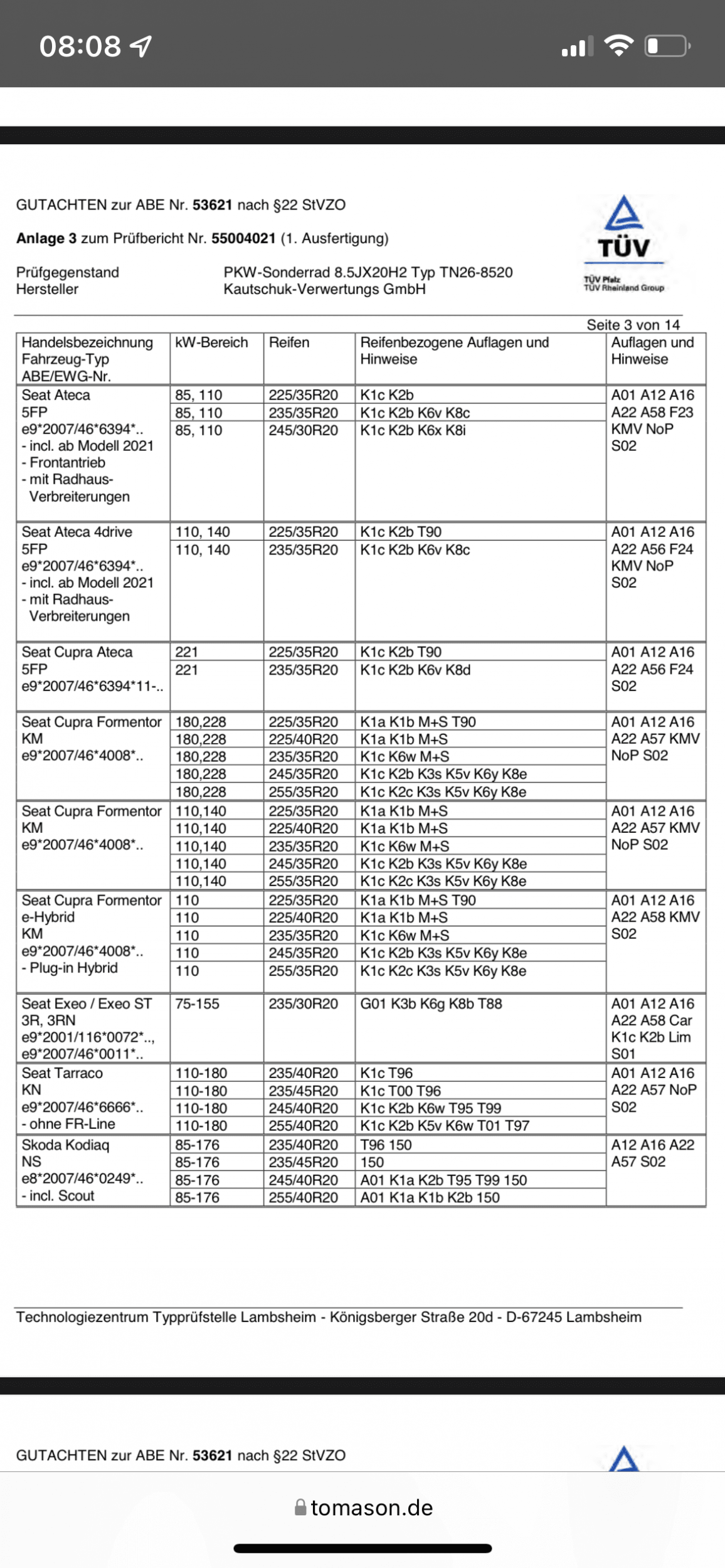

The Tüv has not given any restrictions in the report for the Brembo brake. This rim will also fit on the Formentor with the brembo brake.
Here is the TÜV-Certificat:
https://download.prok-raeder.de/gutachten/Tomason/gutachten/00358447.PDF

After a couple of confirmations that they will fit and are homologated for the vehicle.
I am about to order the TN26 from Tomason, the TUV certificate indicates they are ok/homologated in EU:
These are in ET30. (Only homologated on the 4wd version which I have for the 110/228kw Formentor)
The TN25 which I also really like are in ET45 are also homologated however it’s not a direct fit and they require a 5mm spacer, longer screws, etc..
So I prefer to go for direct fit.
I am just confirming return conditions with the reseller “in case” and somehow still tempted to take them in 20’ instead of 19’ but I am going to order most likely today or tomorrow.

I saw multiple fitting tires still from the tuv statement (225-255). The reason I had 235 in mind is because the tires I want are available with rim protection feature while the 245 apparently not (or not in stock).

As to tire sizes, forget what those papers say - go to the tire size calculator site I gave you, put the stock wheel size as reference and whatever you choose needs to match wheel circumference.
That is what matters - the tyre width will somehow be dependent on the rim width, but if you go for a wider tyre then you need to lower the sidewall size and increase the chances of rubbing.
I am pretty sure that a few of those sizes quoted in the table you published are completely wrong.
