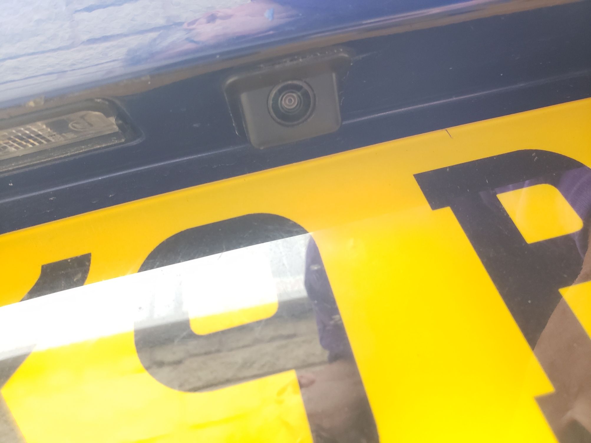

The highline camera I had fitted to my Leon ST is mounted on the bumper above the number plate where the lowline camera sits. Dynamic guide lines which move with the steering wheel and multiple views are fully available
