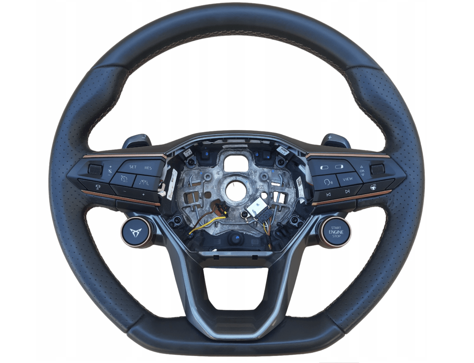

Hi everyone. I have Formentor without Travel Assist but I have Safety and Driving Pack L (Trafic Sign recognition, blind spot, lane assist. )Can I replace my steering wheel with that one, and make some coding to activate Travel Assist? Also can I enable that buttons with Start Engine and Drive Modes?
Yes you can code the travel assist if you will change the steering wheel with capacitive sensor in it.
I can provide coding if you want.
