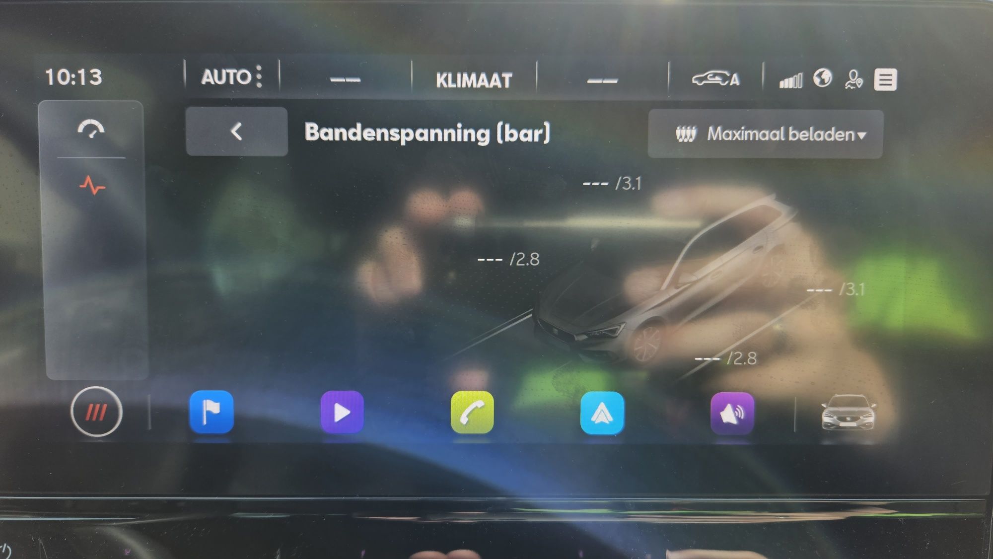

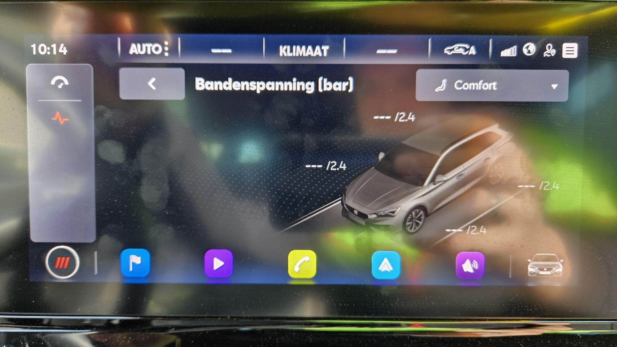

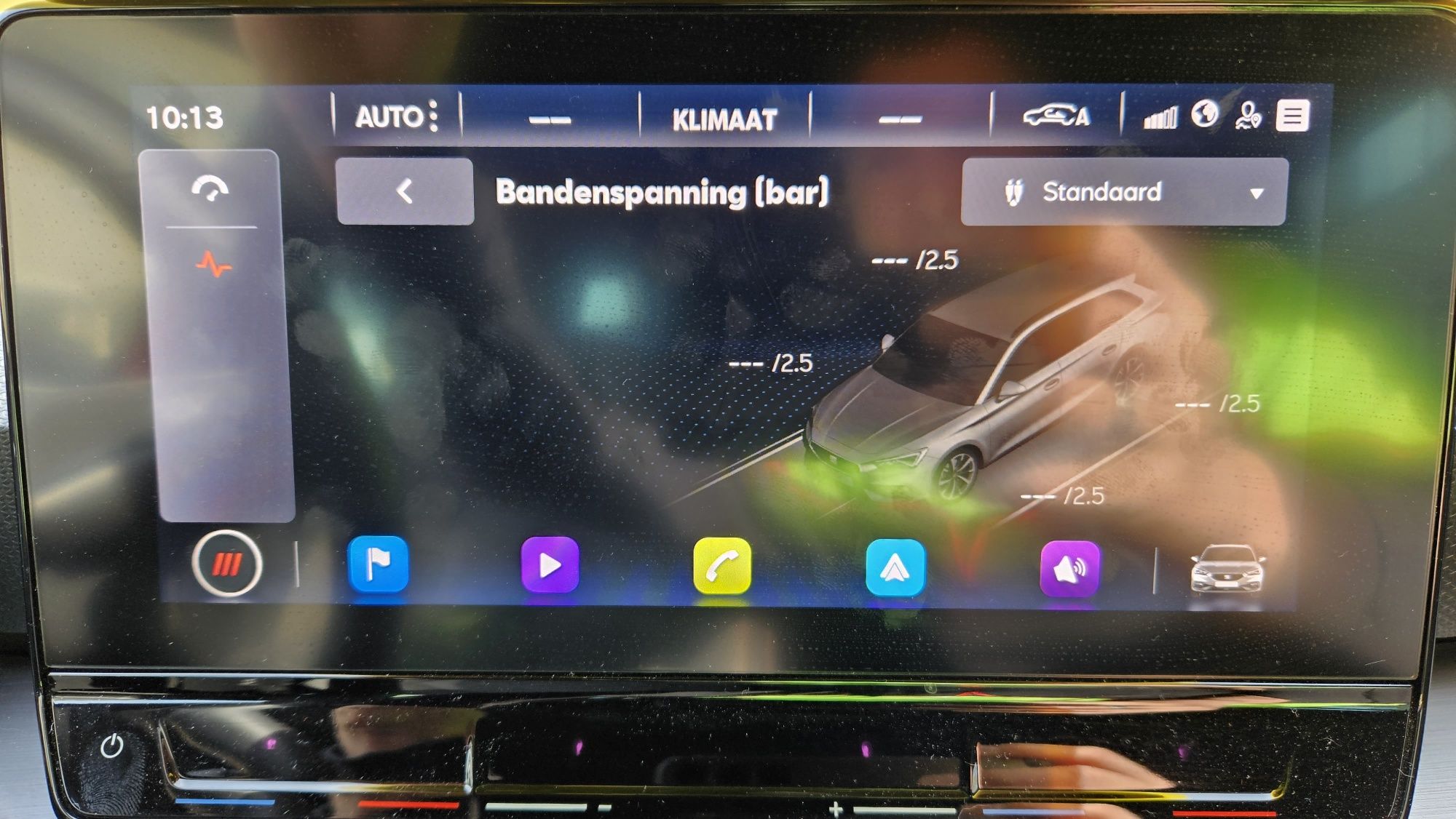

I was looking for some upgrade for my Leon en found something it doesnt have from factory but want to try it on my car.
I found a kit with a active TMPS reciever and 4 sensors for in the wheels.
TMPS Set
Doesnt look to hard to install so i did give it a go. It worked on previous models so why not on my car.
Ordered the parts and start fitting all in the car. This was not that easy as i tought at first. First connected them to the DCC canbus wires but the module wasn't visible. First i tought i have a bad module en looked for a second hand one to try iff that is the problem. It wasn't. .

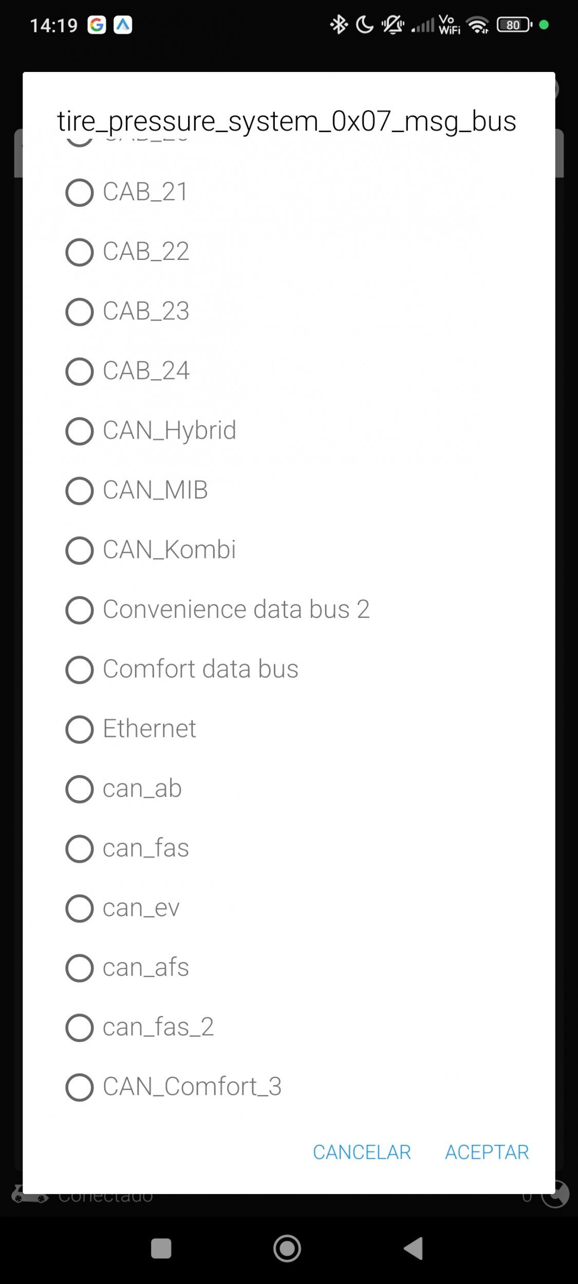

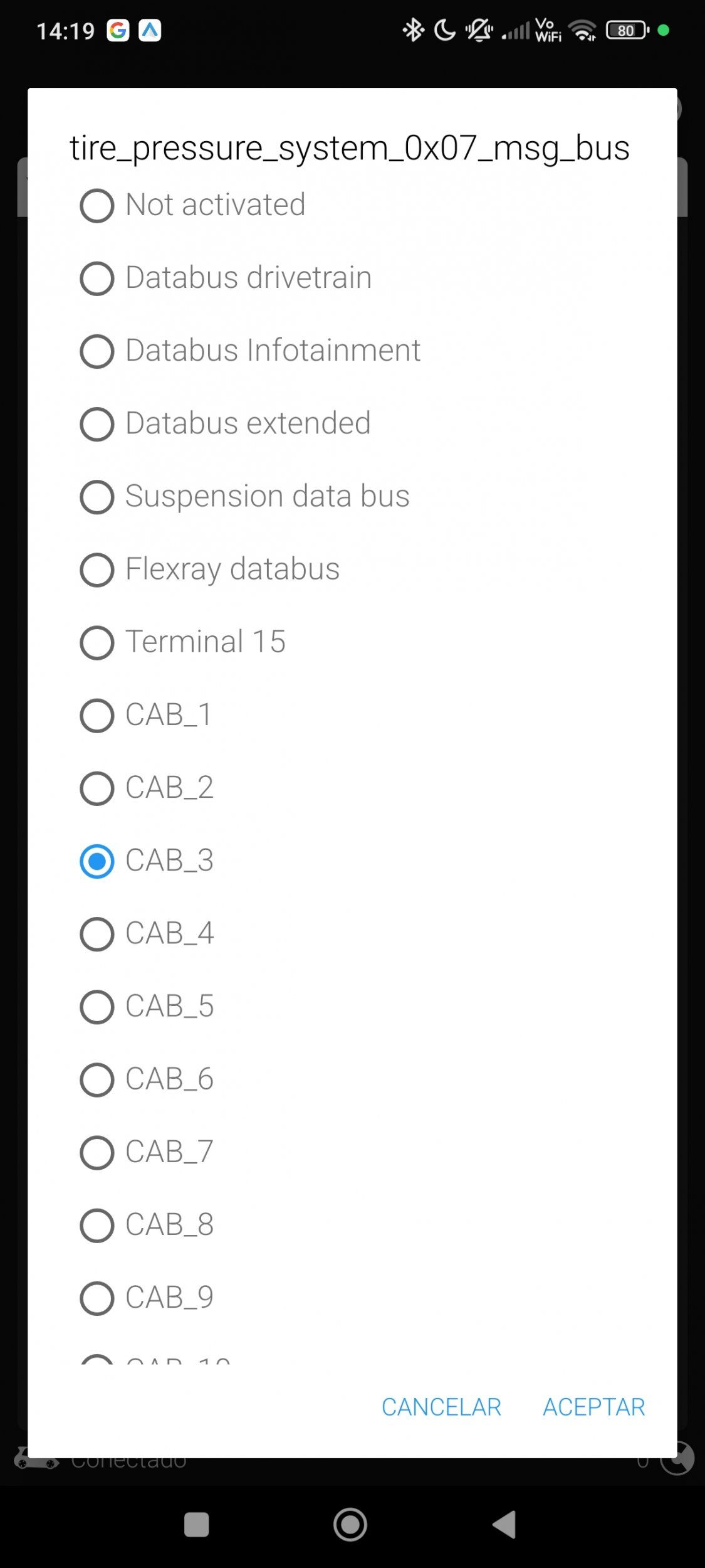

So i need to look for another solution. Because this is never mounted on a Leon i have to find out where the canbus wires need to be connected. Download a few wiring diagrams from other cars to figure it out. It took me a while to see why it wasnt working. The canbus was connected to the wrong Canbus wires and i need to connect the wires at the gateway on the right wires.
The canbus wires need to be connected on the right canbus wires wich are comming from the gateway or else it wont work.

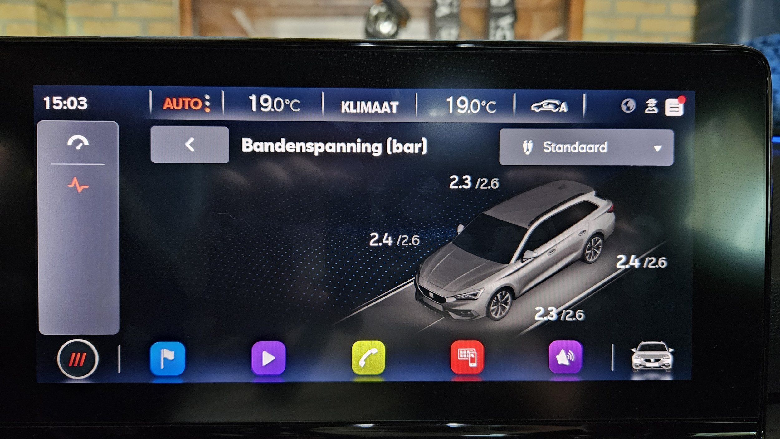

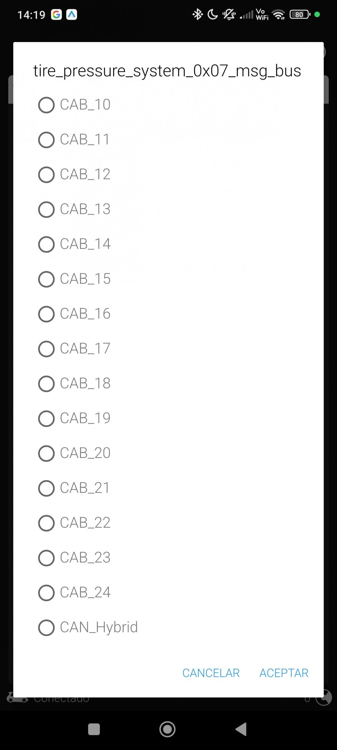

After i finialy have time to do so i connected them to the wires at the gateway and finaly i found the module with vcds/odis. Now we are there. Now putting in the right dataset for my car to get it all working. I wanted to select wich load the car have with wich pressure in the wheels. Started some coding to get it al visible and the car needs to now its now active TMPS and not anymore with the ABS Sensors.
And see the results :love:
