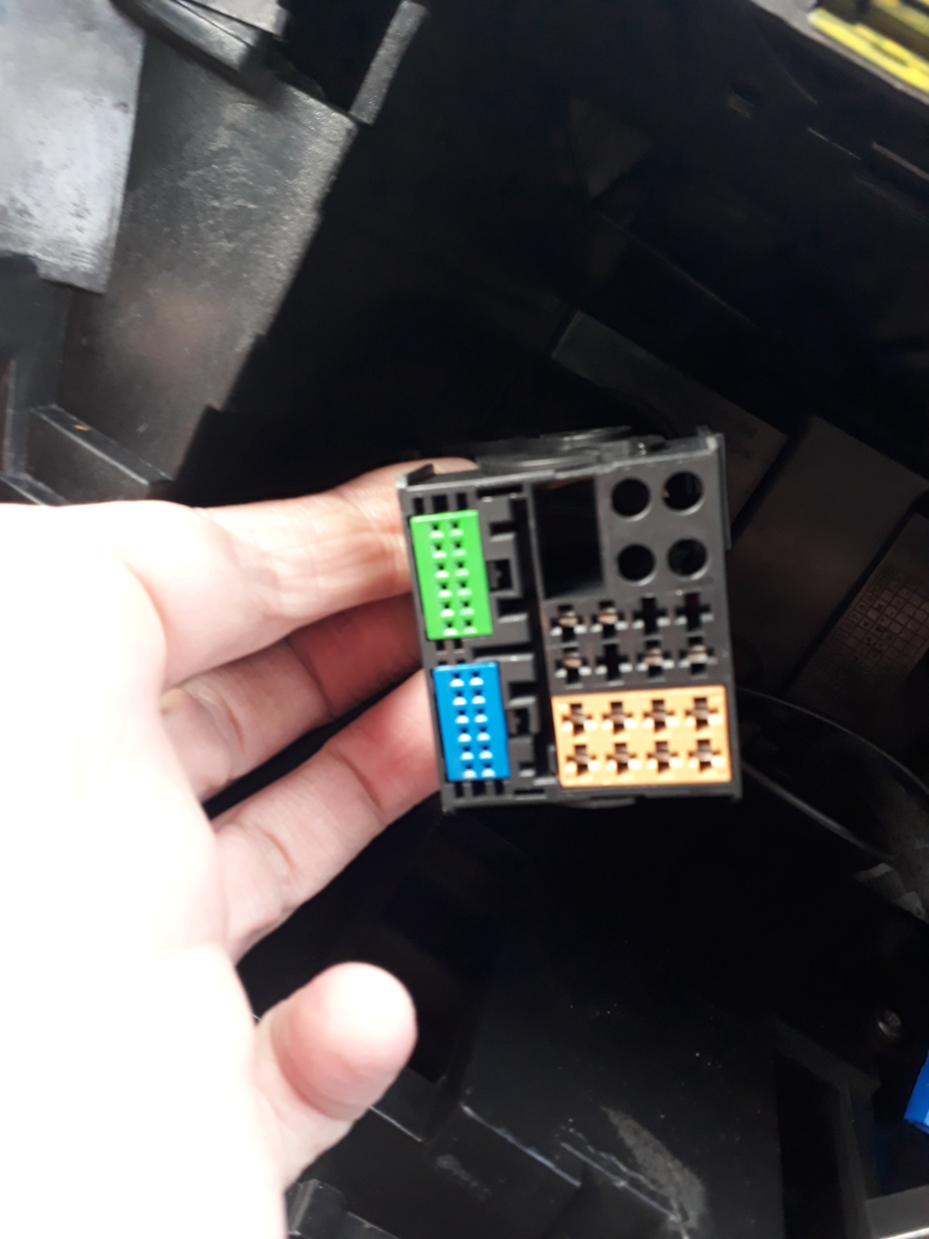

I retrofitted the same headunit on mine the Bluetooth module is built in on this unit, look under the drivers seat see if the car comes with a module already installed if so this would be the cause it may be interfering with the 1 built in if you pull the headunit out the big plug should have a green section in it if it has not then they haven't retrofitted the Mic. If I can help with anything else on this give me a shout

So pulled the unit out today. and there does appear to be a green plug as per pictures 20181202_114919.jpg 20181202_114727.jpg . everything looks ok. when i plugged back in it asked for the code, and whilst i was trying to remember if i had seen one, it just booted into the system without the code. which i thought was odd.
before powering back on i had located the bluetooth module under the seat and unplugged it.
unfortunately the battery has died on the car so cant do anymore troubleshooting. battery charger on order.

yesterday i left the unit out for 5mins then put back in, it asked for the code and i put it in but made no difference it still wont clear old destinations and store new ones. i am thinking it may be a defective unit.
after removing the under seat bluetooth module i was able to pair the phone directly to the rns 315 without using the dash, however the mic didnt seem to be working despite having the green plug.
@DannyallenFR - where should the mic be in the roof?

The Mic is in the light unit in the front centre easy to remove just clips holding it in place, it does sound as if it may be defective I never tried to clear mine tbh.
