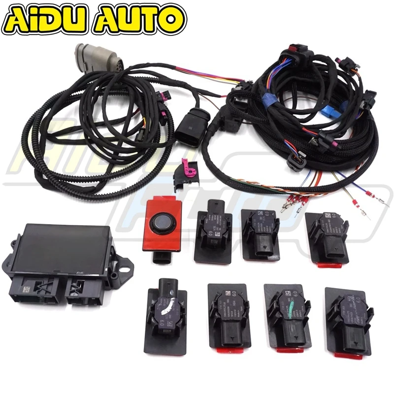

I retrofit a lot, and the quality of kufatec is bad, wrongly pinned. General material quality, everything the same color etc. The cable sets from the Far East are top quality, mostly OEM color, great support etc. I only buy from the Far East

Why should I buy in Europe when the dealer from the East can do better, has more OEM, and is significantly cheaper?
Yes, i guess it is understandable for you since you retrofit a lot, for me i thought differently maybe because i don't think i know who is trustworthy with coding controle units etc in my country, the link you sent me i remeber sending it to someone who do retrofitting and VAG coding, and he gave me a vague response about checking the part number for the aliExpress park pilot which i couldn't find, that's why i thought maybe european vendors would be moe clear about technicals specifications eventhough they are more expensive, i'm really feeling lost, and afraid of buying things that would't work 😩😩😩
