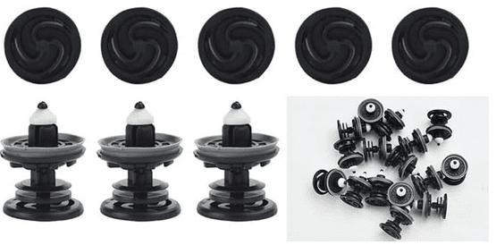

This is for anyone reading this years later (like me). I've just replaced my drivers side windows. Things to think about:
1) Consider buying a few door card clips - often several break when you lever the door card off. Look like this:
