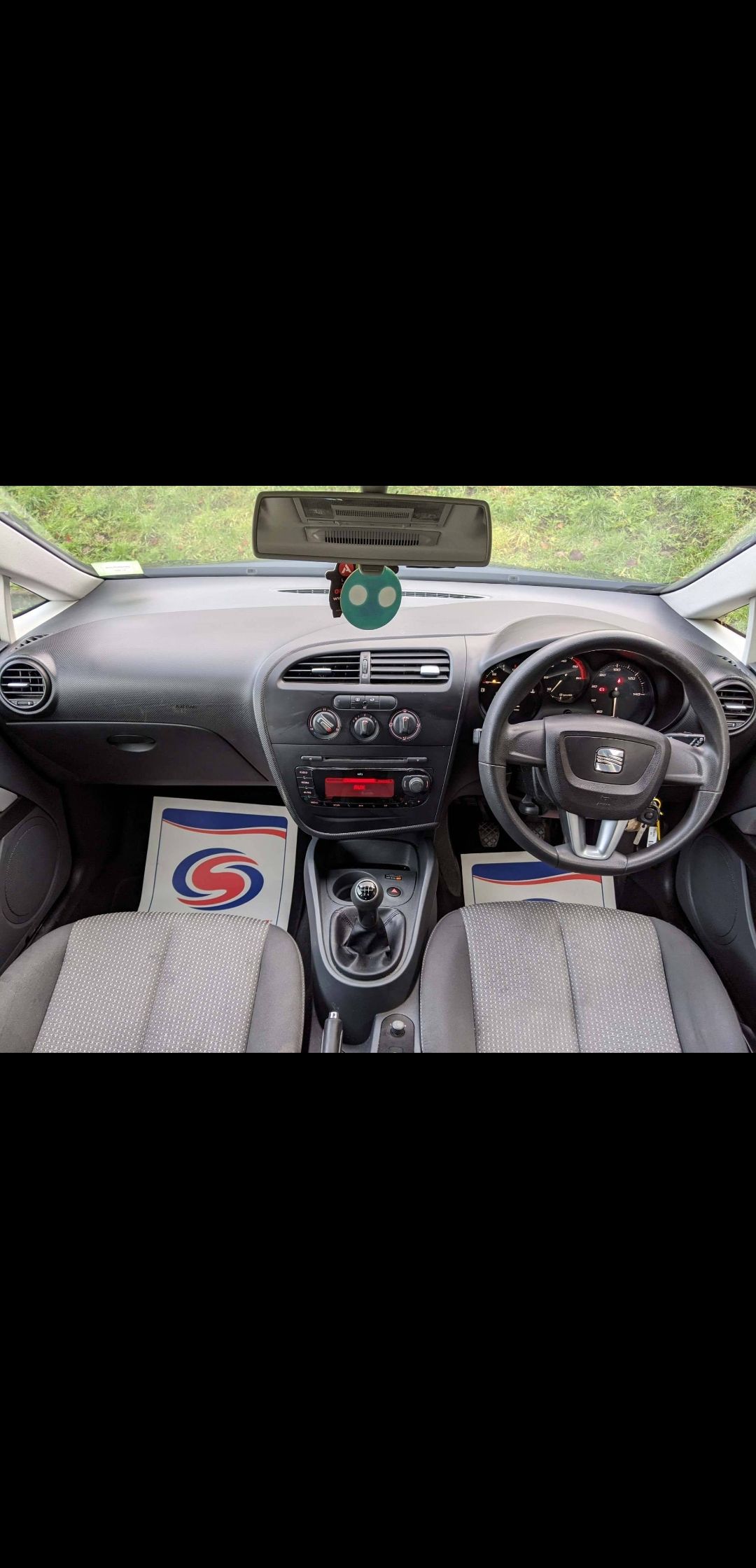

Hi, did you have a bog standard head unit before fitting the rcd330?
I'm trying to work out if I can replace my head unit straight out for an RCD head unit and just get a new facia? Or if the sizes are all different. I've added a pic of what's in mine.
Apologies about not answering your question at all 😂

That is the same stereo my car had originally, I had to buy a new facia that is designed solely for the VAG RCD/RNS head units, you can tell them from double din facias by the rounded corners.
The one I bought was https://www.ebay.co.uk/itm/333865284318 but the colour and finish is not a perfect match for the standard dark grey facia.
To fit the RCD330 i had to cut part of the inside of the dash just below the stereo as the SD card cage hits it and prevents you from putting the unit in properly. 2 minute job with a junior hacksaw blade. It is unseen once the unit and facia is in place.

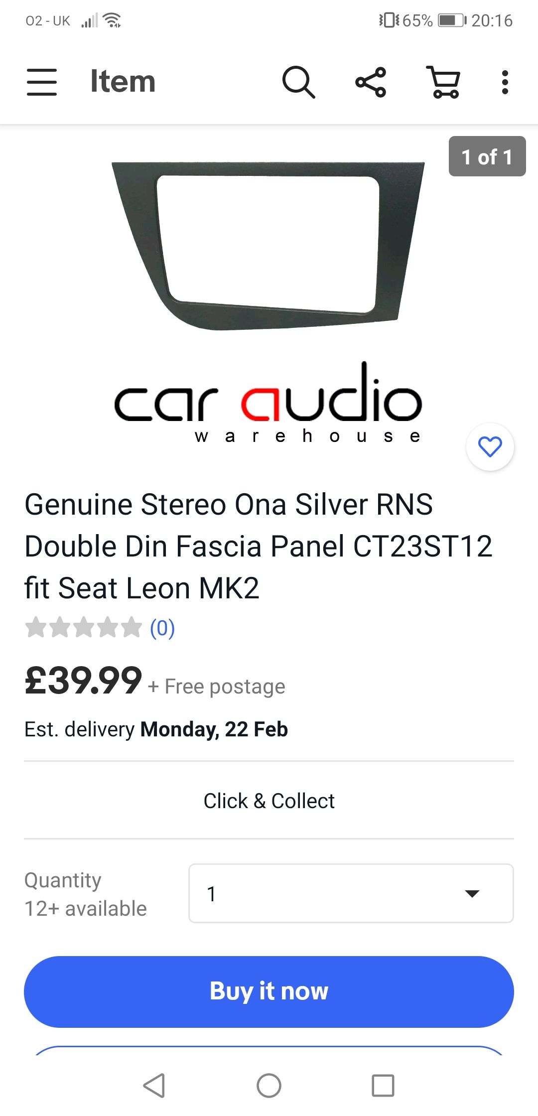

Ah that's great cheers, thought there would be more to it than that. Are any additional adaptors needed?
Just had a quick look on ebay but it is tricky to tell exactly what colour the facias are in pics.
Found this one and says its OEM but also says the colour is silver 🤔

The RCD330 came with an adapter for changing the aerial in the car from two connected plugs to one plug (thing it just ditches the AM/MW signals), but I didn't need it as my car only had one aerial plug.
It also came with an adapter to install the reverse camera but I've not decided whether I want to install one yet.
The main connector was the same.
I think silver is a silver as I have seen leons with lighter interiors to mine, silver might be a colour more like the flat bottom of the FR/Cupra steering wheel. Mine is definitely dark grey, no way anyone would describe it as silver, it's like a metallic gunmetal colour, but who knows.

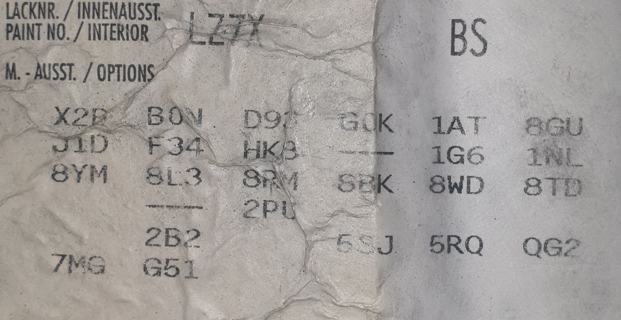

Just found out there's another colour 🤦‍♂️
1MM persia black
47V ona silver
FJ2 dark grey
GB1 galena silver
N87 brilliant silver
I wonder if it is written on the sticker in the boot, I'll have to have a look in the morning.
