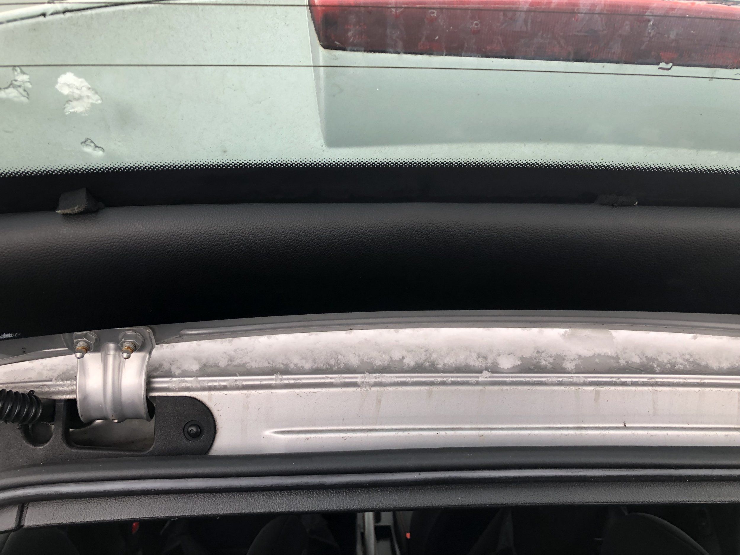

It was the plastic inside the boot lid for me, towards the top above the glass. Wedged in a couple of pieces of black foam and it fixed it.

I just wedged a couple in this bit:

done the same lol, found some foam floating around my boot and shoved in the gap. rattle solved. Sometimes the boot lock mechanism can rattle also.
