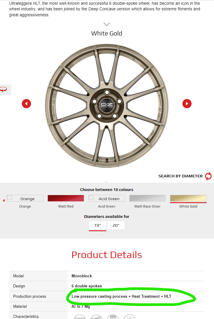

Sorry to say it but Ultraleggeras are just Cast, and the Ultraleggera HLT's that you'd be getting, are also cast but with an additional unique HLT process used by OZ to create a lighter wheel.
None are forged.
The HLT exclusive manufacturing process achieves mechanical features comparable to those of a forged wheel both in terms of weight reduction and structural strength.
Notice it says "comparable", take that as marketing basically saying that if you reduce the weight by 1kg, its comparable to reducing the weight by 5kg, as both are reducing the weight.

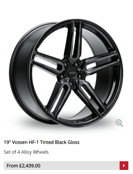

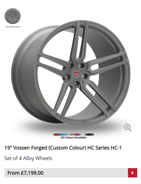

If you think £2,800 is expensive, Forged wheels in 19" would be more like £6,000+. Here is a comparison with Vossen wheels for the Cupra:

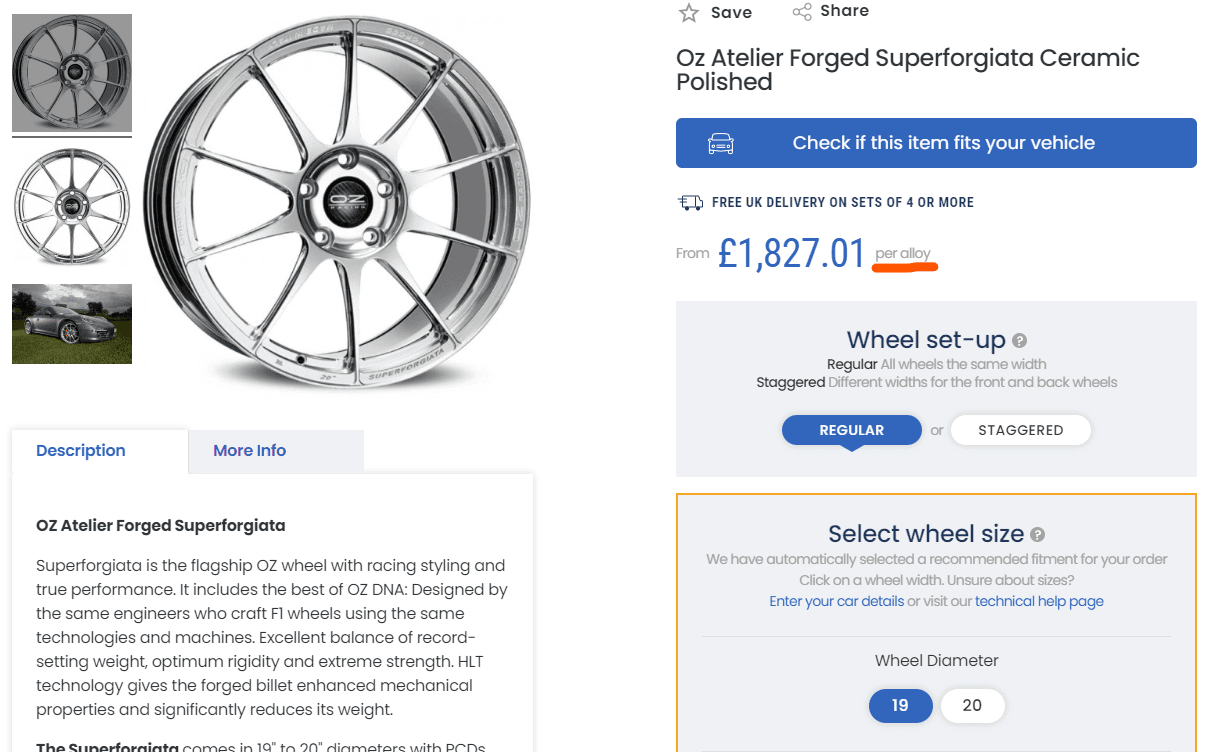

Finally found a site selling the OZ forged wheels....
Note these wheels are Forged AND HLT treated, The HLT make these forged wheels lighter that normal forged wheels in theory too.
So yeah, that's £7,300 for forged wheels....

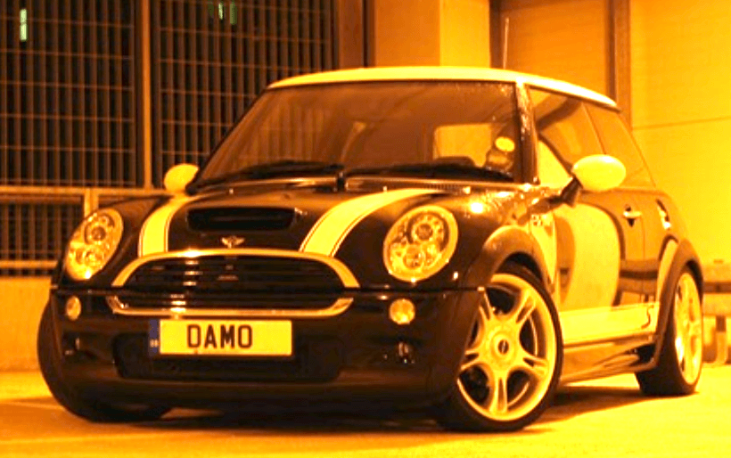

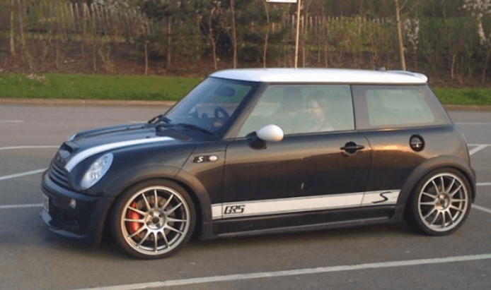

Now saying all this, this is not to say that the Ultraleggeras aren't a great light wheel. They are. I had the Superleggeras in 18" on my old MINI and they made a MASSIVE difference, and that was a weight saving of 4kg per corner on that car back then. The factory fit 17" S spokes were heavy, my OEM 18" Spider Spokes before theses were actually slightly lighter than the 17s, but the 18" Supers were still a drop from 10.5kg to 6.5kg from the older 18s.....
So if these are saving you that and some, you don't need to worry about whether they're even forged or not :)
