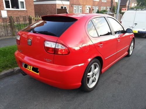

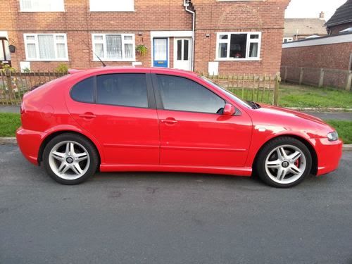

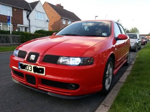

Hi
so after searching for 5 weeks i finally found a leon cupra worth buying, it was a mission away but after 7 hours i am home with my new girlfriend :D
comes in red on a 2003 plate with around 67000 miles, im 4th owner, fsh :D
engine is a little dusty and alloys slightly kerbed but the car interioir and bodywork has to be a 8.5/ out of 10 .
Will be looking to do few subtle modifications once my insurance is confirmed :D
so hello to all of you again

yeap will be taking pics today :D , BTW im really liking rs6 reps for the cupra, will the 5x100 et 35 fit my cupra on 18" ??? ^^^^

Red?
Cool :)
Welcome to Leon ownership mate, with such low mileage you're laughing. (Mines done twice that and still goes well enough)
