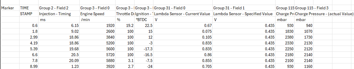

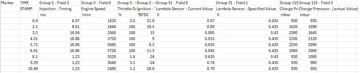

Logs on 4th gear
Logs on 3rd gear
More logs on 3rd gear

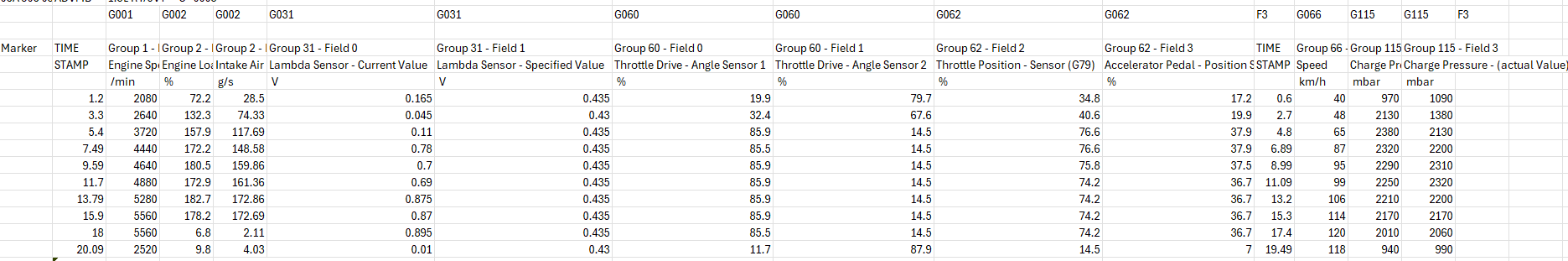

Hey mate. Timing looks weird on the first Log. You're at -16 BTDC at 4500rpm. That would definitely cause a power dip between 5000 and 6000, and i would guess is a fault with the mapping. The reason is that as engine speed increases, you want the combustion to start earlier and earlier (so more degrees BTDC) so that the air/fuel mixture has more time to start burning, and produces pressure at the right time. With the timing being so close to zero between 5-6000rpm, most of your power will be wasted, the piston will already be half way down it's stroke by the time the pressure increases, rather than being just past TDC which i where you want to peak pressure to be. Hope that makes sense.
Also the lambda values look weird in the 3rd log. The actual and specified are miles apart and the actual is all over the place. Also the specified value is just a straight 0.435v which is not what I would suspect to see. What map is it?
Could run some more logs with the lambda Group 31, and timing Group 3.

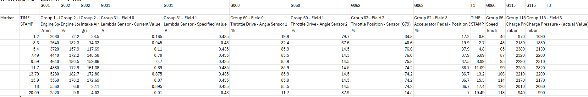

First thanks for your time mate. Sadly I have no idea about the map. But yeah that lambda (o2) shows only 0.435v specified which is strange. Tomorrow I will run more logs of what you said and will come back.

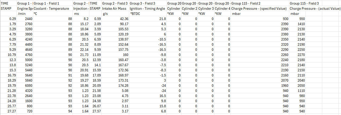

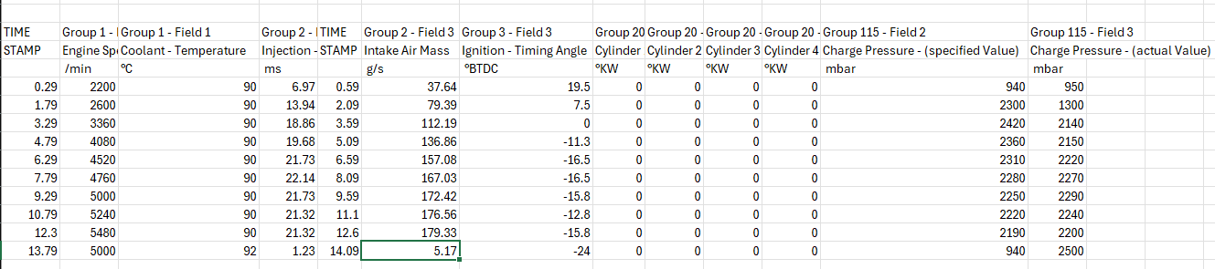

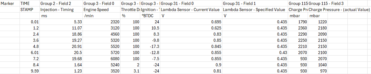

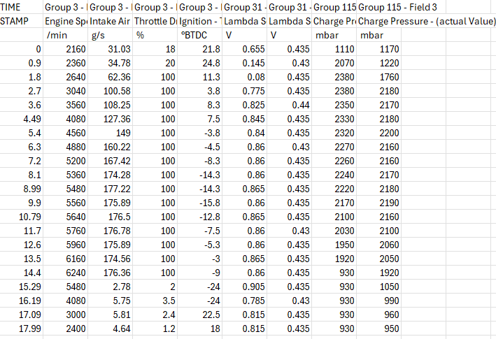

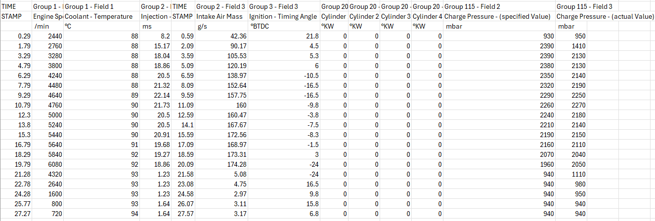

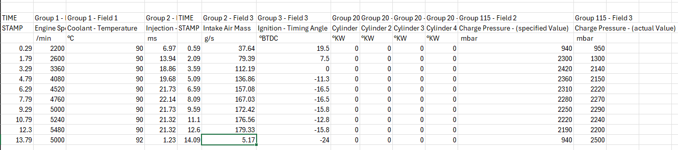

Here are the logs.
3rd gear: Actually that run went kind of ok
3rd gear: Here I felt the invisible wall around 5000k rpm
2nd gear run:
Another 2nd gear run:

It's still got hardly any timing advance despite showing no signs of knock in your other logs. That coupled with the lack of any specified lambda values and the extensive mods, I think you really need to get it on a dyno with a good tuner, especially as you said the boost goes nuts on the N75 and you have to use a MBC etc. Without a known good map, i think you could be chasing your tail on this. Also possuble that some VCDS codes have been coded out of the ECU to avoid failing emissions etc.

Btw interesting is that when the problem is happening I saw the boost gauge starts to overboost but a little by little, meanwhile the map sensor readings are just fine. I tired holding for longer my foot on the pedal and the overboost goes back to normal levels on the gauge and at the same time car feels better for 1-2 seconds. I am pretty confident my MAP sensor is totaly fine but... these gauges I am not so sure which should I belive.
