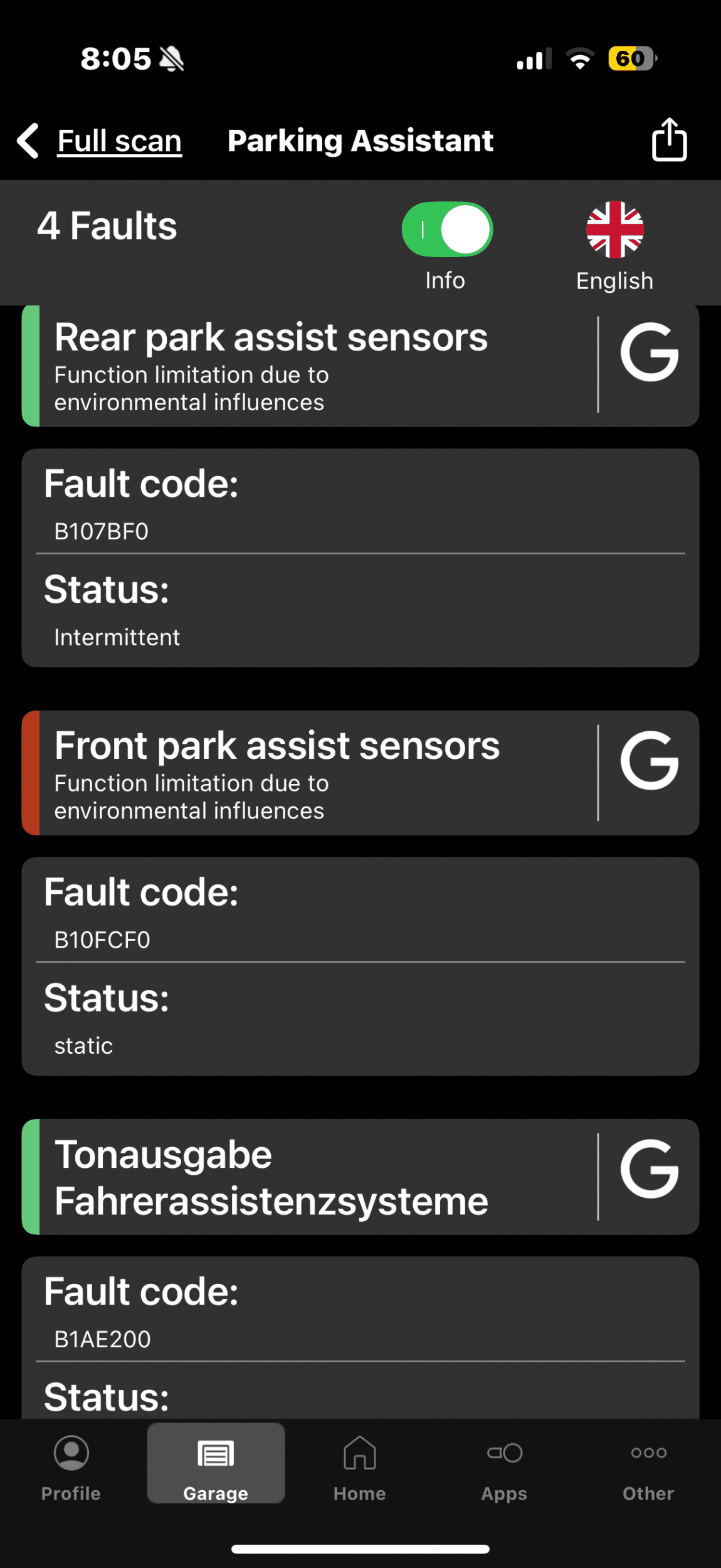

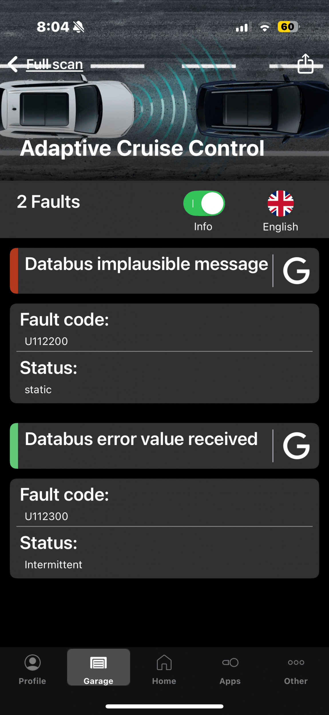

Recently had a front wheel alignment, I get a message pop on my dashboard every 2 minutes, I have cleaned the front & back sensors but the message & manoeuvre braking also pops up.

What’s that diagnostic scan done using?
From error I found Error this, but doesn’t convince me that the blame wouldn’t be on the stone chip in my case. Mine was working when I pulled on the drive after work, then not the following morning.

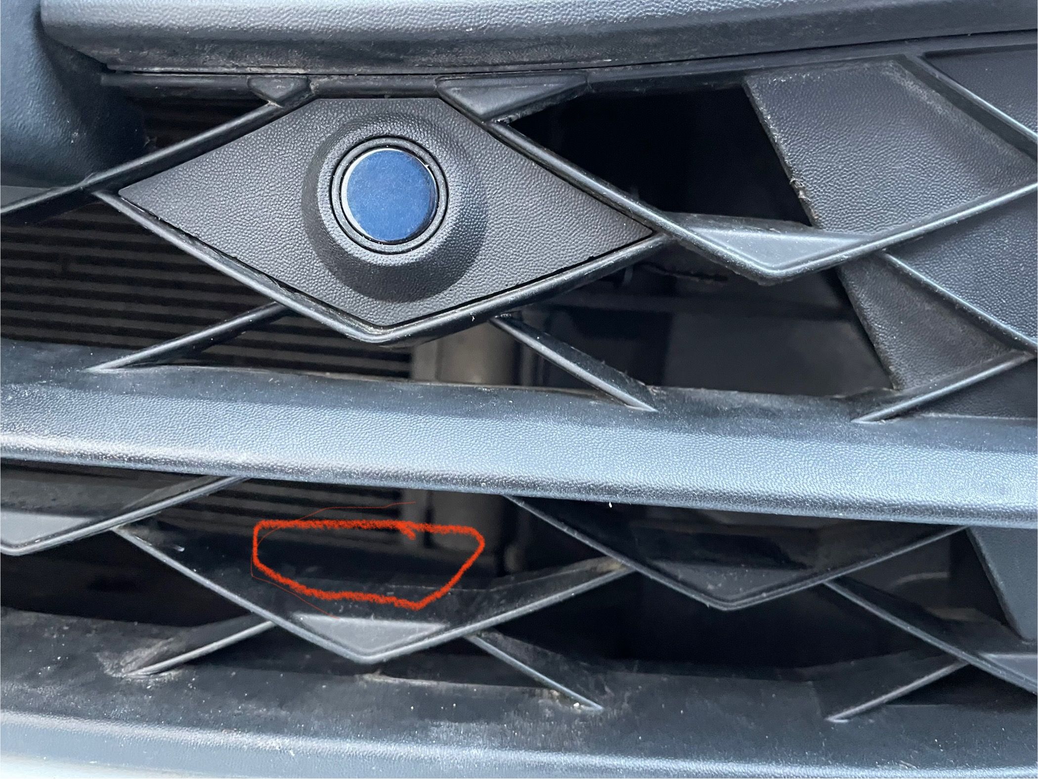

Fiddly, but managed get the old sensor out by pressing the clips top and bottom using fingers inside the grill and a little push on the front. I’d advise to start with the top one first as it’s the more difficult, you can tell from the push on front if released, then move onto easier bottom. I used the hole highlighted to remove and put new sensor in. This is the Xcellence Lux ST/Estate grill.

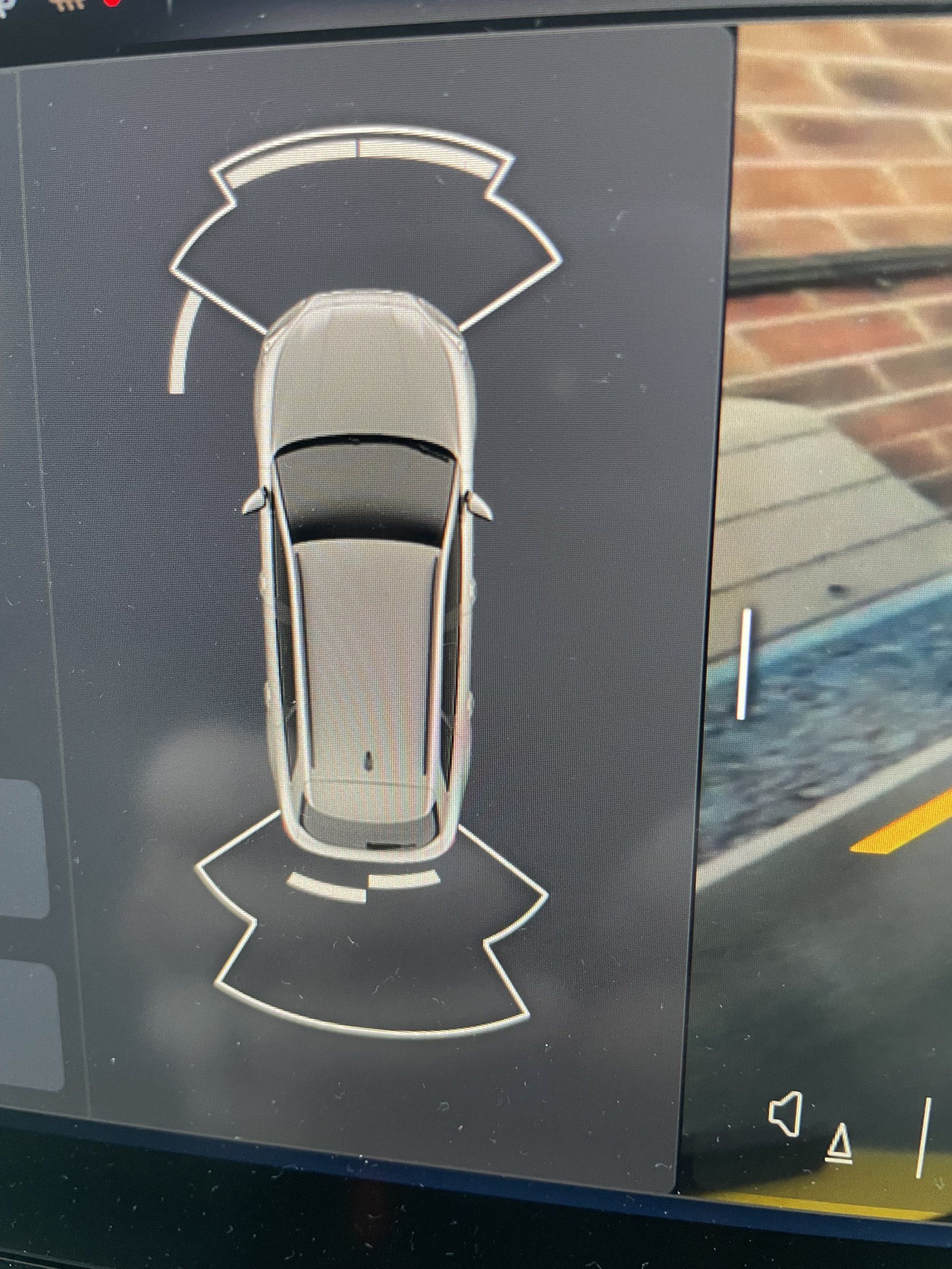

Not the best image, but shows it back working (furthest from garage). Hopefully it remains this way and newer part is improved in resiliency (higher revision number)

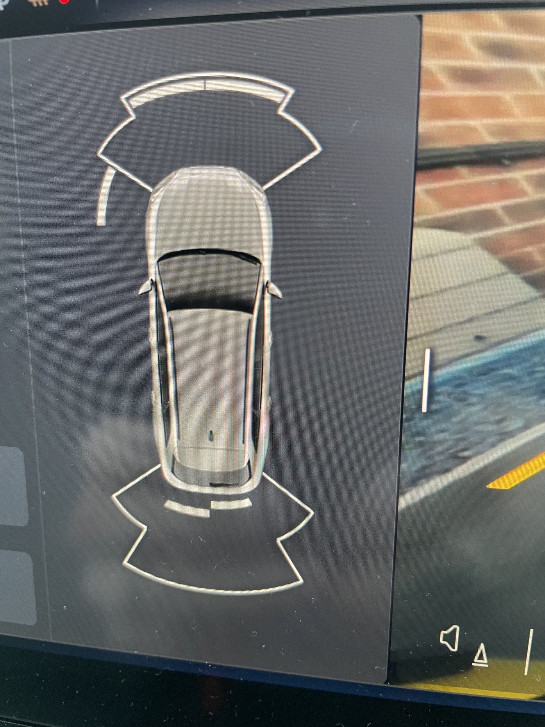

Glad yours is sorted!!, Kwik fit have told me they would take liability & cover the costs to get it fixed so it’s going to the SEAT 27th march, Kwik fit plugged in their computer and I believe the error code was “D50001” which was static & couldn’t be deleted.
