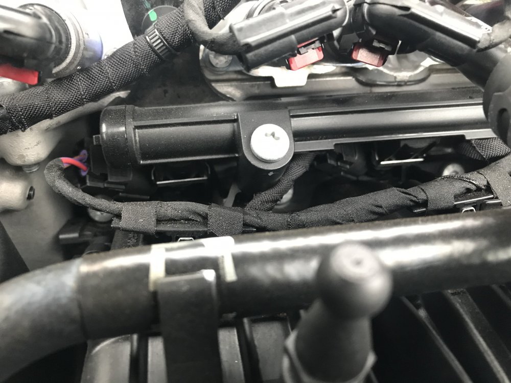

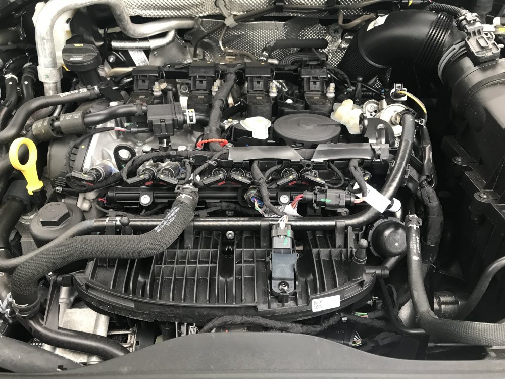

We've had the 2.0TSi (190) from new since July 2019 and mostly do <5 miles journeys with the odd longer one thrown but once a week without fail did a 10mile each way trip which seemed to be enough to keep the filter happy.
Since mid December that's not been the case and a week or so ago started to experience lumpy running and poor MPG (https://forums.seatcupra.net/index.php?threads/2-0tsi-190-lumpy-running-and-poor-mpg.458273/), the consensus is that the GPF is doing a forced regen - so like a diesel they need a decent run out every so often but seem to cope better with them being less frequent and shorter distances than a DPF would
On a side note the price / spec list that applied when we ordered our car lists the the 2.0TSi as having both port and direct injection, not sure how to check this is actually the case though.
