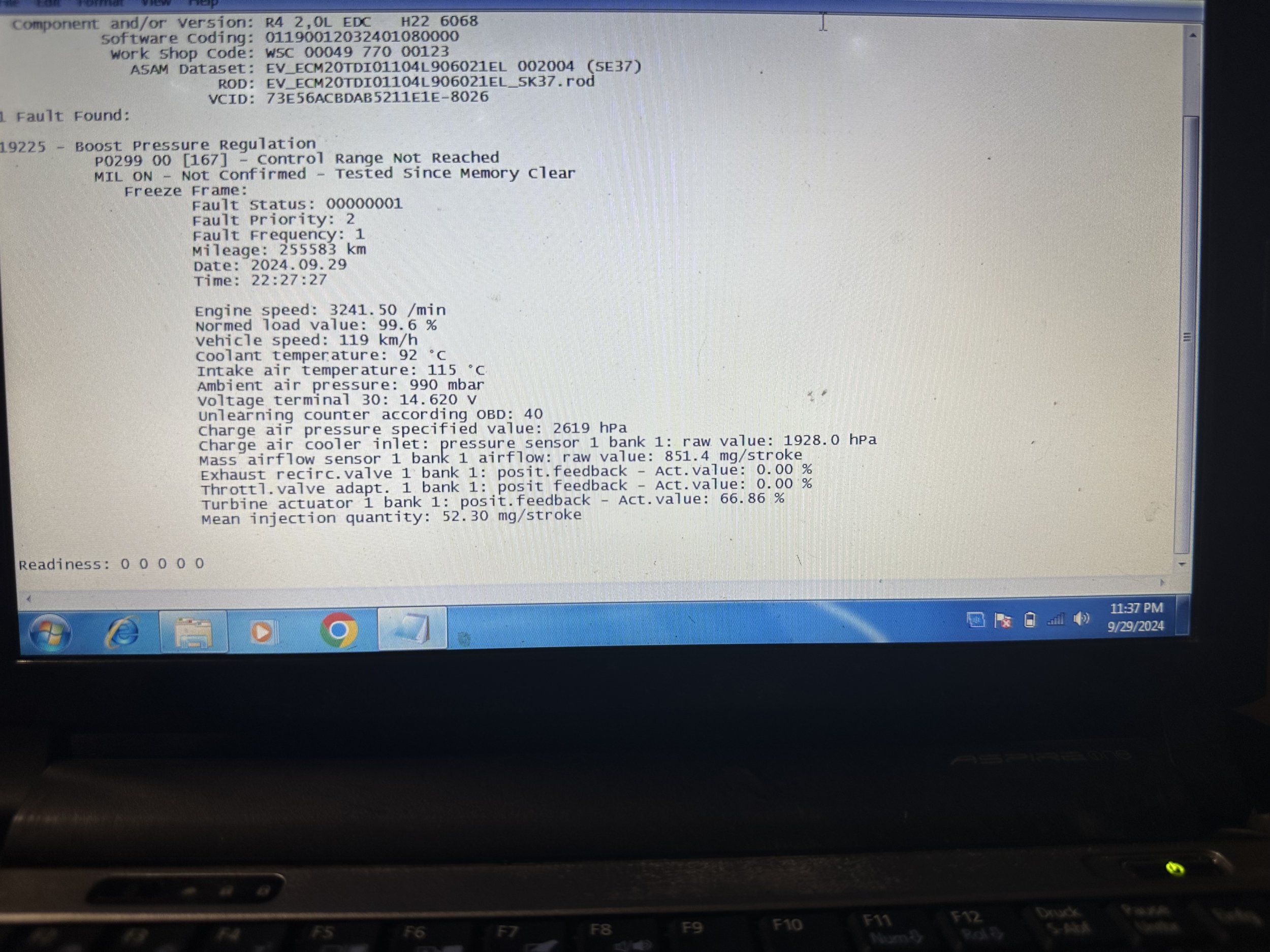

Hello! I’ve got this error while accelerating the car. Since then the car has low power ouput and if i’m going to accelerate it the error will come up again and the car will enter in limp mode. If you are going to start the car again, the error is going to disappear. I’ve already checked the turbo hoses/pipes, n75 and turbo actuator.
I want to mention that the car had no problem before(no power loss or anything like that)
The car is a Seat Leon Fr 2014 2.0tdi 184hp CUPA code engine.

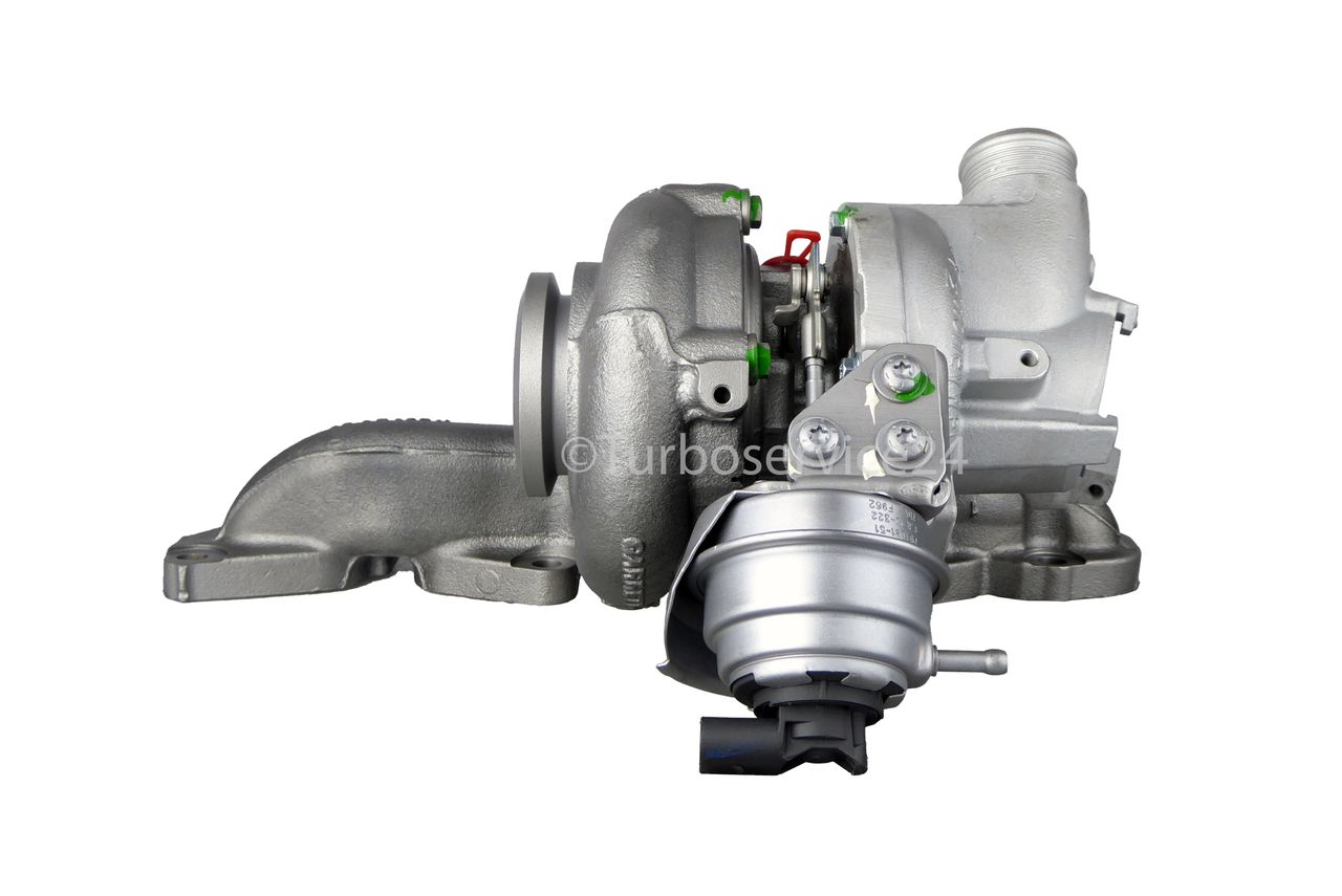

The turbo is not building up enough boost pressure. The problem is probably with the pressure cell or the rod for the mechanics.
