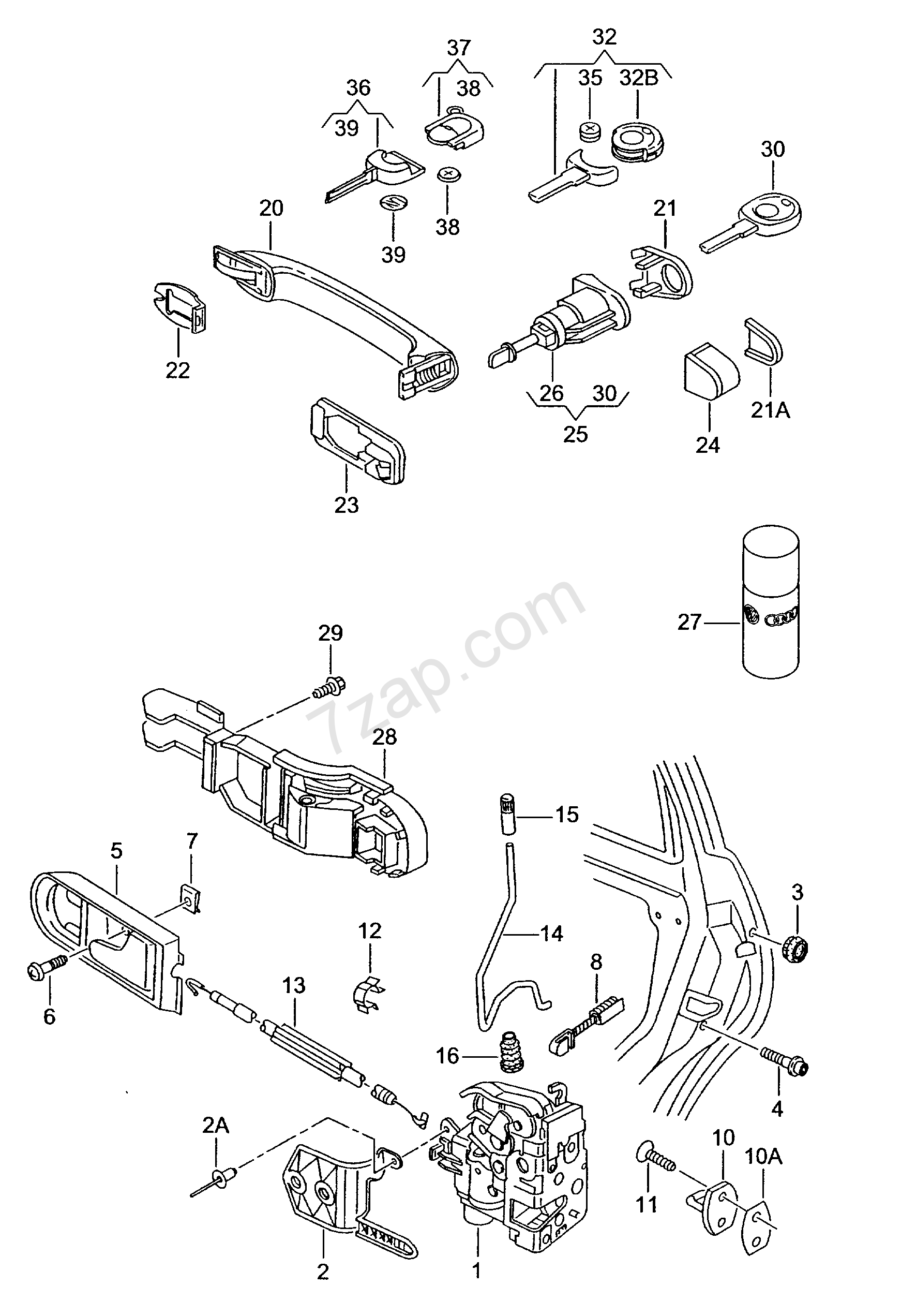

Below I've made a list of the parts including their OEM part numbers, and the number they are on the diagram.
13)
Bowden cable from inner pull handle to door lock (fit's both doors on 2 door model only)
Part number 6L3 837 085D
13)
Bowden cable from inner pull handle to door lock. (fits front doors on 4 door model only)
Part number 6L4 837 085C
Cable length 576mm
8)
Cable with clip fits to outer door handle and door lock (left side) on 3 door model
Part number 6L3 837 069A
8)
Cable with clip fits to outer door handle and door lock (left side) on 4 door model
6L4 837 069A
8)
Cable with clip fits to outer door handle and door lock (right side) on 3 door model
6L3 837 070A
8)
Cable with clip fits to outer door handle and door lock (right side) on 4 door model
6L4 837 070A
20)
Outer (exterior) front door handle (left side)
Part number 3B0 837 207F
20)
Outer (exterior) front door handle (right side)
Part number 3B0 837 207G
The exterior door handles are available as plain black plastic, or available as primed ready for painting.
Hope this helps
