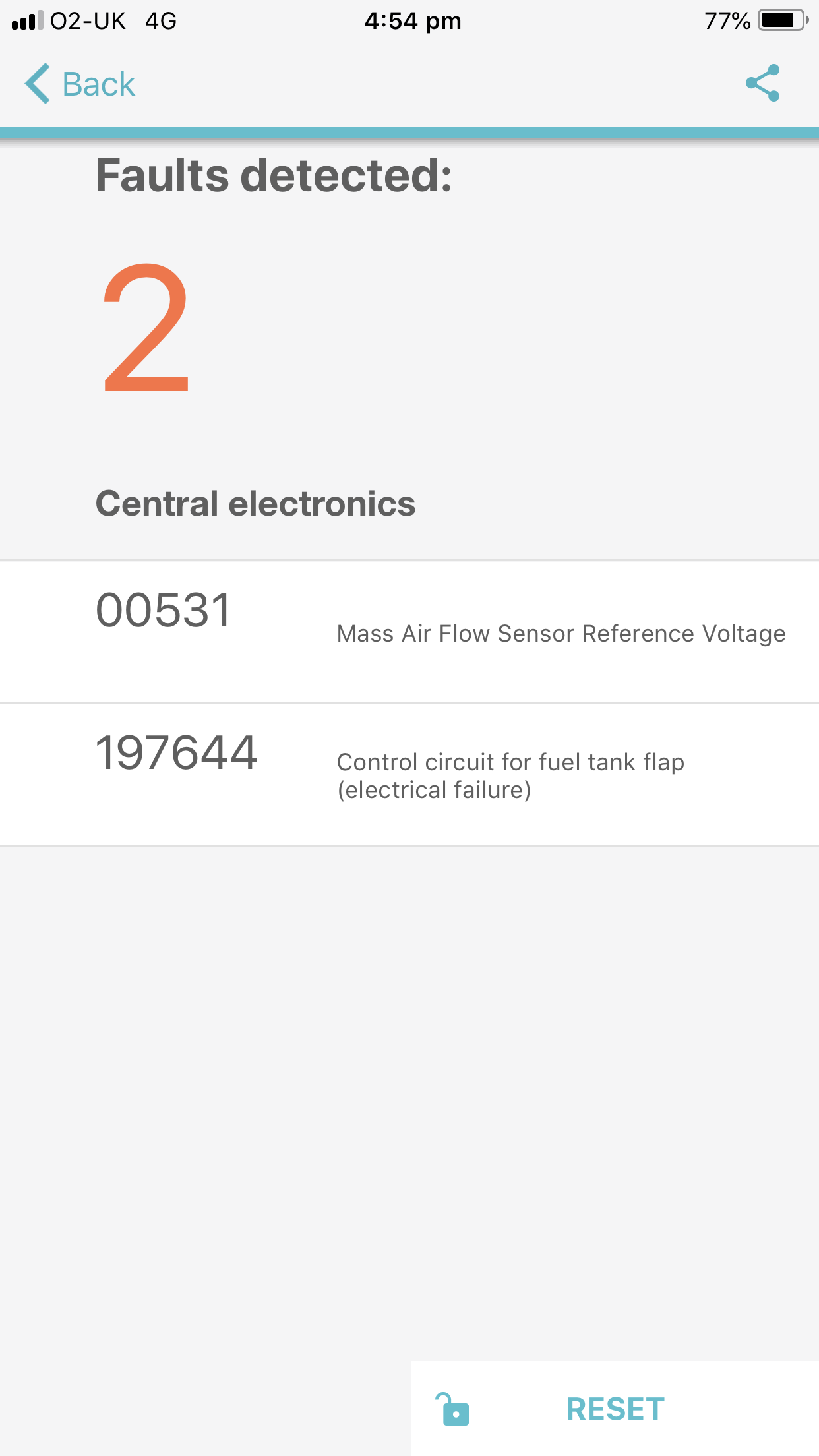

I’ve used odb carista app and these codes have come up? I’ve cleared them but they keep showing , are they anything to worry about ??
