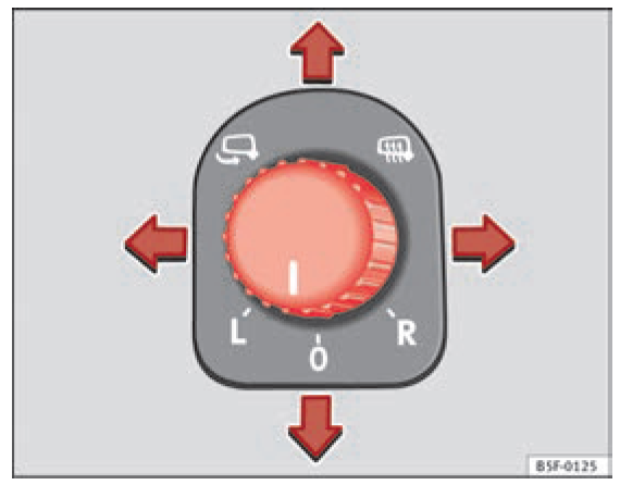

Can you open and close them if you hold the button for a long time.
Last question what options do you have on your mirror button like the one in the picture.

Same button as that. Mine will only unfold when ignition is turned on. Before coding they folded on a long press of remote. Now fold on first press.
