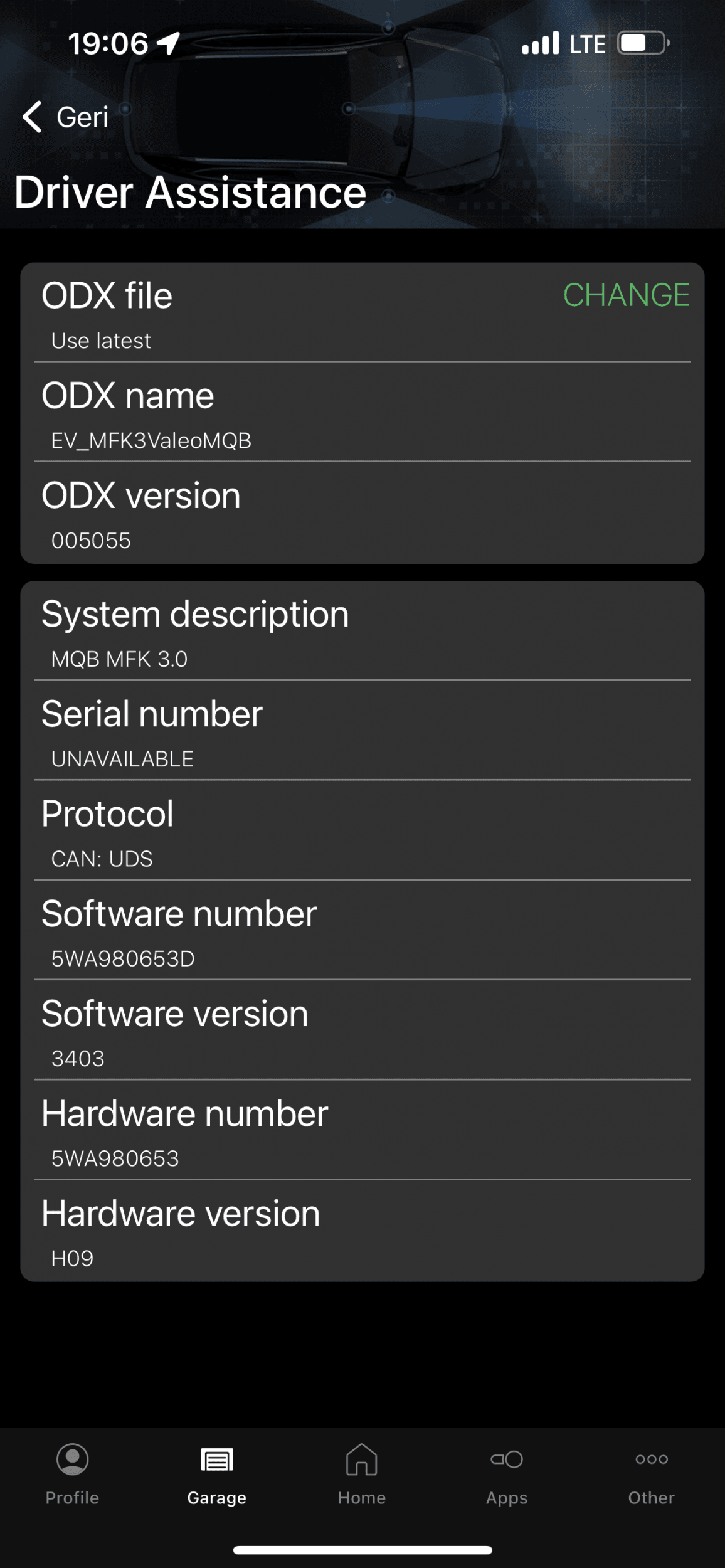

Hello I could not find the information about the traffic sign in the forums. I have a navigation system in my car. I have hardware features in the picture while I added. Is there anyone can help please?
A5-Driver Assistance long coding
00 03 08 88 11 6C C0 40 00 9E 40 80 10 20 00 20 00 A3 80 00 00 00 00 00 00 00 00 00 00 00 00 00
You can't post fit traffic sign recognition (TSR) in the platform of this car if that's the question. It's a signed license code even if you had the hardware so it would have to be enabled on ODIS I believe and you'd have to pay. A similar issue came up where people attempted to fit the Ateca power boot. Locked down by ODIS and dealers had no screens to do it since it was sold without the facility as defined by the VIN. Wait a few years and people may find ways of doing it. It's going to be a retrofitters job in the years to come or skilled hobbyists. The former use the latter's work and sell on, belief by hobbyists that do the coding.
