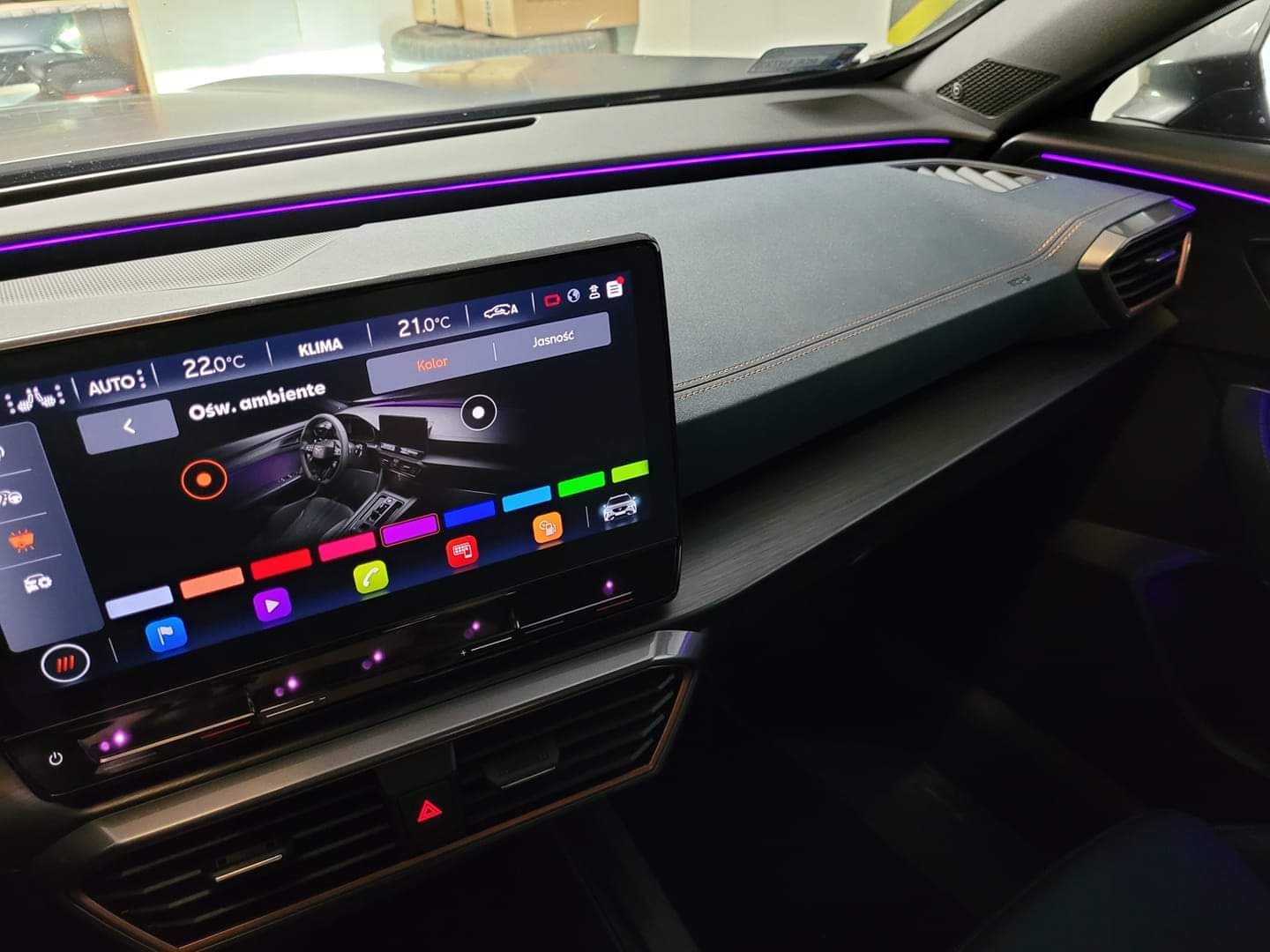

Hello Everyone,
Greetings from Poland. I would like to ask you about ambient lighting. Did you try to change color code? New versions of Formentor in Poland comes with diffrent ambient colors (including purple, picture attached). Of course dealers doesn't know if older cars will get color update. I have latest soft version (1896).
Do you know if it is possible to change color codes in Formentor, like in link below (2:47)?
